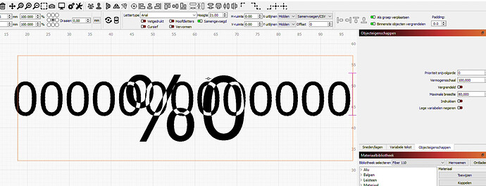

Max width text but height is not centered
Is there a way to make variable text with max length stay centered?
I have tried with different allignments or grouping the variable text with the rectangle, but nothing helps.

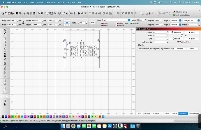

I have noticed that there is a button “Make permanent” with the variable text display.
And if you hit that, the text is actually center-center.
I will see if this works all the time and then hit reverse after the lasering and do the next one and again hit the button.

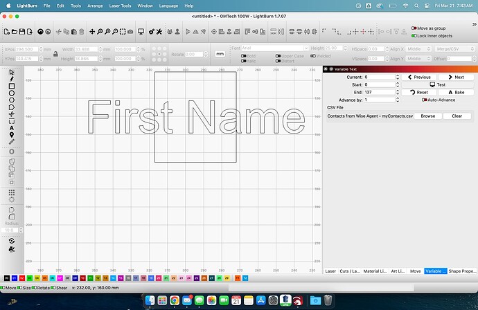

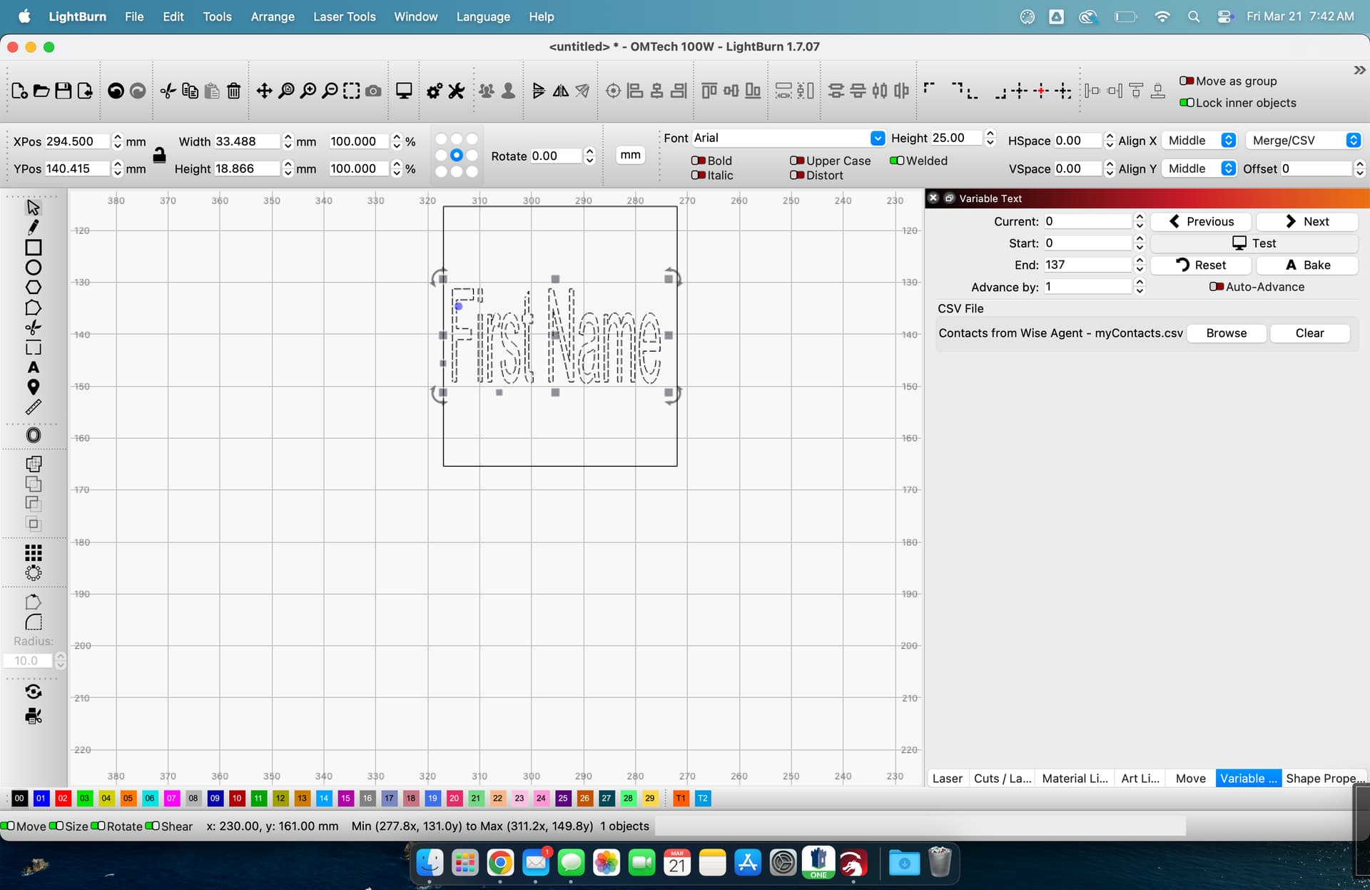

With the variable selected, go to shape properties and enter a value in max width. The change won’t be visible until you deselect the text.
Max width 40.
Max width untouched (0)

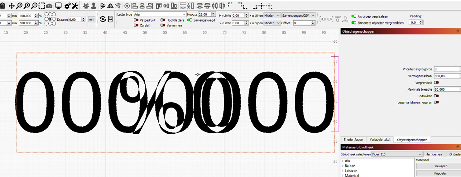

Hi Tim,
This is indeed so, but when you select that length - height ratio has to stay the same, as longer that the text becomes, the font gets smaller and horizontal center of the text changes.
As seen in my pictures.
