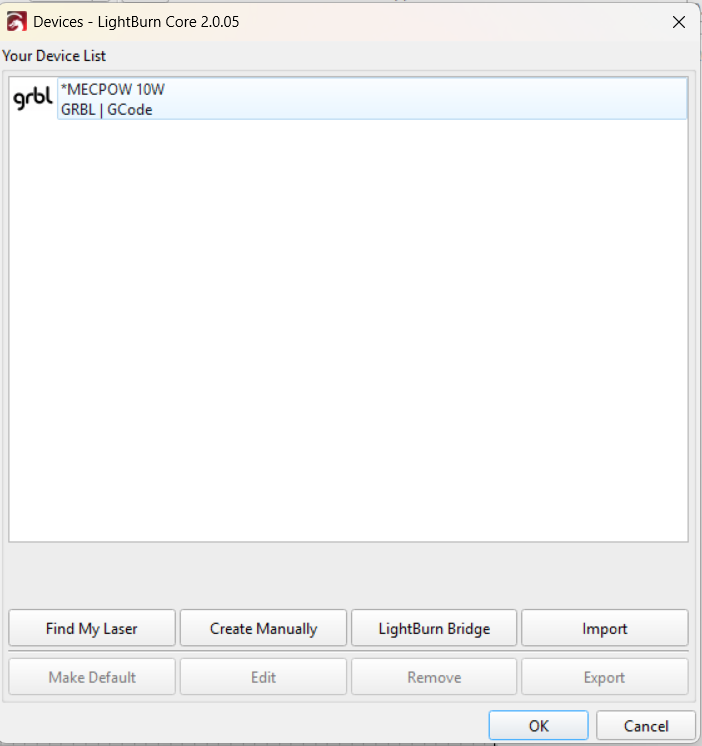

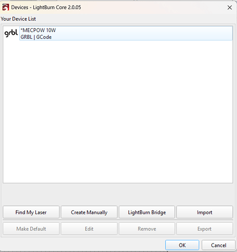

In LB go to the Laser window. You can see my Mecpow listed. I edited the name after creating.

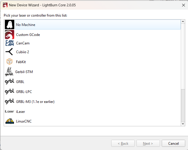

At the bottom see the button “Create Manually”? Click there.
Below is the screen that comes up. Find and click “grbl GRBL”.
When I did this, it worked. Once complete you can edit the name to your Mecpow.

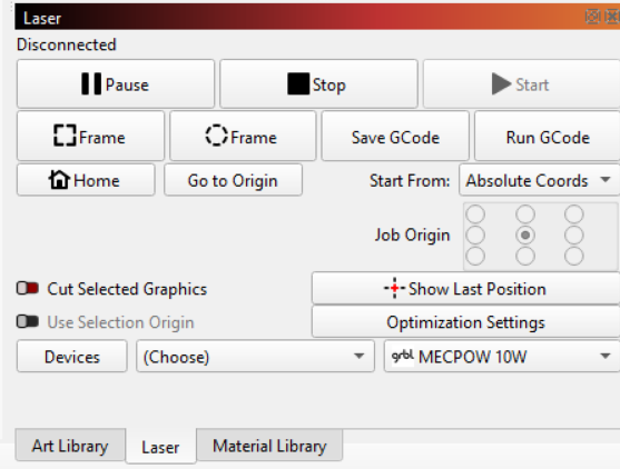

Hi Eric,
Thanks for your reply. Unfortunately, it doesn’t work when I do it the way you described. After that, nothing works. Even just specifying a COM port doesn’t work. With the “BSLFiber | Galvo” settings, it works right away, and no serial port specification is necessary.

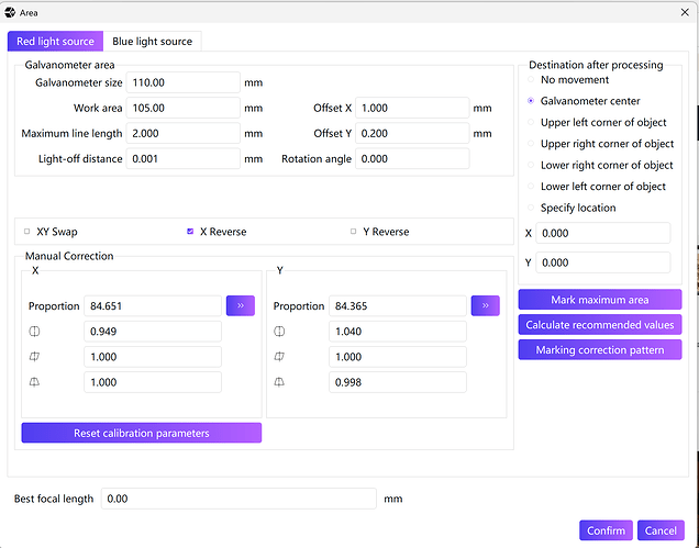

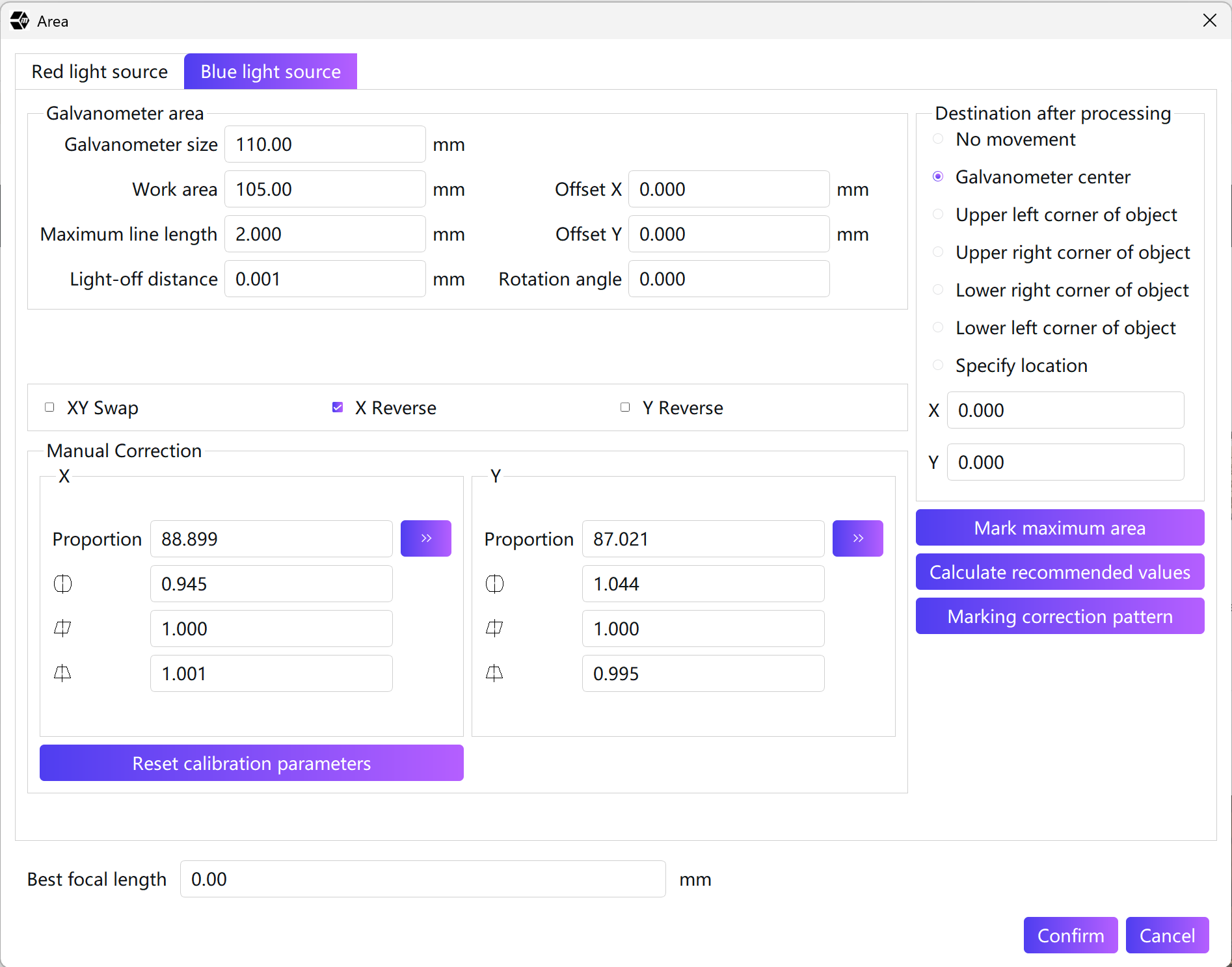

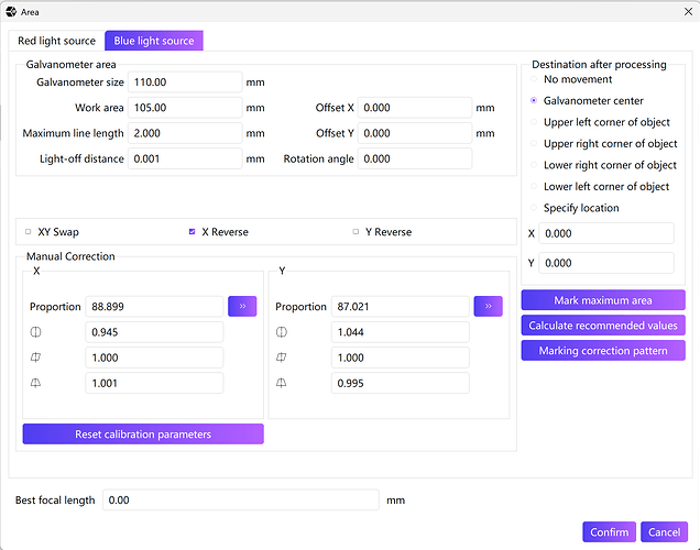

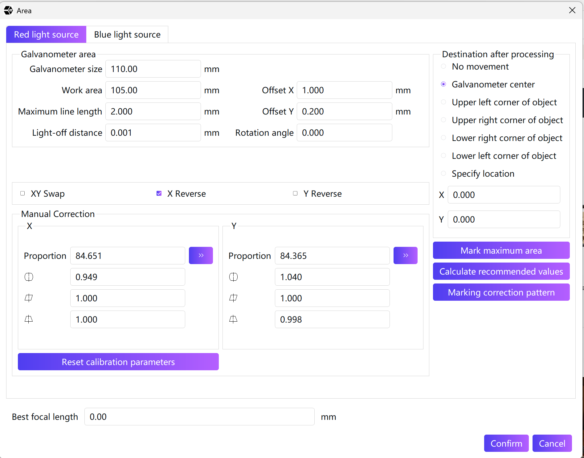

Hi Guys, I also have problem with this machine. I had Red Laser offset out of Blue of about 4mm. If I get it correctly blue laser is used for red and blue for engraving area outer box indication. Other problem I had with scalling also sligtly bigger of about 2.7mm than 10x10cm box. I wanted to recalibrate it and somehow clicking Restore Factory defaults it looks like it wiped configuration. Right now machine is not configured and does not want to engrave. Could anyone of you share screnshoots of mecpow X1 tabs like port, laser, indicator, others? I can share with you password to access those tabs as admin. I unable to get those screenshoots from manufacturer. Please write me directly szymon19.elektronik@onet.eu
Kindly Regards
A forum is meant for collaborative discussion, so I’ll only respond here.
In the simplest case, just reinstall the software and everything will be as good as new.
The password isn’t a secret either: mecpow123456
Otherwise, here are my settings.
