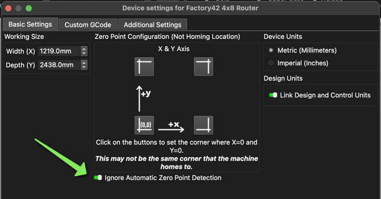

@tomm77 It is very likely your “Zero Point Configuration” is not correctly set. What CNC machine are you working with?
If you go to Device Settings (wrench/screwdriver icon) → Basic Settings tab you can see the zero point configuration. Zero point origin is not the same as the home location on all CNC machines, depending on how they are configured.
(If you have limit switches and can home your machine) We have a new feature that might help with this, the “Ignore Automatic Zero Point Detection” toggle in that same screen. If you toggle that off, click okay, and then home the machine, it can detect the zero point on most direct control machine we support. After homing, go back into the Device Settings → Basic Settings tab and see if the zero point changed.
If you do not have limit switches or just want to ignore this automatic functionality, you can toggle the “Ignore Automatic Zero Point Detection” on and set the Zero Point manually. If you have this Zero Point Configuration set wrong you will be able to jog but Goto will not work properly and likely ($J) Continuous jog will not operate correctly either.

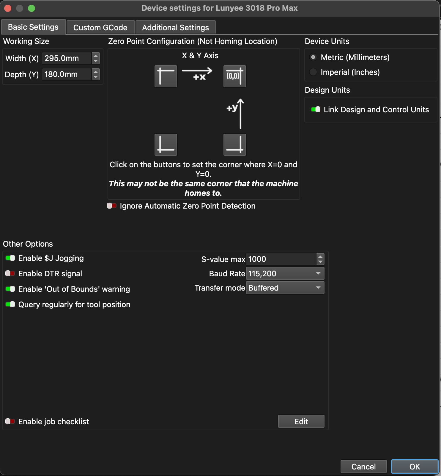

If you can share a screenshot of the Device Settings → Basic Settings Page. Also what corner does your machine home to?

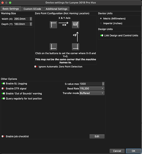

Here is a screenshot of a Lunyee 3018 Pro Max Device Settings → Basic Settings page. Not sure if it will be the same, it all depends on the firmware configuration but my best guess is that it would be either a back right zero point like the 3018 or a front left zero point.
Maybe to add here: after upgrading to the last RC, MM selected the incorrect origin (back right instead of front-left). I changed it in device settings, and MM complained, “I got this from the machine information; do you really want to change it?” (I don’t remember the exact phrase). It seems this is not working correctly, seems it also affects others.
I checked mine today and it had the same problem. Auto detect chose the back right for zero. It should be the front left on my LowRider4 running Fluidnc.
