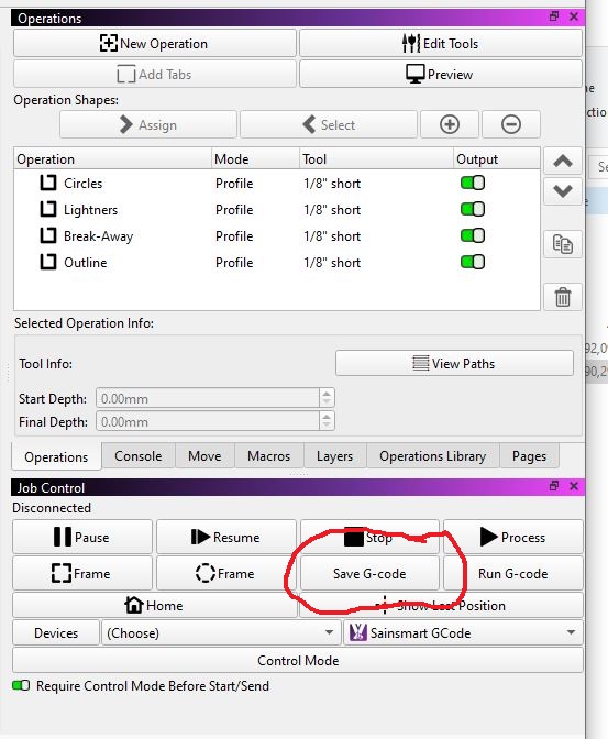

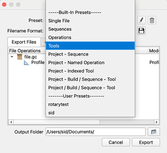

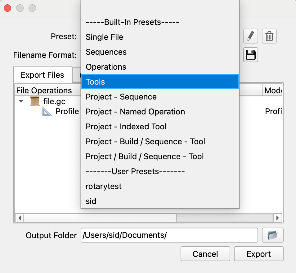

Thanks Mike for what sounds like a feasible workaround, but excuse my ignorance, I am unfamiliar with how to generate it as a txt file. Which, if any, of these should I choose…?

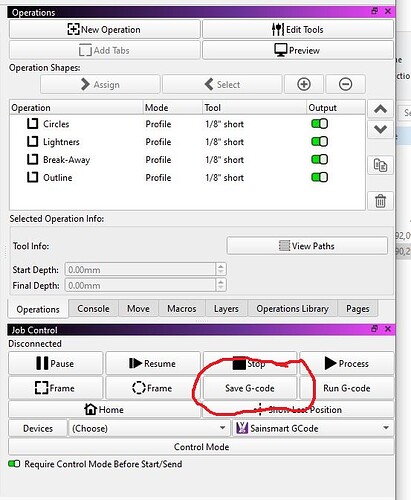

**Post date:** [September 17, 2026, 7:52pm UTC](https://forum.lightburnsoftware.com/t/millmage-4th-axis-with-cubiko/192433/12 "2026-09-17T19:52:15Z")
</div>
![Save GCode](https://forum.lightburnsoftware.com/uploads/default/original/3X/6/9/69503d7f6fff6e7262b1218a20a6db6ffb20e304.jpeg)
