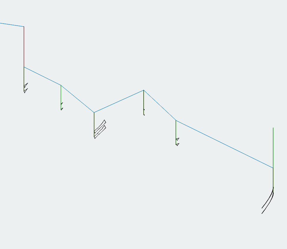

I bought a generic Chinese 3018 CNC machne a while back and tried to use Millmage and gave up. When the new version 0.9 came out I thought I’d try it again, but still no luck. I make a simple text layer, convert it to a path, set the origin and click Frame, which shows the correct location on the piece. But when I click Process, it draws garbage on the screen, and if I then click Start it drillls a few random holes, which looks a bit like what it drew on the screen. All the help says it is a communications problem, but I don’t see why it draws garbage before I tell it to start carving. I have used LightBurn on a Creality Falcon Pro for 2 years and have used 3D printers for years and it is all easy and intuitive. This makes absolutely no sense after hours of struggling.

This is what it said it was going to make:

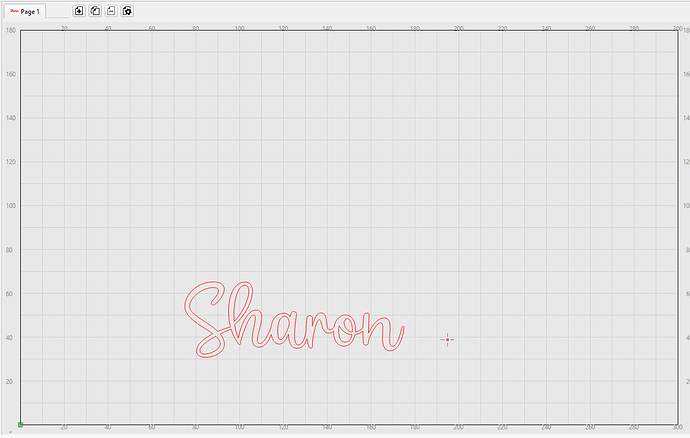

This is the design:

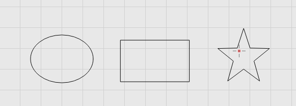

I actually have made progress: I gave up on text and drew some shapes. That worked. Is there an issue with text? I saw that I had to change it to a path, so I did do that. Maybe I should have left it?

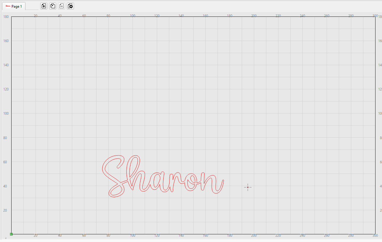

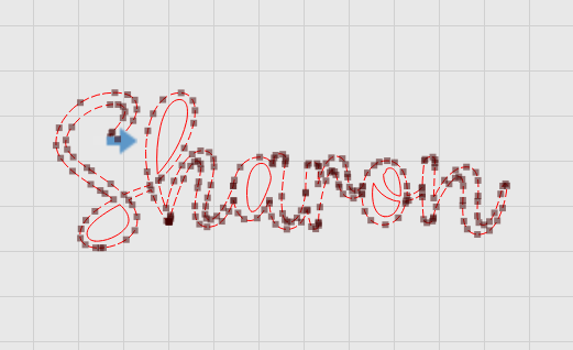

Test converted to path:
The output is nothing like this.
This worked.

What is the tool you’re using to run the profile? Will it fit inside the shape without making a collision?
I suspect that the tool you have selected is too large for the geometry.

I’m guessing the issue was the fancy font: Ariel works, Beautiful Dreams does not.
