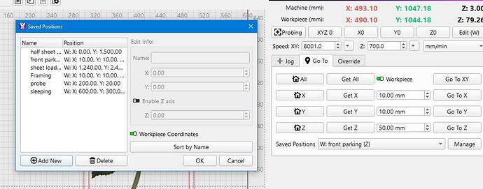

i have a lowrider 4 and have been running MM on it for over a year via WIFI with no issues
if you need hand to set it up let me know
<div class="post-metadata">
**Author:** ![wanderingtruckie](https://forum.lightburnsoftware.com/user_avatar/forum.lightburnsoftware.com/wanderingtruckie/32/107530_2.png) [@wanderingtruckie](https://forum.lightburnsoftware.com/u/wanderingtruckie)\
**Post date:** [August 3, 2026, 5:23am UTC](https://forum.lightburnsoftware.com/t/millmage-files-wont-run/191612/8 "2026-08-03T05:23:01Z")
</div>
> [@MikeyH](#):
> 1. Make 1-button Macros to jog the spindle out of the waw
dont need to just set it up in here
 ![sav1](https://forum.lightburnsoftware.com/uploads/default/original/3X/a/6/a6cd945266bcdb23b3034433d1f9f981c7cad6f6.jpeg)

Haha! My CNC table is so small that there is no place to save a position. Personally, I have two relevant positions, [1] **Home** , and [2] **Out Of The Way**. 🤣
