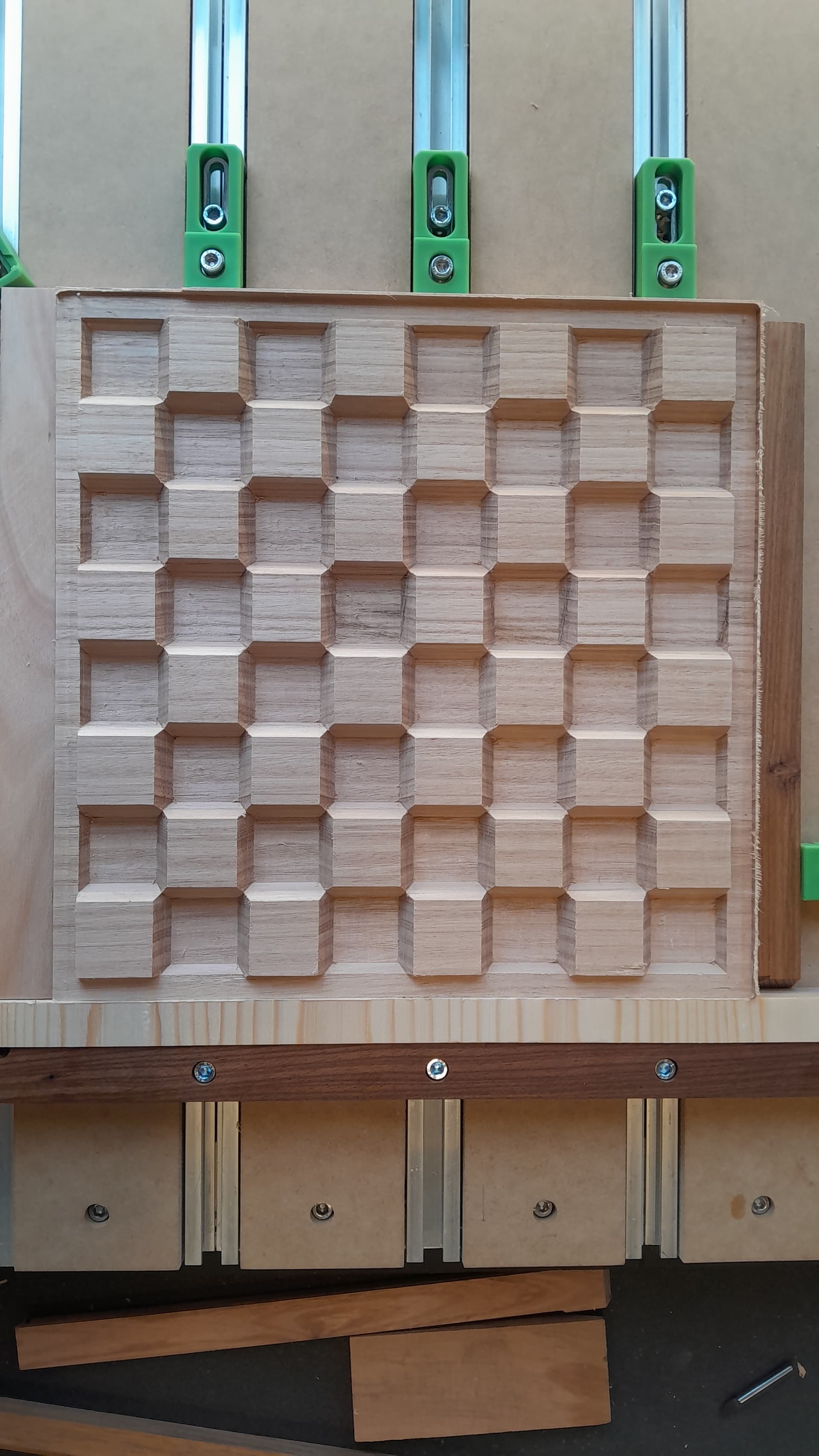

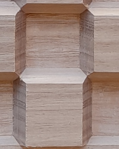

Hi Mike, Carbide create is able to produce perfectly sharp corners in a female inlay with a 60 deg V bit using the Vcarve toolpath ( similar to the female inlay tool in Millmage). I have done dozens of them. The corners are created by the toolpath starting at the edge of the corner at zero depth and then moving away from the corner into the pocket and increasing the depth simultaneously. The corners are done as the last part of the toolpath. This is all done by the carbide create software. Below is a zoomed in pocket of a chessboard I made.

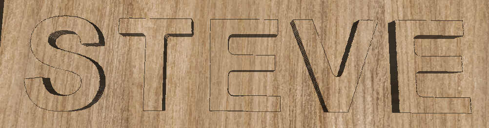

In an attempt to clear up any confusion, the current implementation of the inlay tools is to allow you to produce male and female versions of shapes that fit correctly within each other.
An an example, if I have this text:
Producing a pocket from that shape will result in the outer corners rounded like this, because the end-mill has a radius and can’t get all the way into the corners:

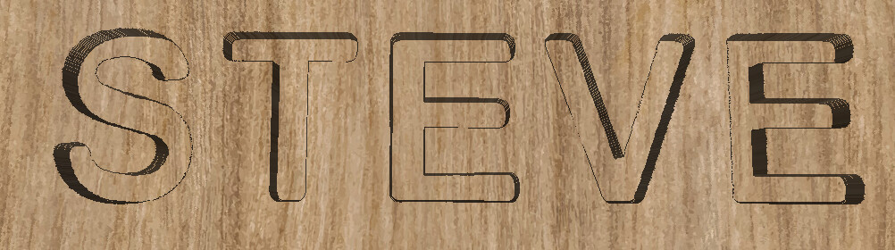

Conversely, cutting out the shape results in the inner corners rounded the same way:
Trying to put one of those shapes into the other obviously won’t work. Look at the inner tip of the V, specifically - it’s very sharp in the pocket version, and very round in the cut-out version.

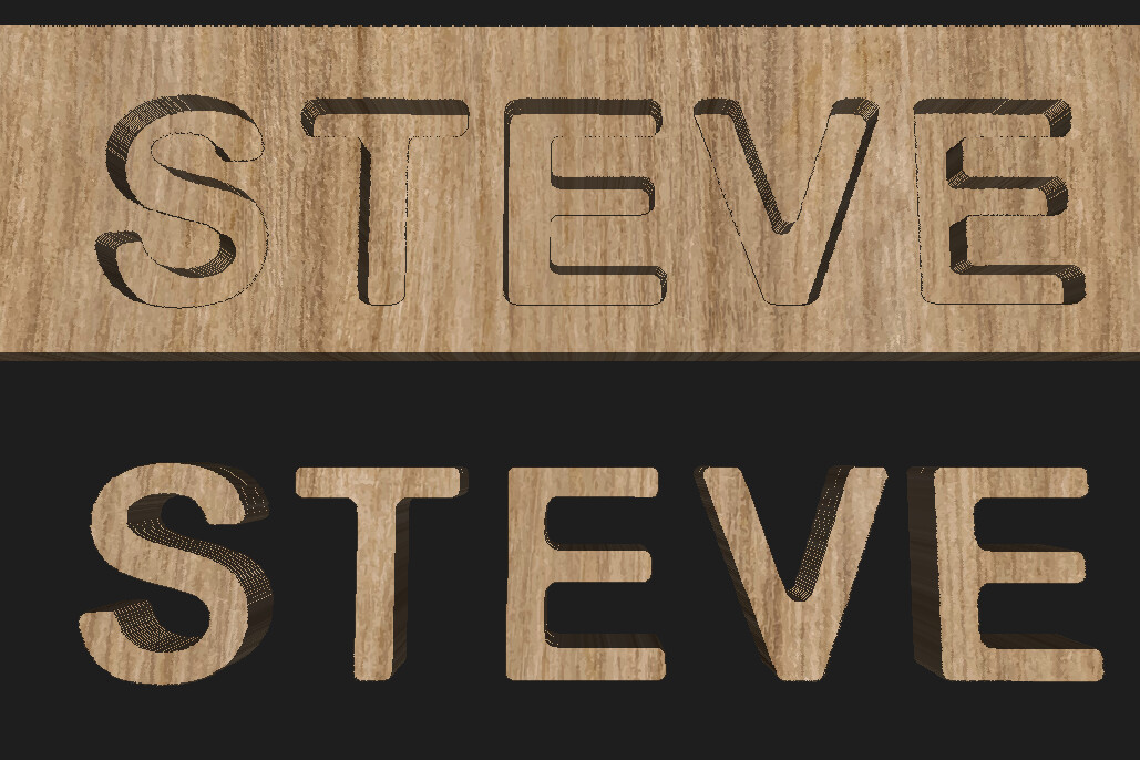

Compare that to these shapes, done using the Inlay operations, but using the exact same source shapes:
All the rounding matches, so all you need to do cut out the bottom one and insert it into the top one, and everything will match up. It’s not a V-Carve inlay, and it was never claimed to be. :slight_smile:
