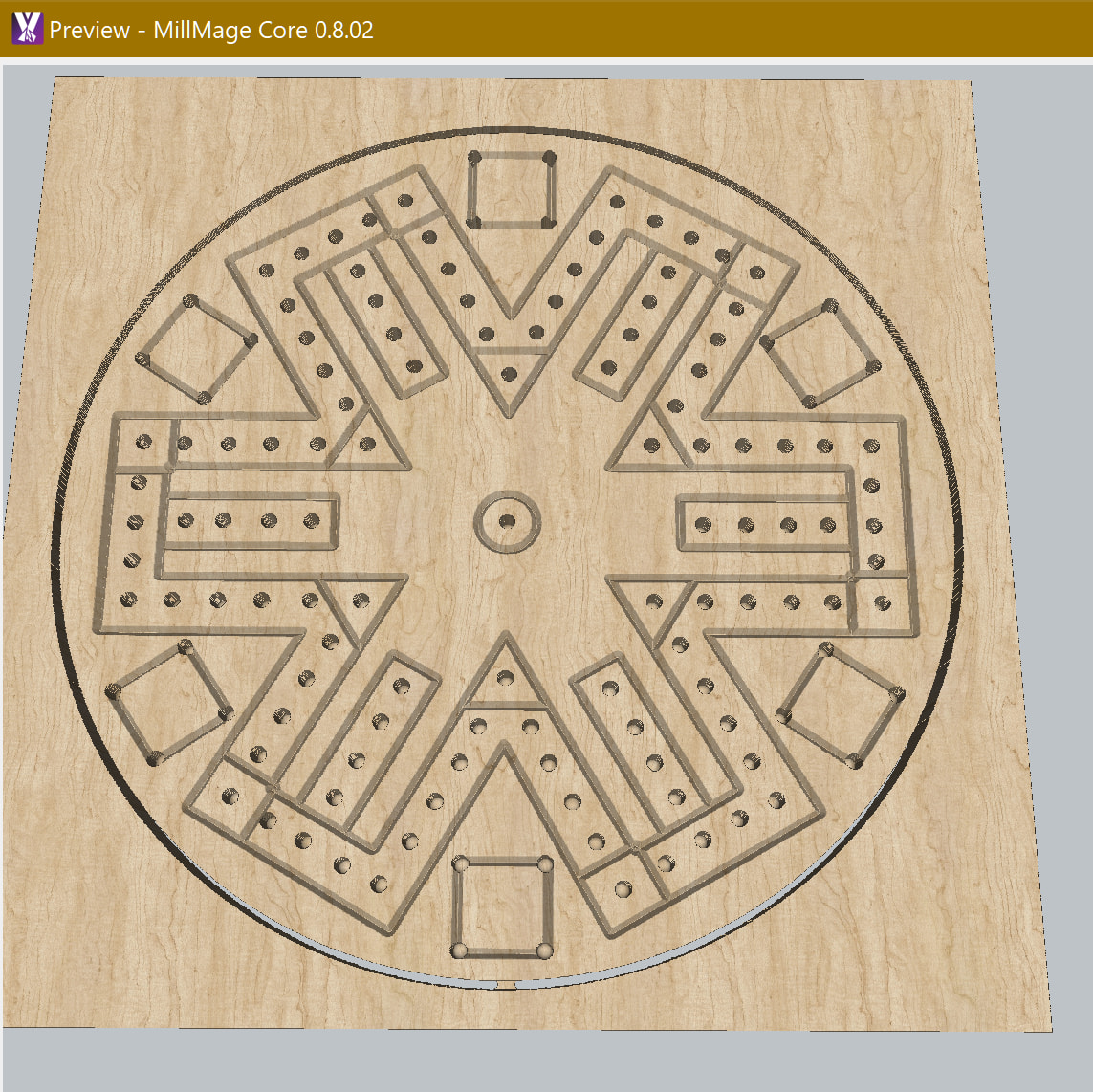

Trying to build a game on plywood. As I connect lines to build the game and look at the preview of the design a warning comes up and states Operation #4 (Chamfer Profile) → 12.7 mm V-Bit 60.0°
contains one or more open shapes. When I highlight the design, it shows all lines connected and only cuts the outer line and the inner cir
Fast Track.mage (98.7 KB)
cle.
Not sure what to do anymore and if I make complete shapes it over cuts the lines

Your file looks fine without warnings under 8.0.02.
Well that looks good. I’m still getting the open shape message. Working on a complete redraw not sure what to do in the small square corners, rectangles, and triangles, I’m at a loss
Just download 8.0.02.
Here is a cleaner version of what I am looking for on this game I’m building. When I preview it, it still only cuts out the outer : https://forum.lightburnsoftware.com/uploads/short-url/qtt4gdlVSLtCm8rlQXNRVrVOyfI.mage
copied to clipboard lines and leaves the corners, rectangles, and triangles uncut

Yes, all lines are on the same layer. When I try to connect the line nodes, they don’t connect to the other line like in Lightburn. I even tried to copy the game over to Lightburn and lined up the nodes, but it didn’t help either. When I moved it back to Millmage, it still says there are open shapes on that layer. If I complete the triangles, rectangles, and the small squares in the corners, they will cut, but they are wider than the original lines. We call the game fast track

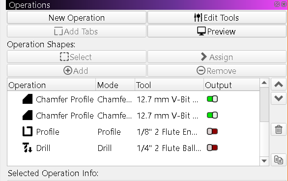

You have to enable Output for the last 2 OPs.
