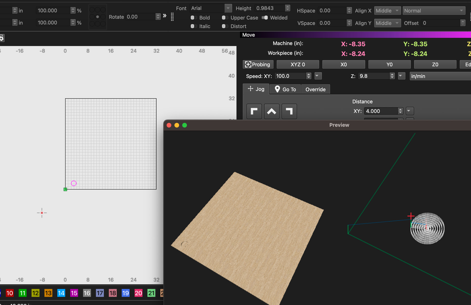

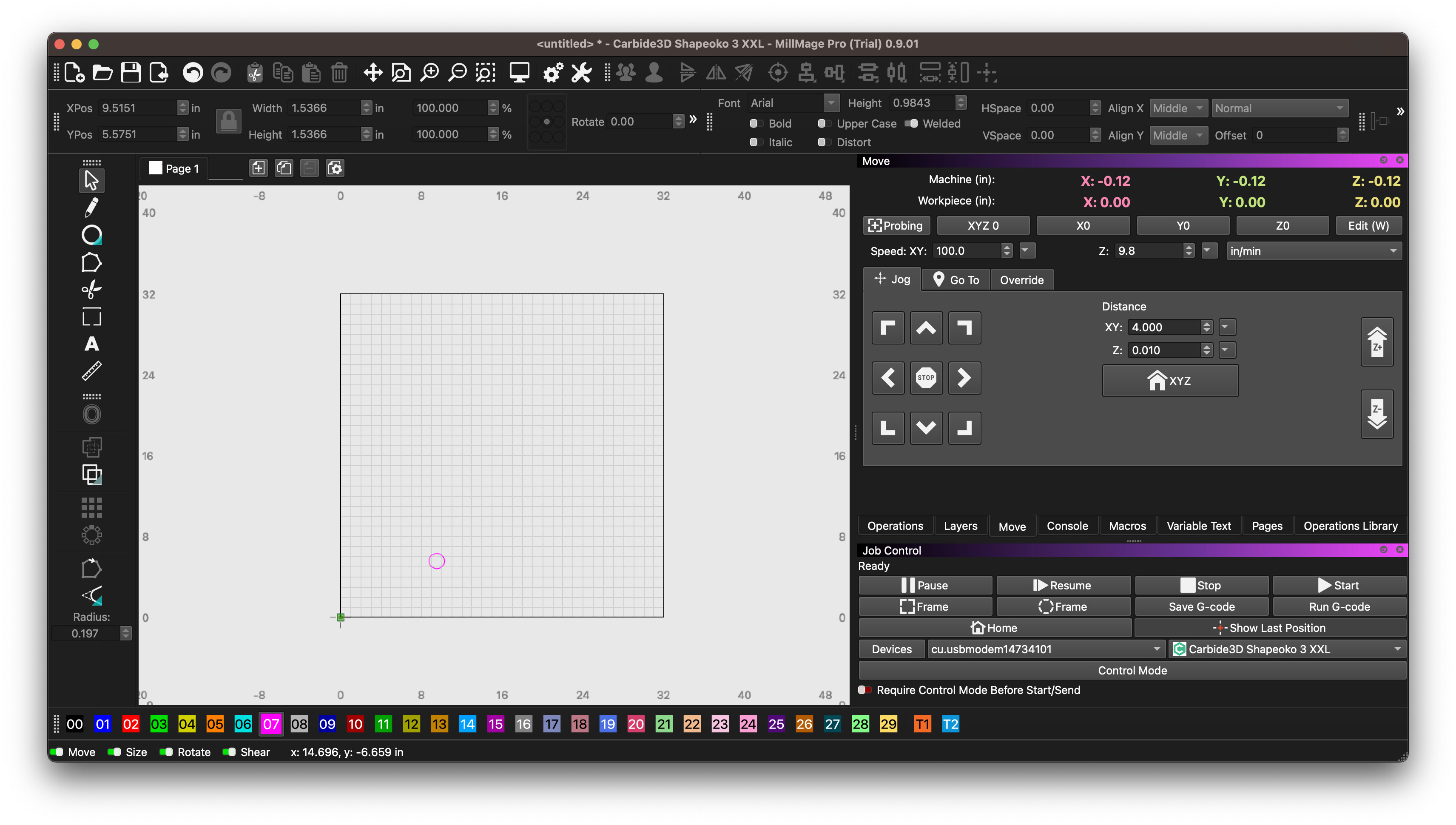

Testing trial version, setup CNC 835mm X and Y travel. used Shapeoko 4 I can set zero for workpiece and do a frame of the object and it does as expected. When I go to run the project the CNC moves all the way to the front and crashes. I have moved the zero set point from right rear. left rear (that did not allow the movement correctly on workpiece when jogging) to front left. (that allowed correct jogging to any location on workpiece. but crashes if I run the job. Any ideas what I need to change. Thank you. I emailed support but no response so far.

I can see where the issue is, just not sure how to correct.
Green dot is home position for the machine. Cursor is where the machine is currently at but its at the wrong corner, Left front, where it needs to be at right rear for shapeoko.
If you look at the Preview (Alt+P) do you see the problematic movement?
Colin, Workspace I set to see where things are. 32"x32" Front left corner should be edge of material for this test. If I jogged diagonal down left the router is actually off the possible table.
If I were to try and frame it would crash the router in the back right corner. Back Right corner is home for the router and front left corner should be edge of workpiece. Not sure what I have wrong.
In the picture I jogged down left aprox 8"

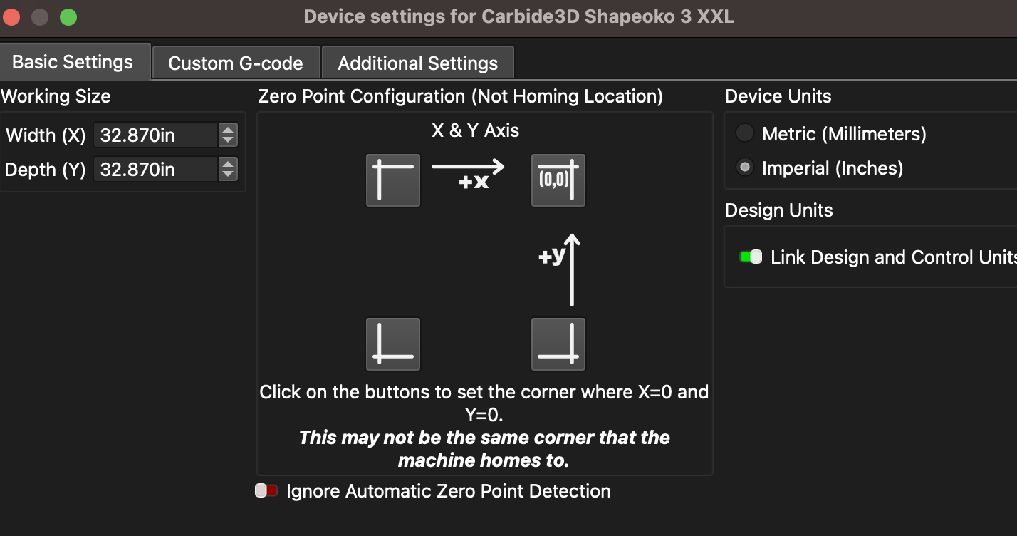

Bases on your image, it is up and right 8". In other words, X8 and Y8., both positive moves.
If your spindle is at that same corner as the green square when you Home the machine, then try setting the 0,0 (second image) to the bottom left square. If that is not a fix, then it is easy to switch it back.

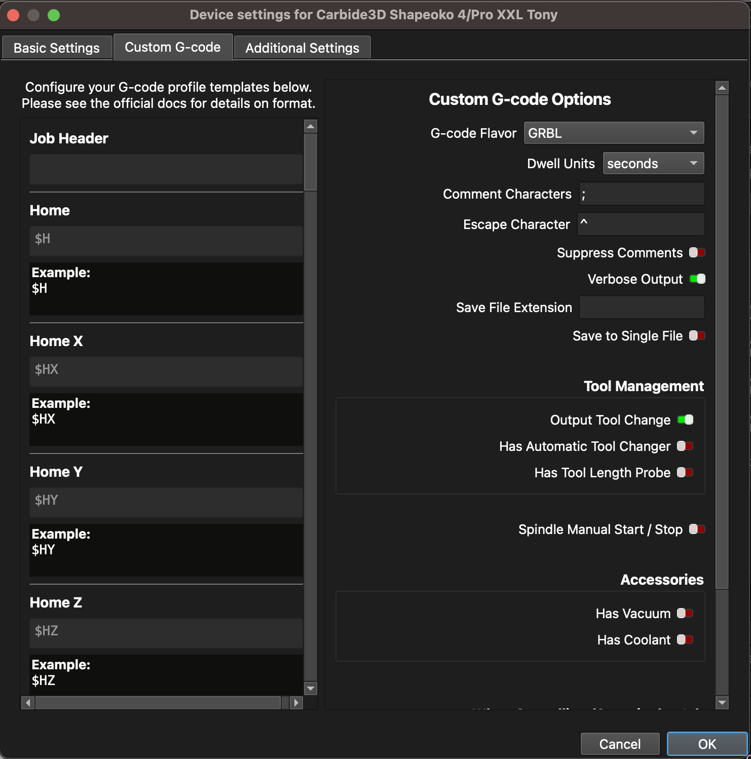

OK, I am getting somewhere. I unchecked the ā€œHas tool Length Probeā€ and that seems to have stopped the crashing. Ran a test run without the Z depth and router turned off. baby steps. but it was a success. Tomorrow I will run a real test but looking much better now. Thank you everyone for your help and therapy.
Please let us know how it goes - ā€˜Has tool length probe’ being unchecked is interesting, I’d be curious to see what you have set in Custom GCode for the tool length probe.
OK ran a VCarve small project and all went well. Just turning off the tool Length solved my issue.
I did, reset the Home position as well. So in short it kept wanting to go to the tool length probe location even though I do not have one. Now I want one! Thanks again for all the help.
