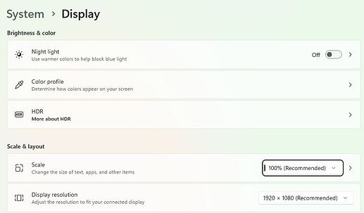

Interesting - are the two displays the same resolution?
Apparently not. Using the screen dimensions and the pixel count, the monitor is about 110 DPI and the laptop is 142 DPI. That is actually backwards from what I expected.
Both are set at the highest resolution offered.
Check the Display Scale on your laptop display.
If it’s set above 100% you run into app issues like you described.
Hop that helps,
Andy
