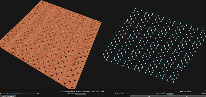

And screen shots. First one is how it should look, and the second one is the “Reversed” one that was saved on my Synology NAS.
Welp, did some more testing and now it’s happening to local files. I’ve only imported Illustrator files (.ai) and have not tried any other imports or creating shapes in MillMage. I’ll be testing that next.

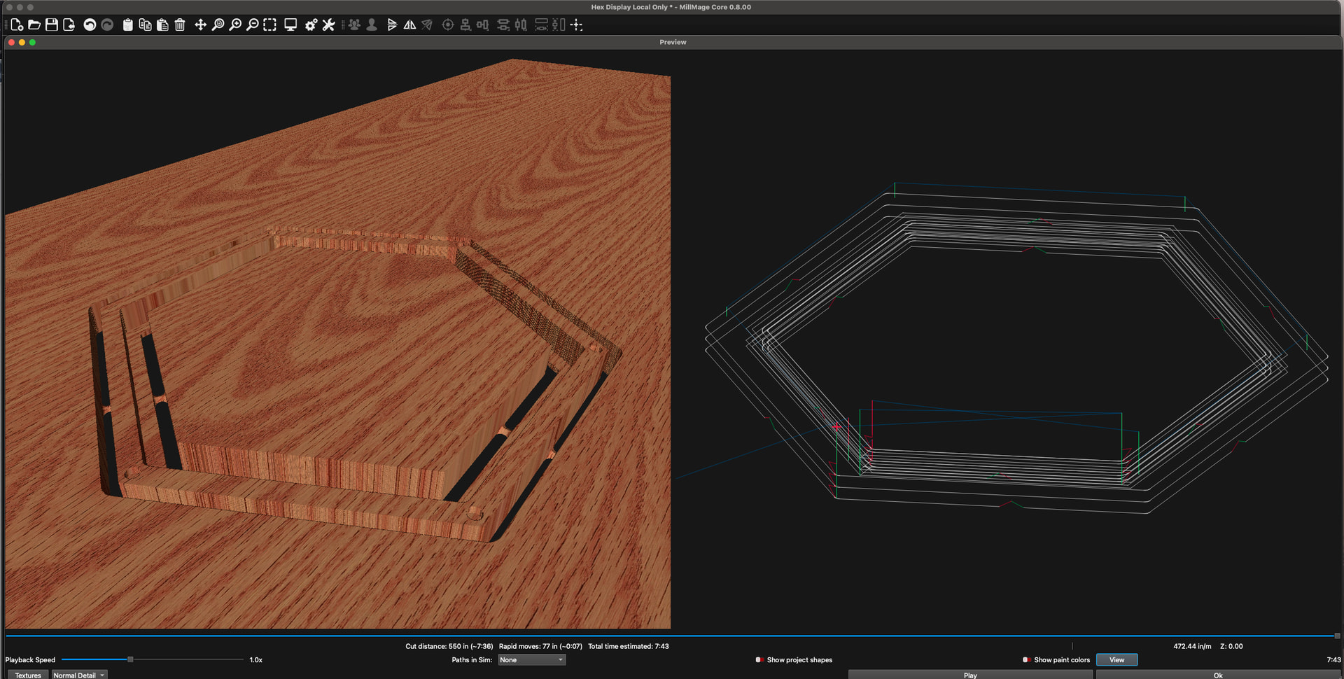

Yep, happening to straight up local files as well. Created a fresh brand new project, imported my SVG file, created all my operations and got it looking like it should. Saved locally to my desktop, closed, then re-opened immediately and the issue is happening. Tried a new vector file as well with this test. Only worked on this project, didn’t open any others in between.

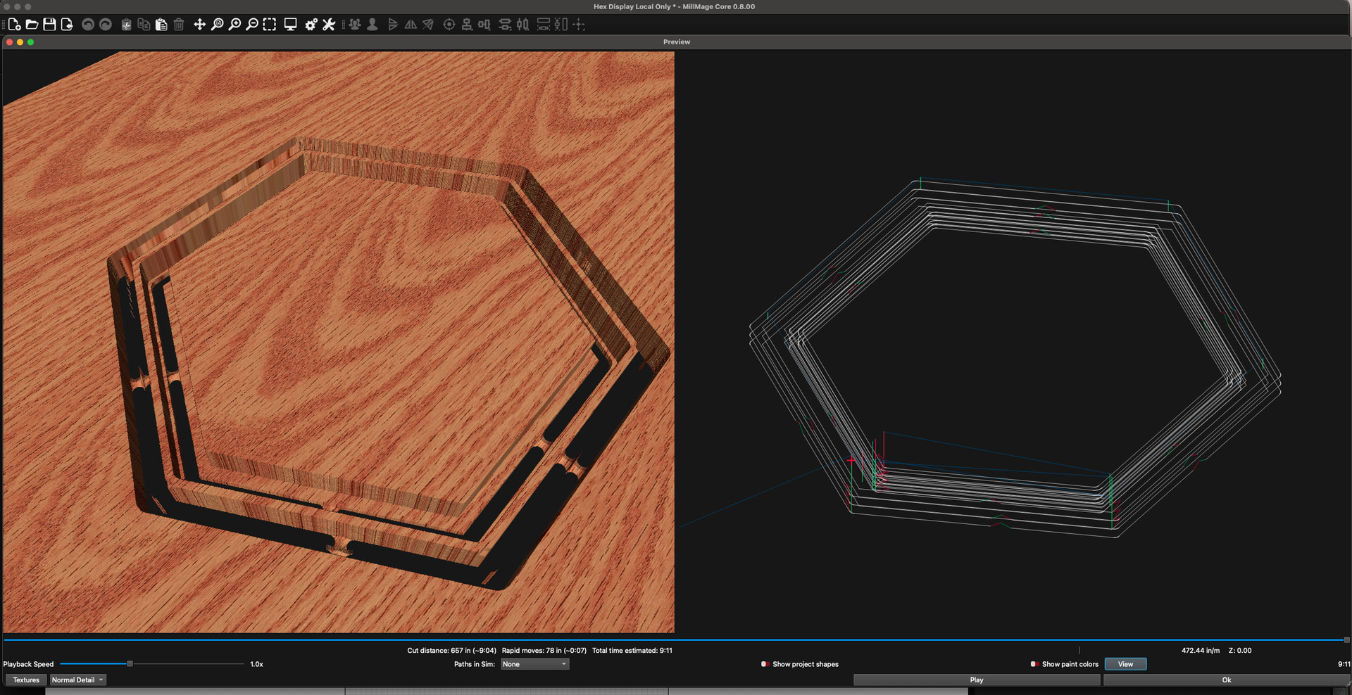

What it should look like. This was after I set everything up.
This is what it’s looking like after I re-open the file.

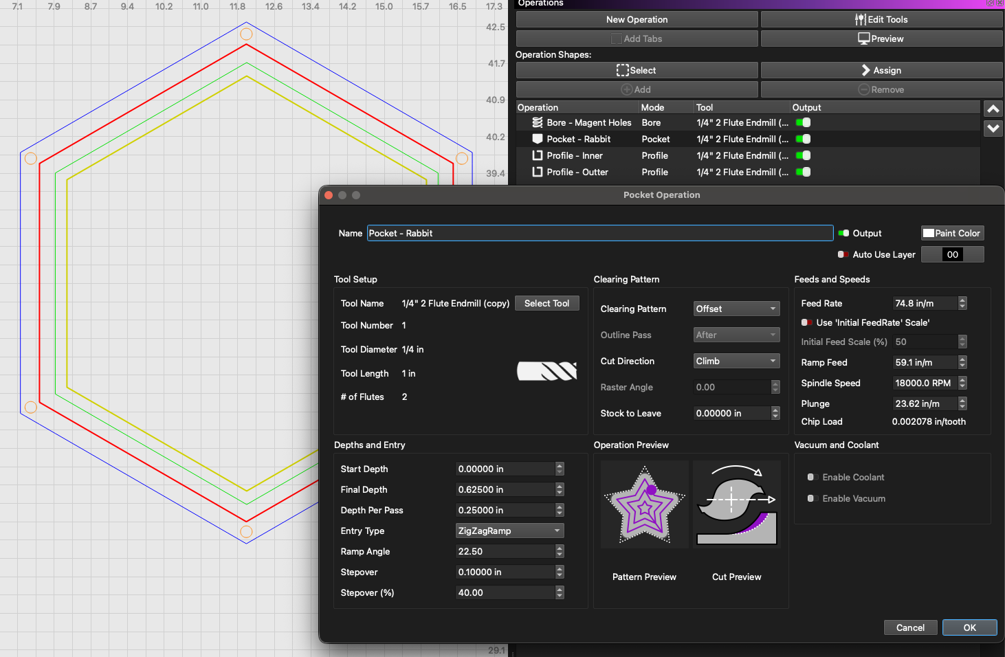

I think I may have found the issue, and should have mentioned this in the original post as well.
I was using “Auto Use Layer” for nearly all my operations, or the ones that made sense to. I re-did all the operations, but selected the paths I wanted for them instead.
So after doing that, it seems to be working as expected. So something with Auto Use Layer is messing things up.

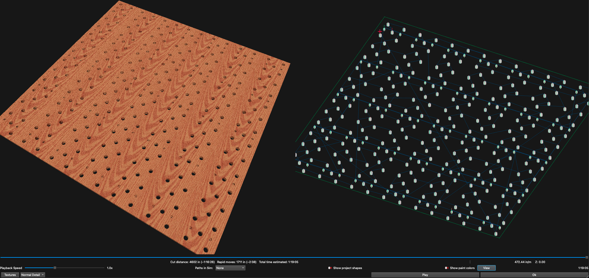

I’m not sure why, but it looks like the group of brown rectangles is included in every operation. Digging in to see what’s going on.
Edit: Found and fixed. This will be in a patch update relatively soon. Basically, if you didn’t have any shapes manually assigned in an operation, it would end up automatically assigning the first shape in your file to it. In your case, that first shape was the group object containing the brown rectangles.

If you have at least one shape manually assigned to every op, you can safely use Auto-Use Layer for the rest. The bug is that operations without any manually assigned shapes would self-assign the first shape in the file when loading.

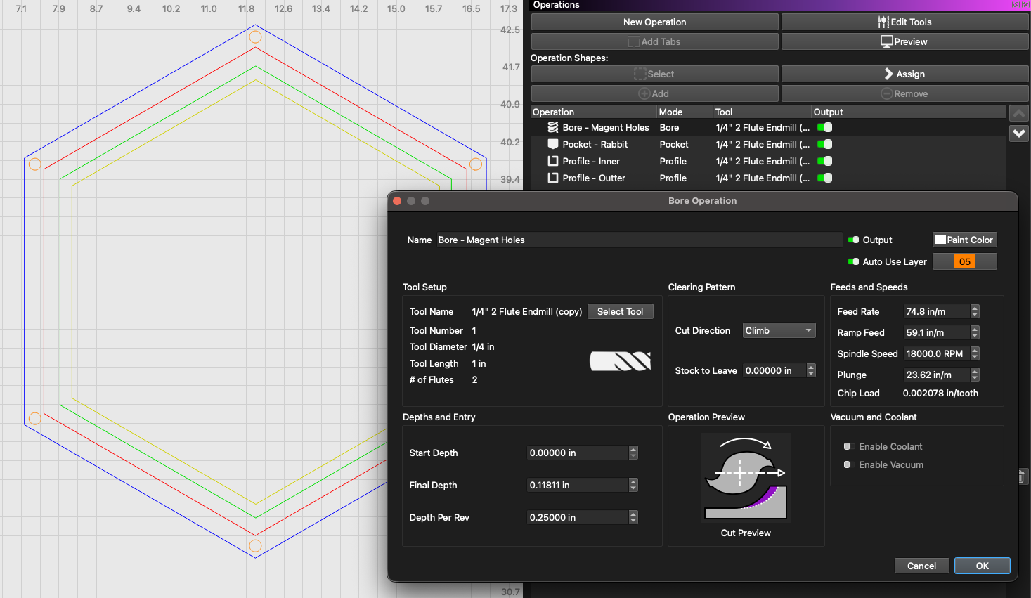

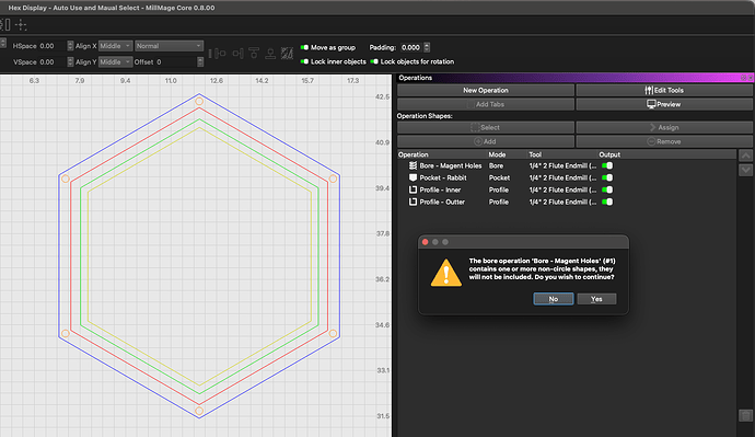

I start with a brand new fresh project.
Import an SVG file that has 6 circles (orange), and 4 hex lines/paths
I create a bore operation for the holes, and use “Auto Use Layer” for the 05 orange layers, which are the 6 holes.
I then manually select the red and yellow lines/paths and create a pocket operation.

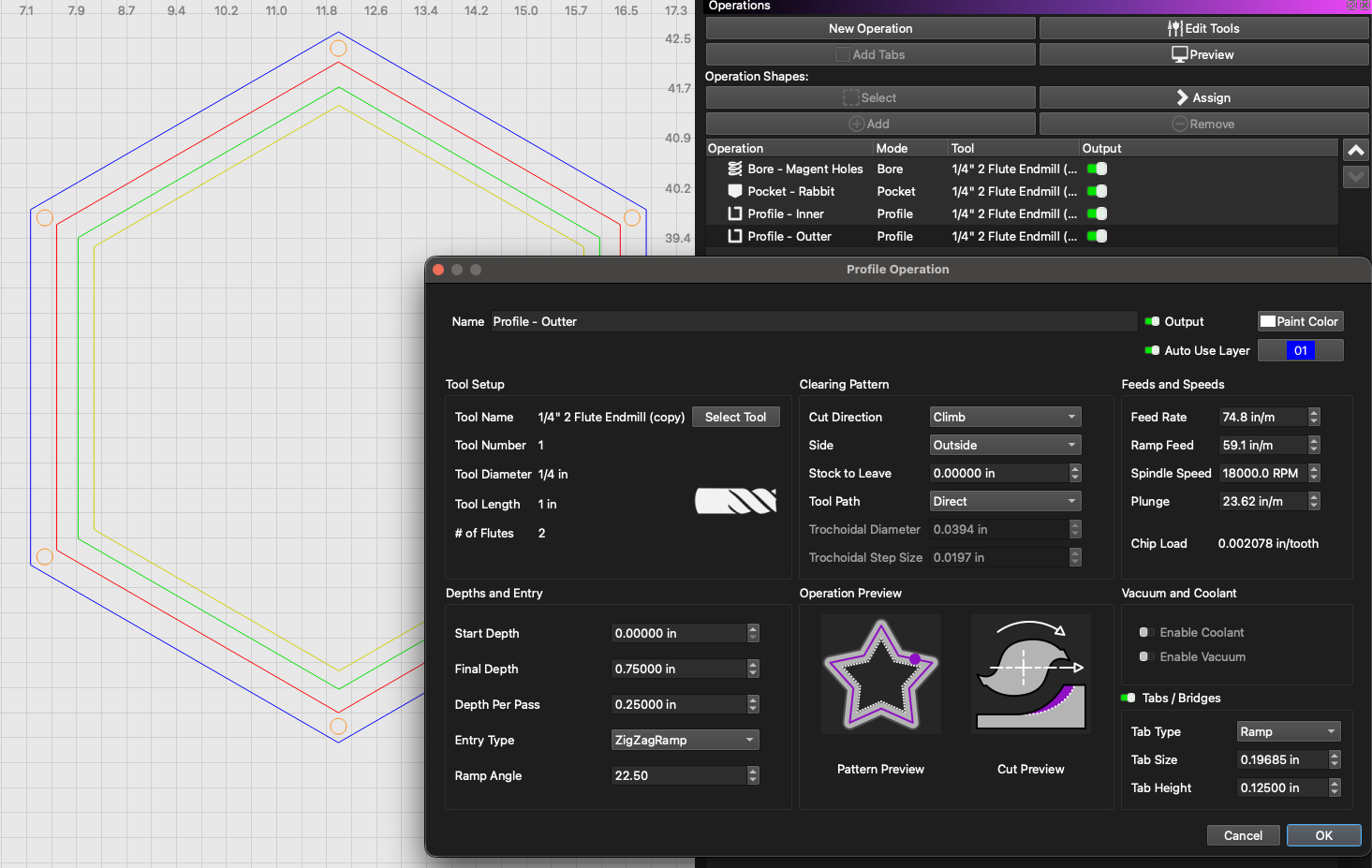

I then create a profile operation for an cut on the inside, and used “Auto Use Layer” for the 03 Green layer, which is a hex line/shape.
Then last I create a profile operation for a cut on the outside, and used “Auto Use Layer” for the 01 Blue layer, which is a hex line/shape.
When I preview, everything looks as it should.
I save locally to my computer.
Quit the program completely.

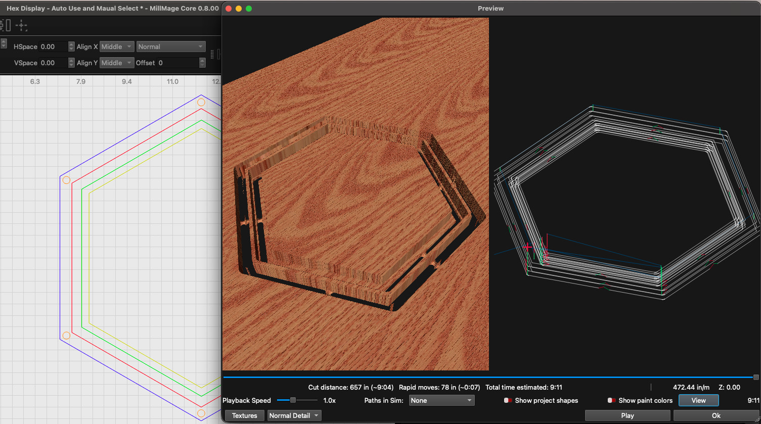

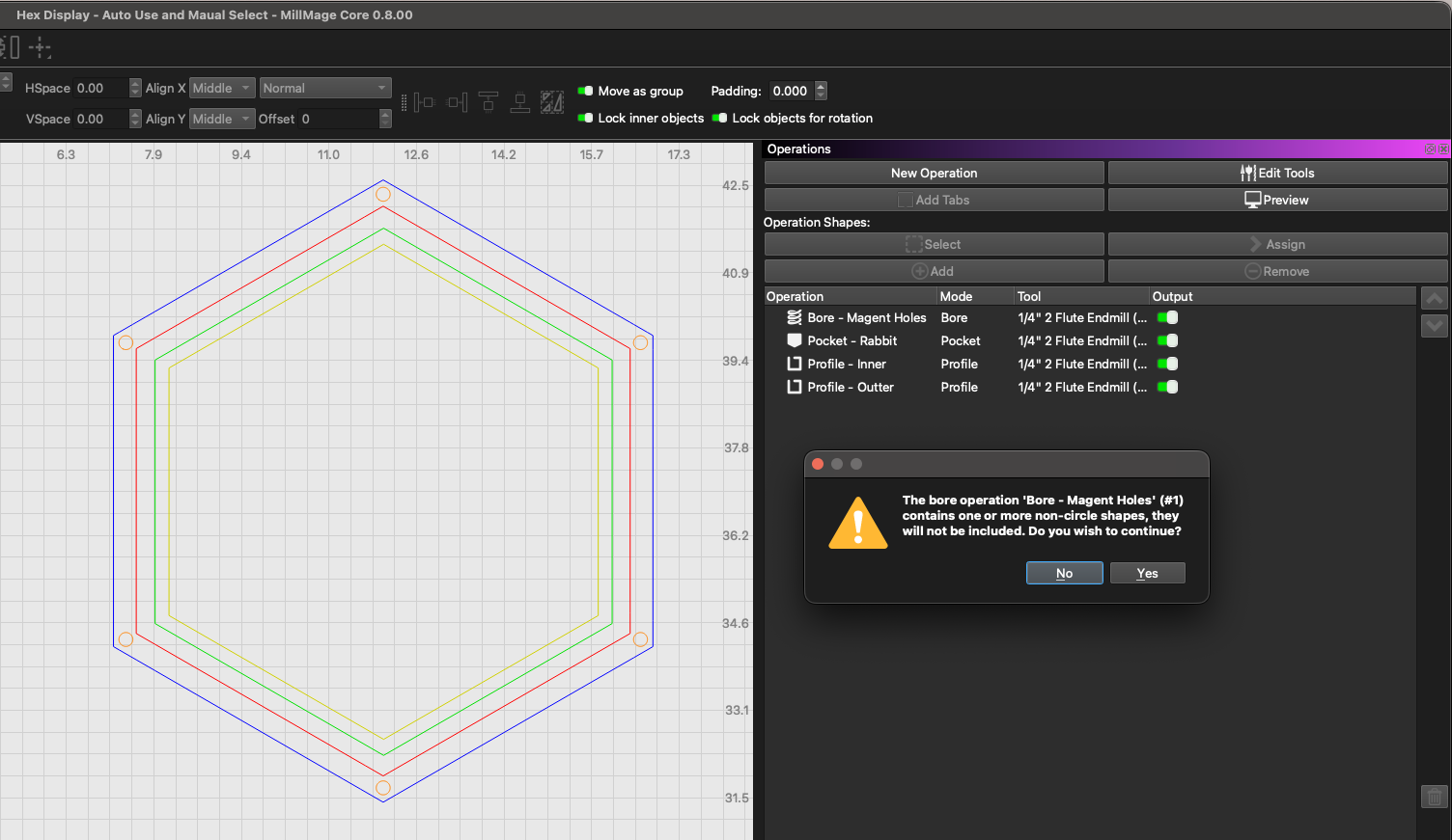

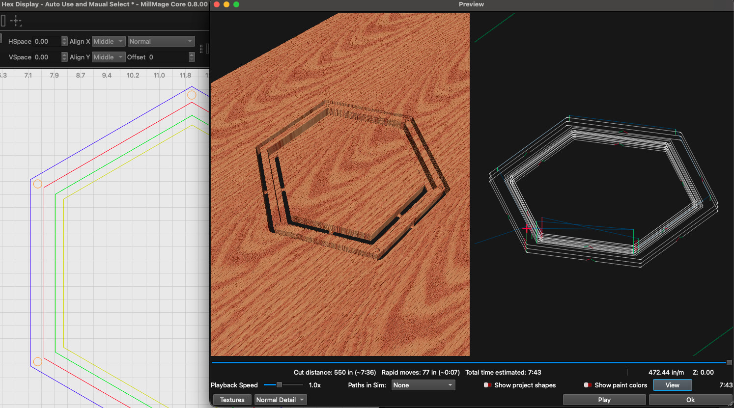

Re-open the file, click preview, then get this error.

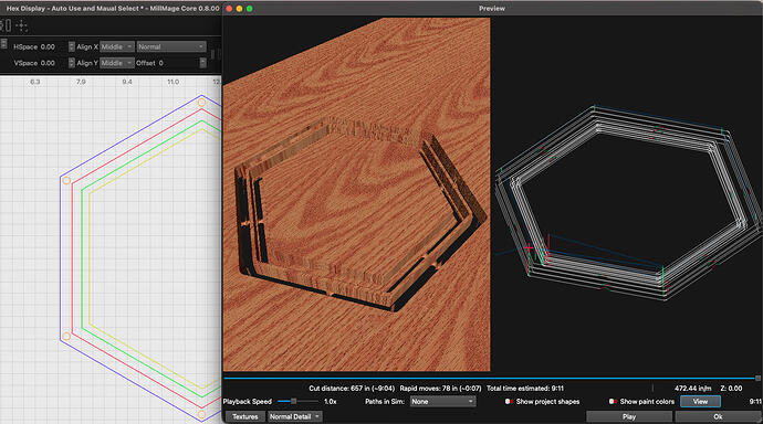

I click yes then the preview looks like this, which is not correct.
Here is the file again to look at if needed.
Hex Display - Auto Use and Maual Select.mage (60.2 KB)
I re-read your comment and see that EVERY operation needs a manual selection. I read it as just one in the project needs it.
