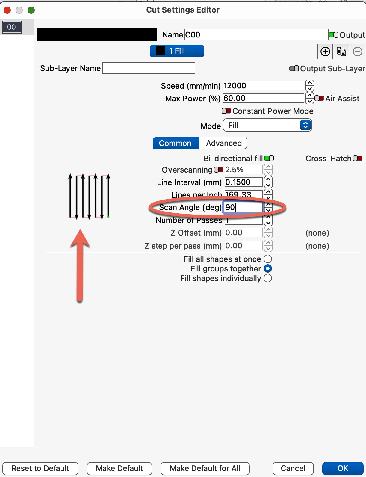

is there a simple setting for when you rotate text 90 degrees? can i switch the scan direction to move y axis first then the x? when i rotate the text, and there is space between lines, the laser has to travel across those blank spaces just to make one small tick, then move on. seems would be faster to scan across the line of text rather than up/down the lines.

cant change the orientation due to the length. the y axis is larger. 810x1030. so it has to be that way. and fast whitespace scan is on.
looks like the offset fill option mite be the ticket. ill have to try that. although you would think the software would realize which way is fastest, without having to do that.
If your text is filled, you can change (rotate) the scan angle to match the rotation of your text
