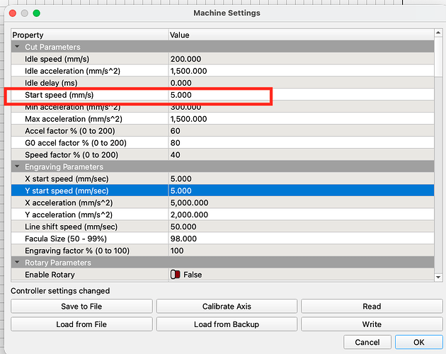

Thanks everyone. So went through and aligned everything again. I tried cutting the circle i created in Lightburn. again 100power 7mm feed. get the same results. Opened a file that was saved on the machine from the previus owner and tried running it. Was set to 75% power and 150mm feed and cut fine. So im guessing it me having something not right in Lightburn and not a laser issue :frowning:
Actually 7mm/s may below your start speed setting. That will cause it to lase at a low power. Mine was originally set to 20> Changed it to 5 when I had a thick piece of acrylic to cut that required a low speed. It wouldn’t cut through until I reduced the start speed.

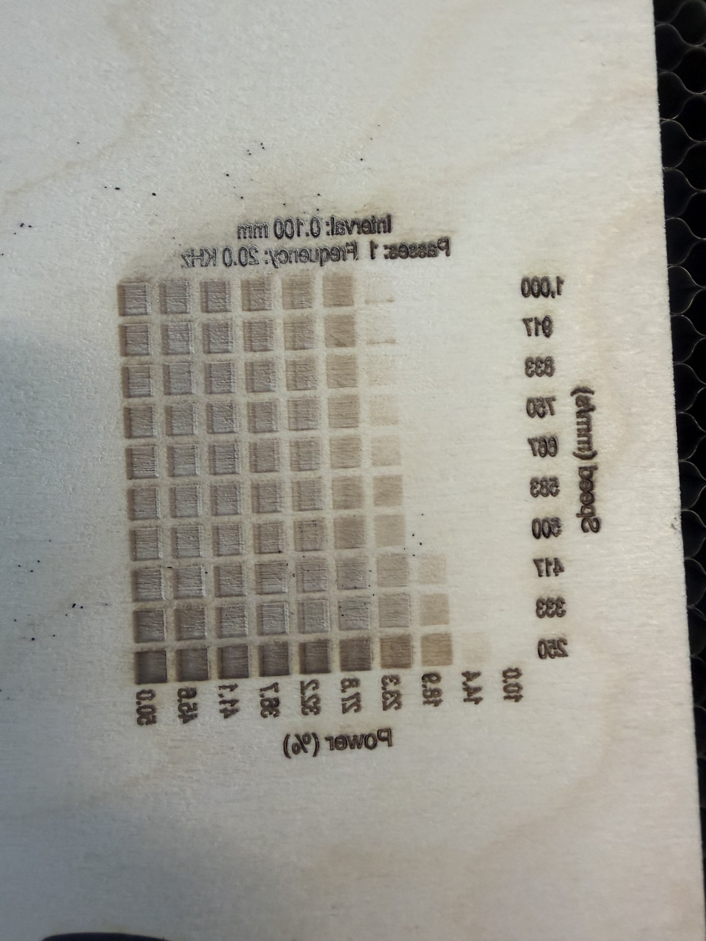

So been trying a couple lightburn test patterns. The engraving looks good and the cut test came out. The shading test seems to be cutting kinda deep?
