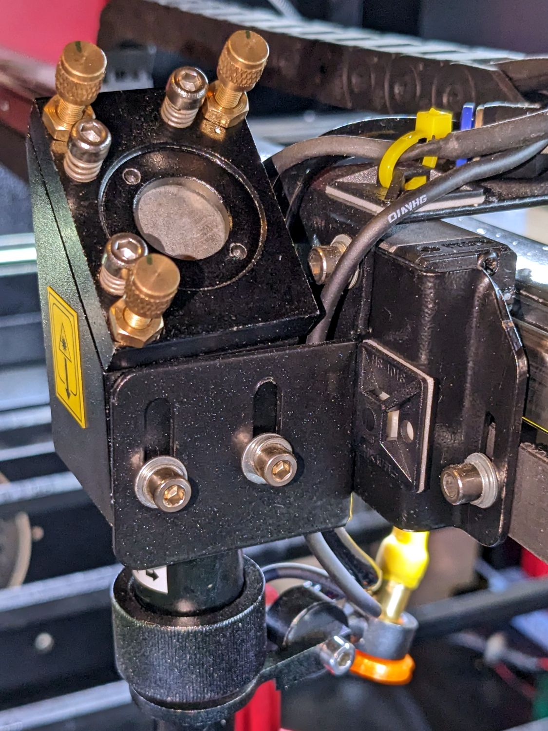

This one has been a challenge. Many moons ago, I used my 3D printer to make a replacement for the threaded mirror retaining rings on my red/black CO2 laser. They are approximately 20 mm diameter with a thread pitch of 1.0. The 3D printed versions no longer secure the mirrors properly. The threads have worn away or vibrated and abraded, but they just don’t hold.
Unfortunately, I can’t find the rings I’ve removed, although I’m certain I did not dispose of them.
I’ve also discovered that I’m unable to find replacements online. Reddit has provided suggestions for search terms but all those returned nothing useful.
It’s possible that a K40 uses the same threaded ring, but searches with that focus are also lost.
Would someone know of a source to purchase a few of these retaining/locking rings. There’s plenty of links for the removal tool, but zero for the rings.

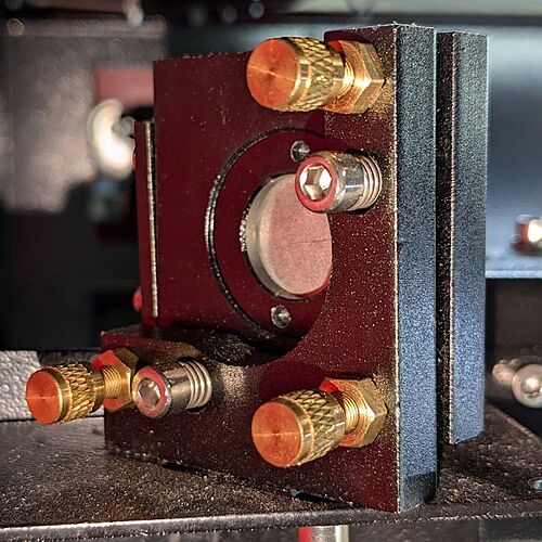

> [@jkwilborn](#):
> have never seen a ring that holds a mirror
Your laser doesn’t have two-pin rings on the back of the mirrors?
 ![PXL_20230904_224333064 - OMTech CO2 Mirror 3 mount - Z screws](https://forum.lightburnsoftware.com/uploads/default/original/3X/f/b/fb165f11d6052c6feec29626cfa2a2c1aba2b11a.jpeg)
 ![PXL_20241119_002946569 - Mirror 2 - rear](https://forum.lightburnsoftware.com/uploads/default/original/3X/f/4/f4742d28f74cf2ada4b6e51faaf97ff5c12146aa.jpeg)
Maybe yours have snap rings?
> [@fred\_dot\_u](#):
> approximately 20 mm
They look like a straightforward project, but I’d _really_ want the mirror mount in hand before I spun up the lathe. The mirrors in my laser are 25 mm, so the rings are _definitely_ not the right size for yours. 🙁

Other than the size difference and the material being raw aluminum, my lost retaining rings are the same as shown in the photos. I’ve been able to find M20-1.5 pitch bolts but I also don’t think it’s exactly 20 mm diameter. That’s more the diameter of the cavity between the threads, making it a more experimental project than ever.
I’ve been hoping to find at least one of the rings, allowing me to use it as a template for lathe work. No luck yet, as our house and hobby room is barely walking room and all the expected locations have been excluded by inspection.
