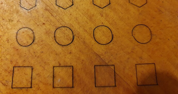

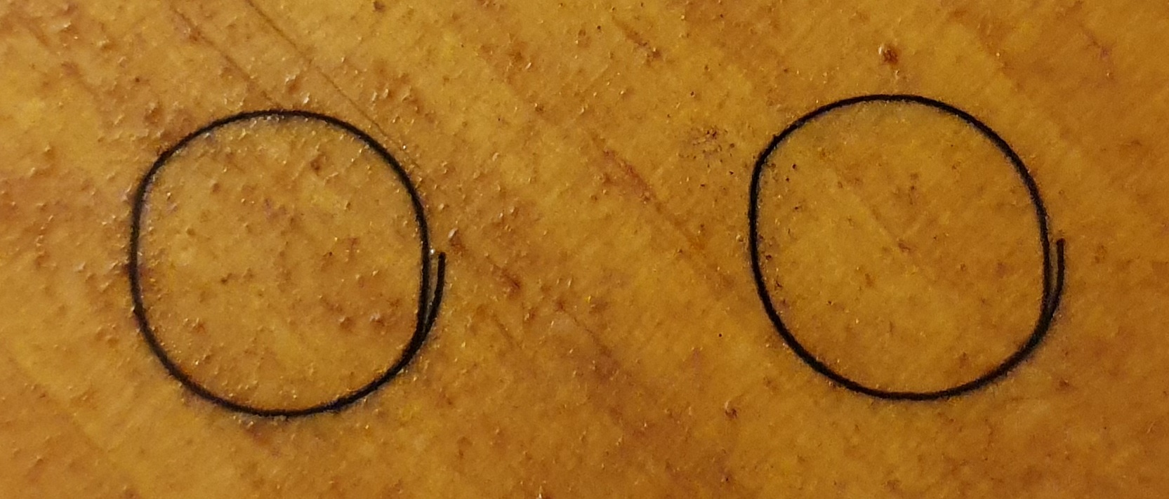

Hi,
I have this problem when I make a cut. Someone would have any idea ?
Thanks for your answers
When it’s machine specific like this, it might be wise to post in the Ortur section. The machine is making your circles flat, so there is an issue.

have you checked for stepmm of X and Y?
take a ruler place it near the laser head then fix a 0 point. Move the laser head in Y by 50mm and look at the ruler if the laser head has moved exactly 50mm. Make same on X
In LB there is a tool under “machine settings” called “axis calibration” or something like that, use that tool to modify stepmm if necessary
And triple-check belt tension…
Hello Everyone,
Thank you for your answers. I retensioned the belts and the problem almost disappeared.
