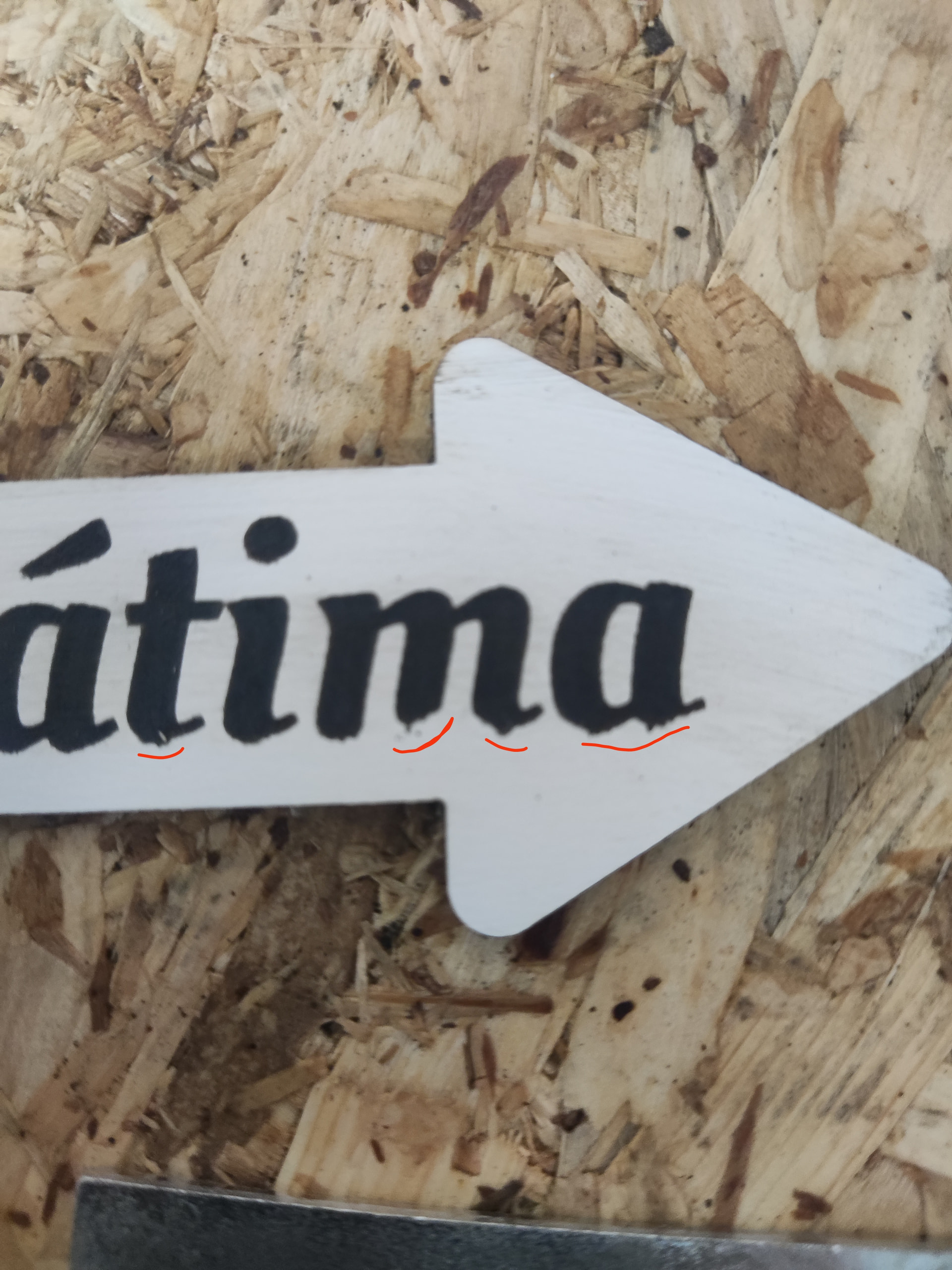

Hi everyone. I´m working on a Sculpfun SF-A9 (20/40W) with the 20watts selected and out of the blue i started getting missing or irregular engraving at the edges of the forms. I normally dont make small or thin engravings on this machine, however in this file it has never happened to me.
I´ve already thinkered with speed/power, checked focus, changed Line interval to 0.08mm (it was before 0.1mm, ghanged to a diferent bulky font, cleaned the lens and the rail where x-axis move.
Can Anybody help me pls?
I don’t really see bad zones here, maybe do a closeup?

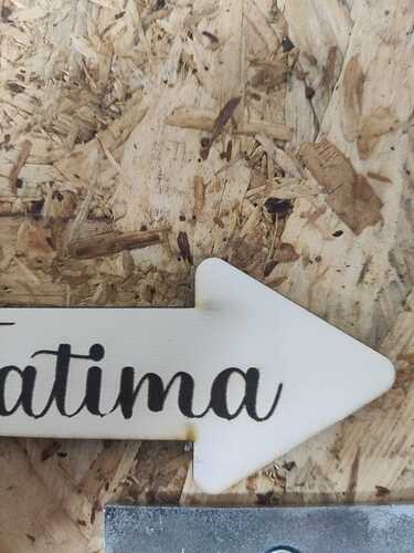

First pic. The second leg of “m” didnt engrave all the way.
Second pic. Between the “i”, “t” … The “legs” of the letters where is a more thine line it show some “nicks” on the engraving or it fades

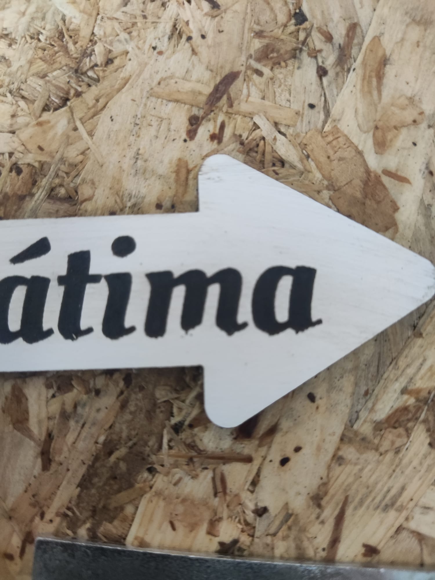

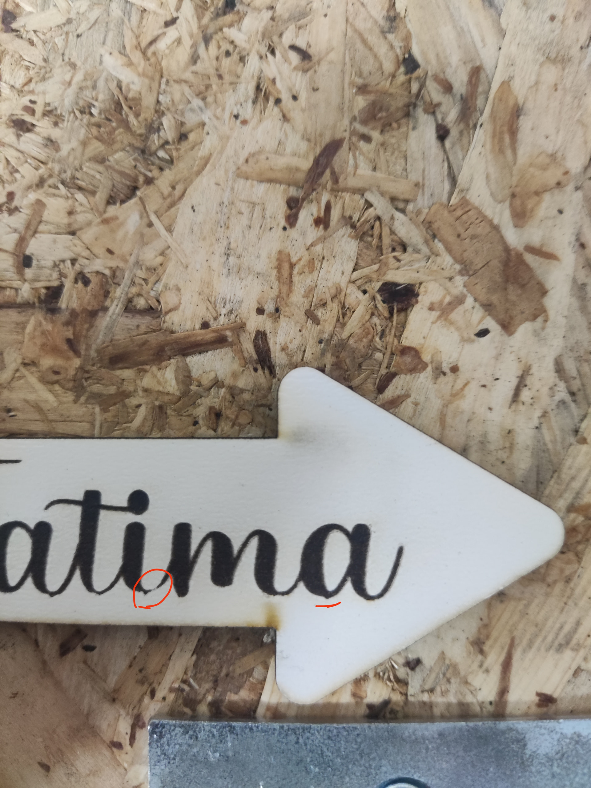

Send you the same pics qith the areas that are not good

I see the anomalies, but, I’d think they would be too long of a laser on mode or something related to it’s scan operation.
What you’re telling me is that it’s scanning along the X axes both, on the machine and in the photo?
If that’s the case I would expect them to be in the source. It has to generate code to do this, not just malfunction.

To clarify the letters are on vector. When i spoke about the x-axis rail i cleaned the machine arm.
The file itself doesnt have that incorrection… Because i’ve been using the file for quite some time and only now is happening.
Examine how it’s scanning. This has to be generated if you gave me the right information.

If you use a different file, does it happen as well? Try to increase power, maybe the lens is slightly distorted and the 20% are borderline. Try if 40% remove the error. And check that “fill at at once” is enabled, such that it doesn’t do individual letters.
Don´t know why but i increased a little bit the speed from 2000mm/m to 2500mm/m and the power from 20% to 40% and it worked. Eventually i reduced power to 30% to give a more smooth engraving and it work just fine.
I also dont know why all the sudden this started happening because this file and previous settings i’ve been using them for months.
