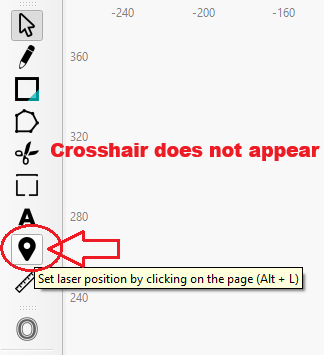

Missing Laser position crosshair (alt+L)
When clicking the laser position tool, no crosshair will appear anywhere.
I have seen other people having the same question but I cannot find any answers.
Perhaps Show Last Position isn’t enabled:
Note the caveat:
The position does not update live
It’ll only show the position when you deliberately jog / move the laser head, not while the controller is running a job.
