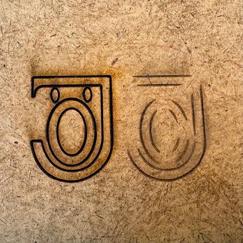

Just installed an MKS DLC32 on a 130W CO2 laser.
On the left, I have 20% power and a speed of 20 mm/sec.
On the right, I have 20% power and a speed of 100 mm/sec.
I don’t understand why the laser doesn’t burn all the lines when running at a higher speed.
When I run the same job on my K40, the result is perfect at the higher speed.
Could it be that the DLC32 isn’t fast enough?

I can’t tell the size of the artwork. If the art is small it might not be able to reach 100mm/s in such a short distance.
ojje:
No. The DLC32 has a 230mHz clock speed, or there bout… so cpu or board speed isn’t an issue.
How did you interface the DLC32 with the is the laser power supply (lps)?
The basic two, IN and L on the lps, how are these wired to you controller (DLC32)?
ojje
(Örjan Johansson)
March 23, 2025, 6:53pm
3
It is just 30 mm high, and I can run the exact same file with perfect result on my K40 with a Cohesion board.
IN goes to S
And I do not use L, I use H istead, connected to +5V on the DLC2 board.

It looks like it’s making up for corners, using something like min/max power .
Do you have these settings?
Is this a line or vector image? Each line is the laser beam width?
ojje
(Örjan Johansson)
March 23, 2025, 7:58pm
5
I don’t use max/min. I don’t understand what you mean by vector or line? It’s an imported DFX, and each line is the width of the laser beam.

I thought max/min was a software setting. I only control the power from 0 to 100 using PWM from the board, driven by G-code from LightBurn.
Could it be an acceleration setting for the card, perhaps?

Is your $30 value set at 1000 along with the S-Value Max?
If these are off, then it could effect your power settings.
Do you have a mA meter for tube current?
ojje
(Örjan Johansson)
March 24, 2025, 7:35am
9
So strange. If I lower the speed to 70 mm/sec, the result is a little bit better…
The mA meter works correct.
Can you see something odd in the settings?

The problem is solved. I changed from active high to active low, and now everything works. Thanks for the support!
misken
(Melvin)
March 24, 2025, 2:45pm
11
Out of curiosity, which setting did you change?
ojje
(Örjan Johansson)
March 24, 2025, 3:32pm
12
Sorry for my lack of clarity. It was the wiring I changed. Previously, I had connected +5V on the MKS DLC32 to H on the laser PSU (and TTL to ground). I changed it so that TTL on the MKS DLC32 now goes to L on the PSU. No connection to H anymore.
