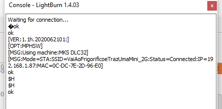

  3. Can you run these commands in Console and return output?
$H
$I

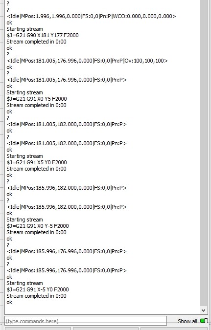

  1. Can you turn on “Show all” in Console, then initiate this sequence of jogging moves: up, right, down, left. Then return the output of Console

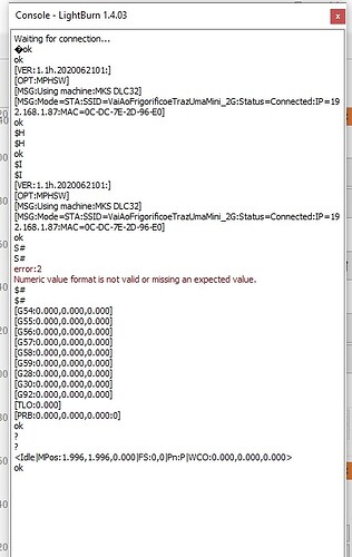

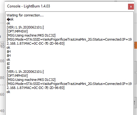

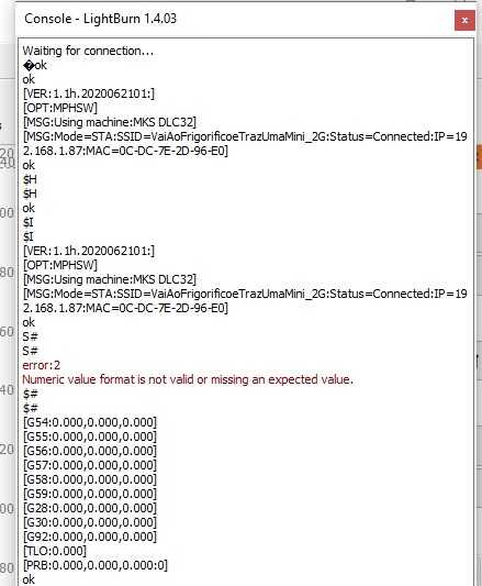

When I entered this command the machine did “Home” correctly.
Command $H
$I
When doing this command I replaced $ with S and it gave error 2, sorry.
Of course. I’ll just place the laser head in the center of the table so I can execute the commands without hitting the “Hard Limits”
Then the commands were made in the requested order.

Nothing here looks out of the norm to me.

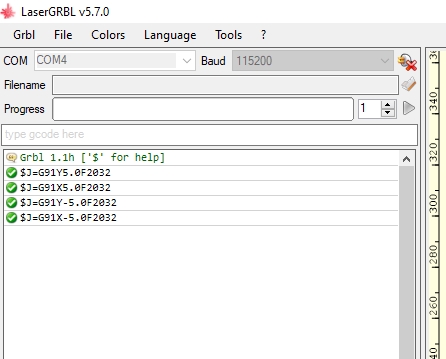

Can you open LaserGRBL and take a screenshot after jogging Up, Right, Down, Left?

Now that I did the test you suggested, LaserGRBL worked exactly like Lightburn, only the direction on the display remains inverted in relation to the software used. :flushed:
The other day I was going to swear that it didn’t behave this way because I was wondering how one software works according to the display and the other doesn’t… :thinking:
Now I don’t know what to say… :angry:
LsrGRBL-UpRightDownLeft
Well, that breaks the hope of being able to reproduce those results on the LightBurn side. On the other hand, it means a single solution could potentially resolve both applications.
