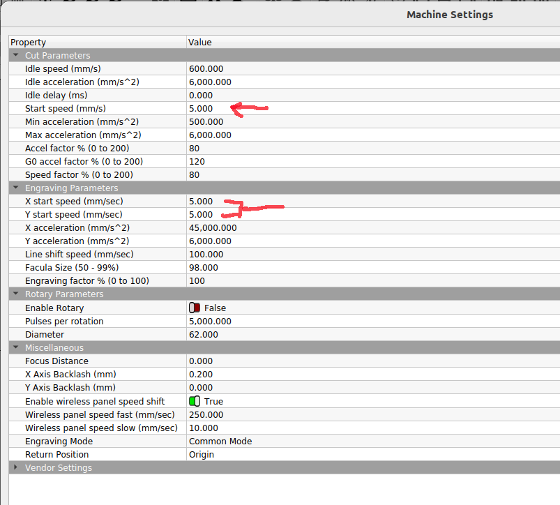

Hello all. I had my machine setup for rotary and tumblers, and wanted to remove it, which I did. Reconnected the aviator plug, etc…
When I turn it on it, it wants to go home and grinds for a second. Home on it is back top right. Can I set the laser to just sit in the last position used when it starts up?

Edit → machine settings → miscellaneous is an option for return position.
It has No return, Origin or Absolute Origin.

What did you change when you used the rotary?
I change the return postition via the machine settings in Lightburn. This graphic is for start speed, but at the bottom, right above vendor is the return postition drop down.

Got it fixed. US support mentioned that my Switch could be loose or crooked. It was tight and straight.
A user on a FB group, told me to bring the gantry back to me, and position the head bottom/left. Then turn it on. That worked.
