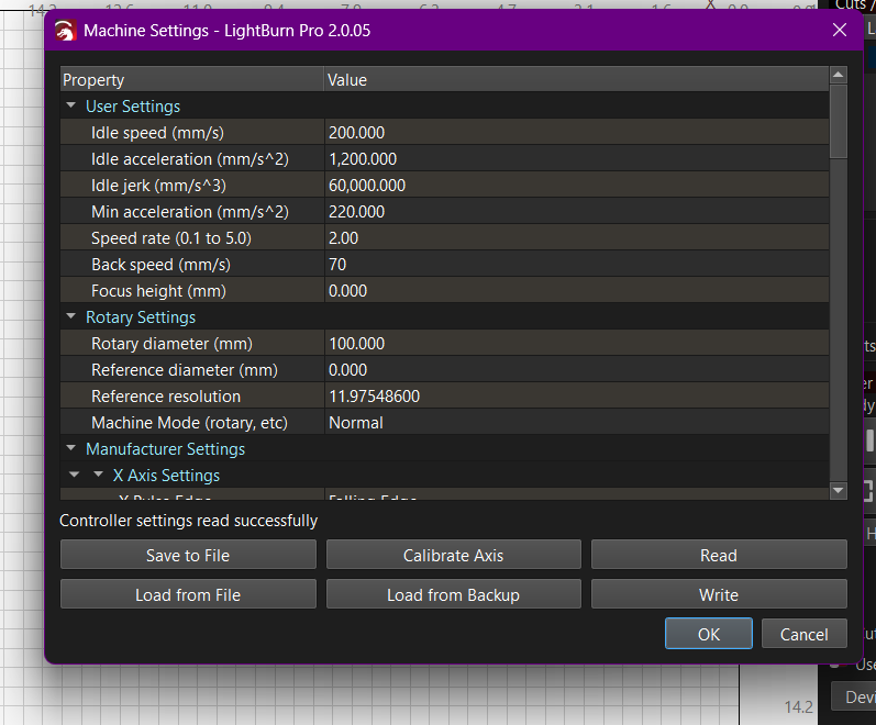

I’m having trouble with the Lightburn settings on the Monport. I go to engrave a 3inch by 3inch square but I get 1.5 inch by 3.0 inch. I lightburn I have set 3.0 x 3.0 square. I have compared the Lightburn setting on my laptop that I use on the Omtech, I have not any troubles with Lightburn on the Omtech. Lightburn version 2.0.05

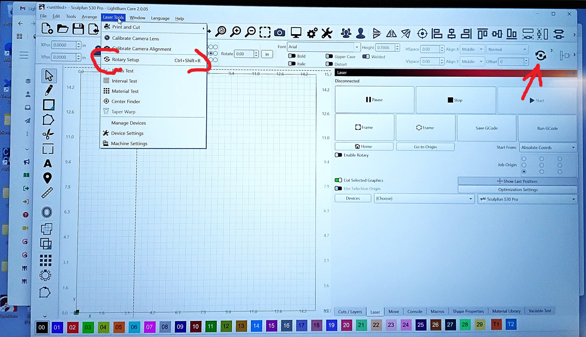

Most often question asked for this: “Do you have the Rotary switch on?”
That’s odd I have the DSP version 2.0.05 on my laptop that I use on the Omtech has a rotary setting in the laser tools but in the desktop when I go to laser tool there is no rotary setting. Both version 2.0.05. The Monport 65 w pro is a desktop laser.
Is Beginner Mode in Settings turned on?
no it’s off
You have neither of these chouces for the Rotary?
No I do not have either one I have a Lightburn pro 2.0.05 on my laptop in the garage hooked up to the Omtech and I have lightburn pro on my desktop hooked up to Monport 65w and theis one does not have either rotary symbol or rotary in the laser list

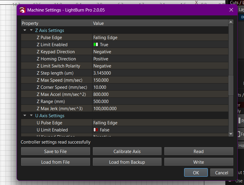

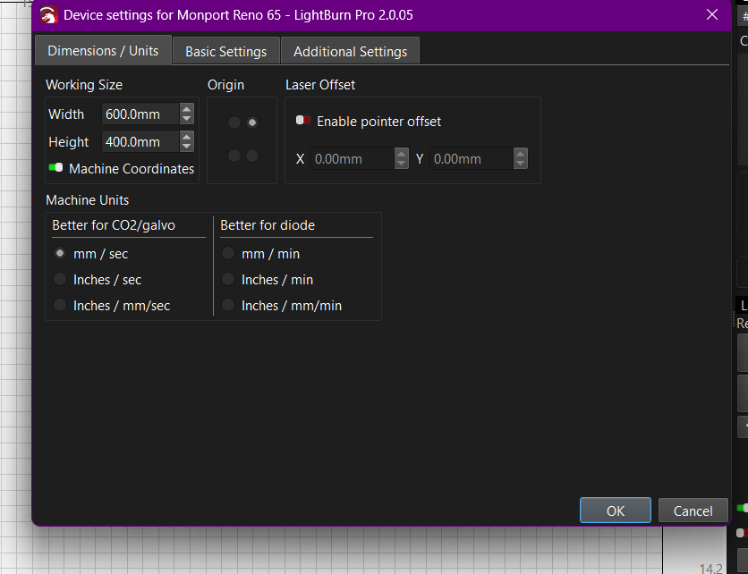

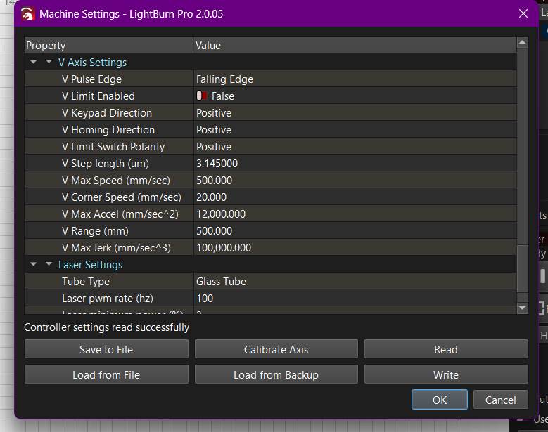

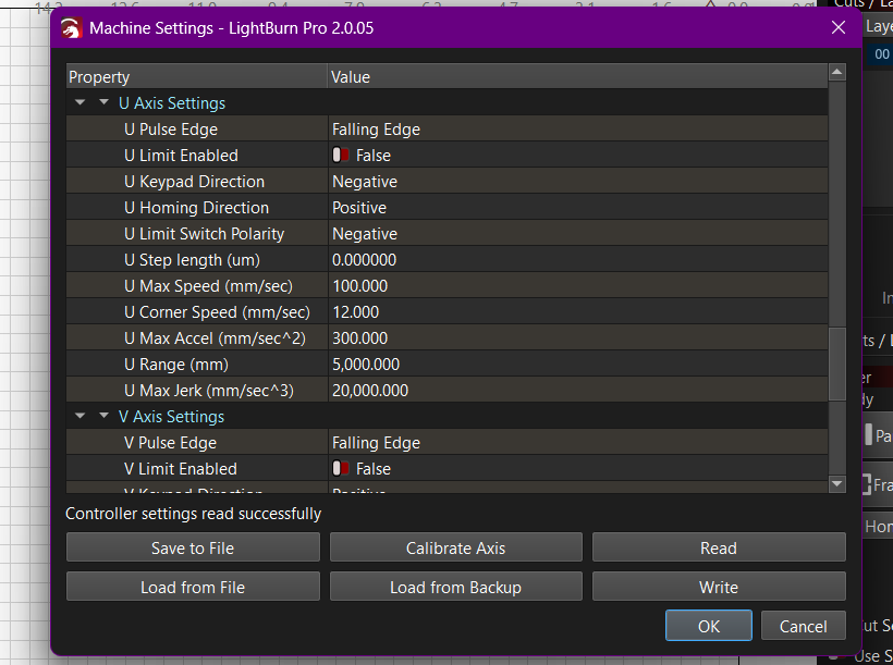

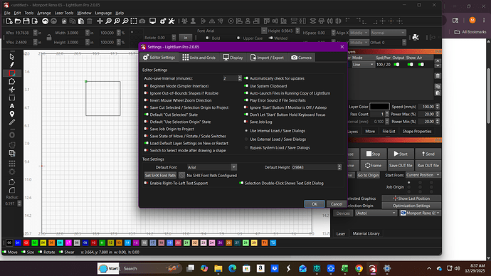

Please post a screenshot (not a cell phone pic) of your entire Lightburn screen with your project loaded and the Cuts/Layers Panel and Laser Panel visible. Also post a screenshot of the Settings Window (Gears icon) with the Editor Settings tab visible and post a screenshot of the Device Settings Window (Wrench and Screwdriver icon)Dimensions/Units tab and the Basic Settings tab. Alos post screenshots of the Machine Settings window(Laser Tools> Machine
Settings) You will need to click on Vendor Settings and say yes to the warning. You will have to scroll down in order to show everything.

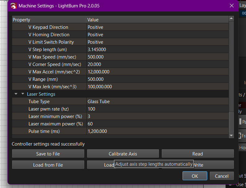

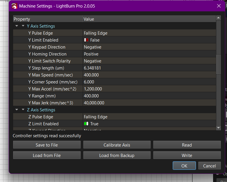

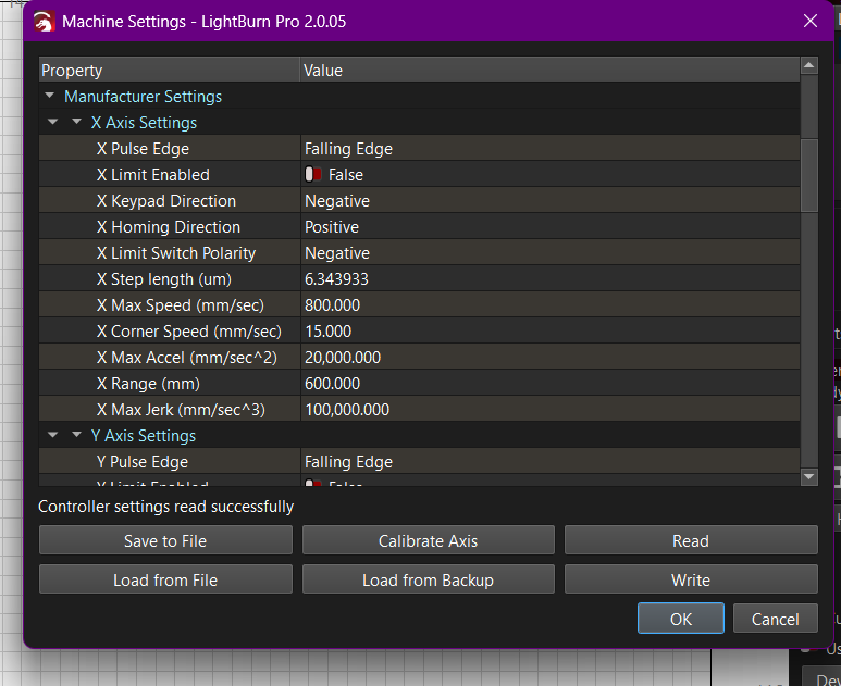

What I see in machine settings is rotary mode is normal, which I assume means off. Maybe see what other options are there. This is a different controller than mine, I have an Enable Rotary True/False switch. Your steps on the X and Y axis are almost identical, which is normal.
I have no idea why you don’t have a rotary dialog in Lightburn.
If playing with the rotary settings in Machine settings doesn’t yield resuts, you will probably need to contact Monport since this is a new machine. Good luck with that, from what I hear.

If the Monport has a TopWisdom controller as mentioned in the profile, then LightBurn can’t control it and that mode may be inadvertently enabled at the controller display.
Also, having Machine Coordinates enabled for a non-CNC controller will surely have weird consequences. Whether that cancels some TopWisdom weirdness is beyond my ken. :grin:
That would explain a lot.
