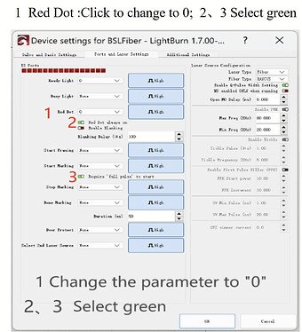

Hi all , just got my MP GM 60w mopa laser 3 day ago , installed software
seacad BSLapp, worked good , but did not give me a desktop icon , Owell gonig to use LB anyway , works great on my MP Gpro 30w… start up the 60w placed blk cardboard down no framing , checked setting for 3 hours still nogo .
the manual that came with MP new line of lasers real bad been lookin 2 day asking others here an no one said to [check out this thread](https://forum.lightburnsoftware.com/t/bsl-boards-seacad-support-in-lightburn/77669)? I have lrean more here in 15 min what I can do now , then I have in the 3 days of web jumping,
lol not upset, just confused, ty

Hello Darryl,
I’ve split this comment to a new topic here.
> [@Draz](#):
> no framing
Did you setup your Device Settings exactly as instructed in this [Monport manual](https://cdn.shopify.com/s/files/1/0591/5128/6471/files/GM_User_Manual_20250109.pdf?v=1736500223)?
Specifically this part marked 1 and 2 seem important:
 ![image](https://forum.lightburnsoftware.com/uploads/default/original/3X/6/7/67ec283fd7db30833124fe28abc6183ddecf81e5.jpeg)

Aaron , I did what you said , IT works. I have been all over an no one ever said anything about these setting. Im a concrete finisher 65 old , tec Noobee. is there a brake down on all the setting can do? in lightburn ,Thank you for keeping from going crazzzy. lol would you like me send ya the manual MP sent with this laser ? to me it not right, ty Darryl

That’s great!
Sure, you can find the documentation here: [Galvo Settings - LightBurn Documentation](https://docs.lightburnsoftware.com/legacy/galvo/ConfigureGalvoSettings)
You can also hit the F1 key while hovering over a setting in LightBurn to get straight to the relevant docs page.
You don’t need to understand everything there, just make sure to also change the other settings according to the manual.
