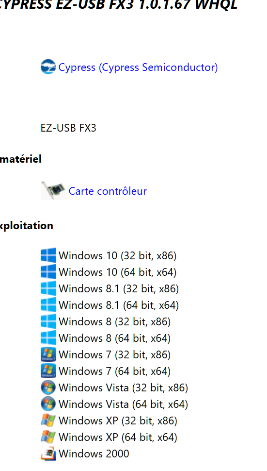

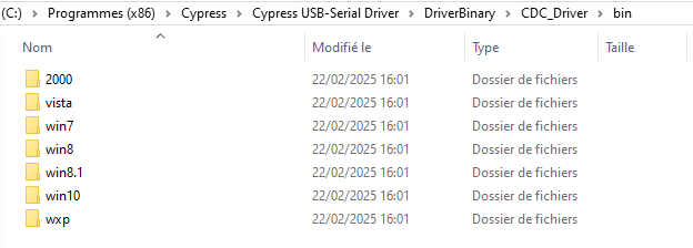

I just received my Monport MOPA 60W (YXF60) and I can’t install the Cypress drivers (supplied by the manufacturer) on my Windows 11 computer. I’ve tried several times but it doesn’t work, but it works on a Windows 10 computer.
The driver is CypressDriverInstaller 1.0.1.67

Congratulations and welcome.
It seems the driver you have only work with <= Win10.
Do you have more info? like pictures of your controller?
Hello Parsec,
I found the same thing when looking at the driver installation files.
I don’t have any more information about the motherboard and I’m afraid of doing something wrong by opening the machine to see.
I’ve sent an e-mail to Monport support to get more details.

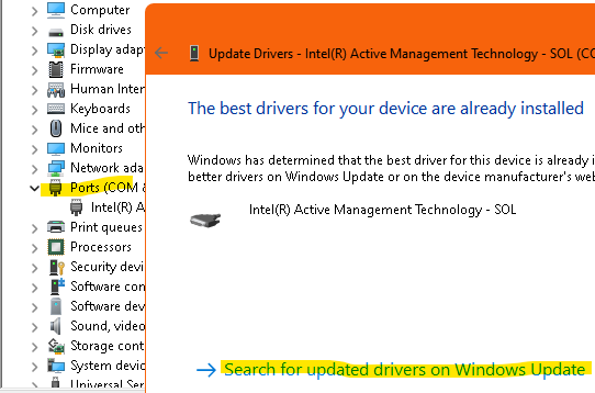

  • 1.With laser connected and powered ON when you insert / remove the USB plug does Windows make a sound?
    1. Does your laser appears in Device Manager? If so perhaps you could try updating the driver trough Windows to check a newer version or trough Windows Update > optional updates
e.g.:
Yes, the usb is detected when I plug in my usb cable, but the pre-peripheral is not recognized. I just have an unknown peripheral. I tried to force the detection of the drivers by pointing to the Cypress installation folder, but it doesn’t find anything.
Maybe I should do a clean install and try again. I may have another conflicting driver.

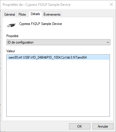

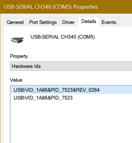

  2. On Win 10 check for Hardware Ids that may help identifying the controller.

2 Is it in french on my W10 computer, but i thinh is it “Hardware Ids”
I also found this driver: oem85.inf
On my W11 computer I couldn’t find it in C:\Windows\INF. I added it and tried to install it but it’s doesn’t work and the driver still undetected

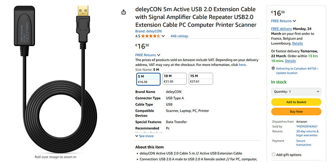

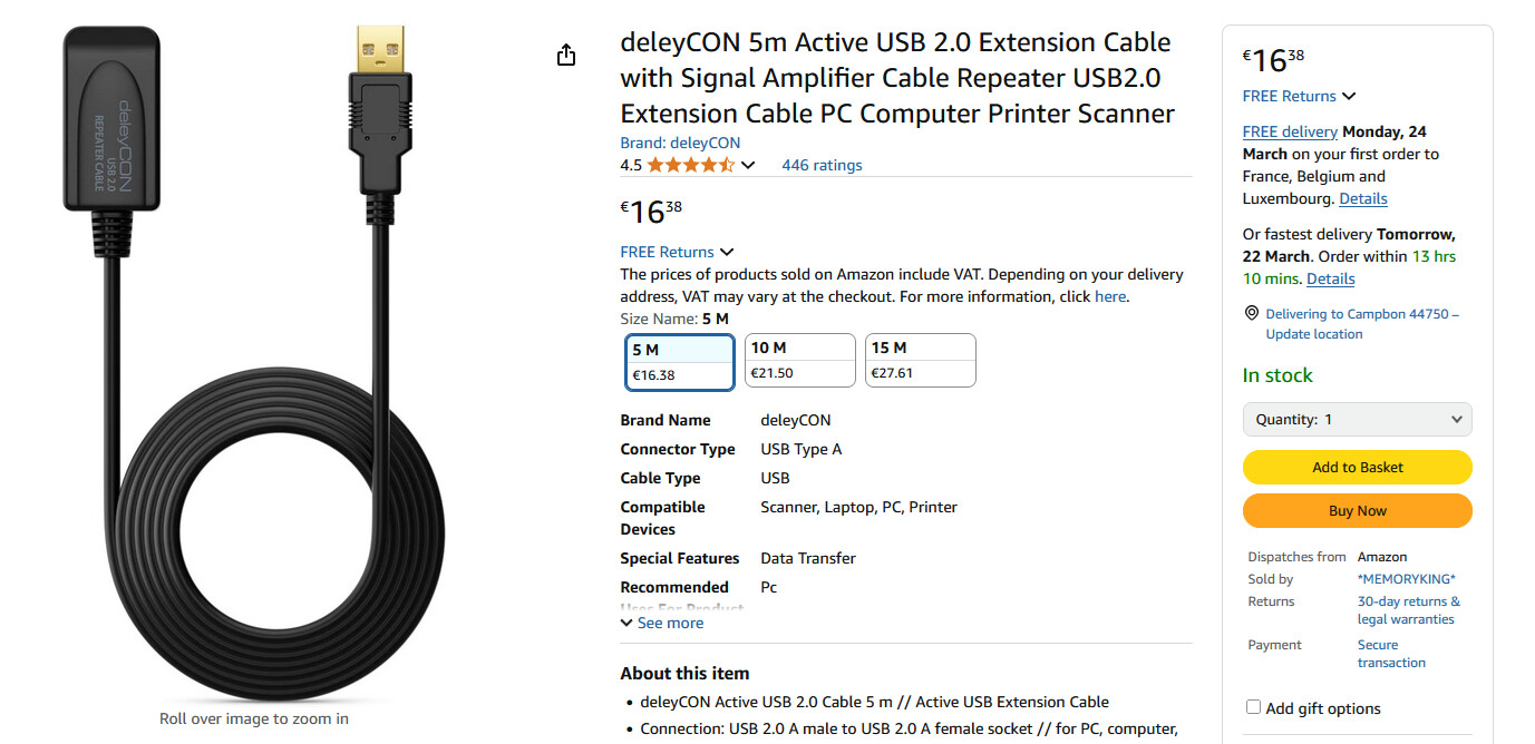

So, contrary to the instructions, it’s not possible to use a cable longer than 2m. I’ve just ordered a cable extension with a signal amplifier to see if it works. :crossed_fingers:

I bought a USB 2.0 extension cable with a signal amplifier. The minimum length is 5m but it still works.
I hope this helps :slight_smile:
