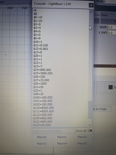

The most likely cause is a mismatch between $30 in the Machine Settings and S value max in Device Settings.
Most often the $30 = 1000 but it’s good to check.
It doesn’t really matter if it’s 255 or 1000 or even 10000 as long as the two numbers agree.
From the Console window, please request the Machine Settings by typing the following:
then press return.
You’re welcome to copy and paste those values into a reply here if you like.

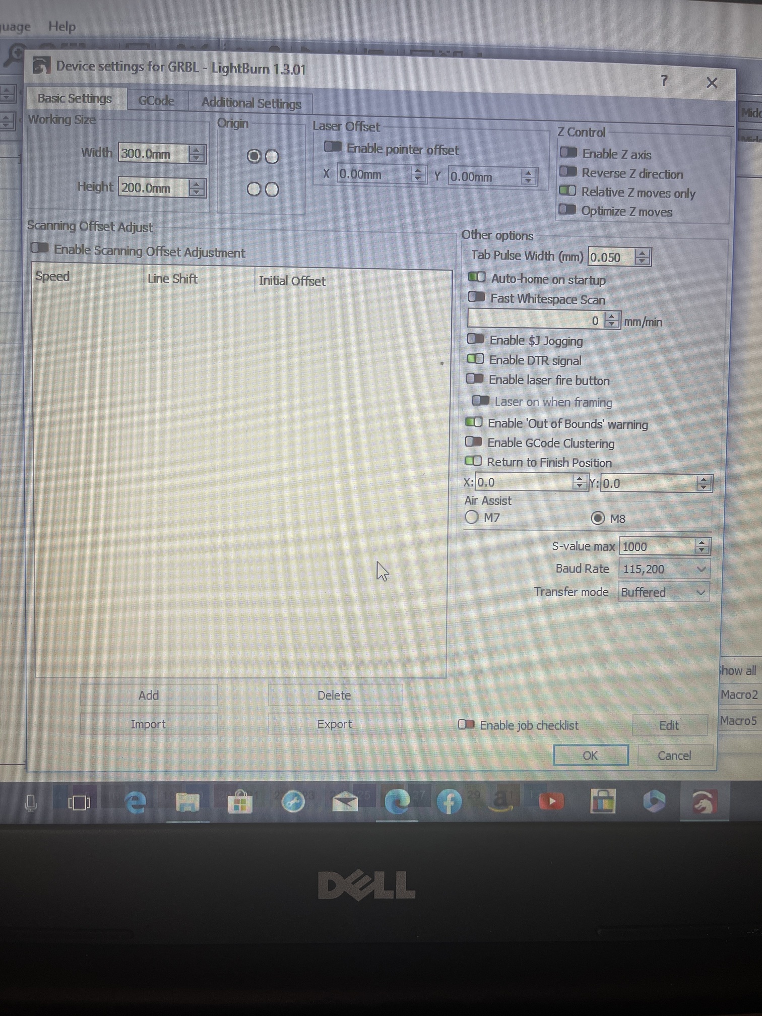

When you click Edit, click Device Settings and this Window should pop up.
Set this number to the number that was in $30 in the Settings report.
If this doesn’t solve it, capture this screen like I did and upload the pic into your reply as well so we can examine this further.

Edit: $30 not $32
$31 should be 1

Re: $31=50
Monport uses a Grbl controller for its k40 variant.
$31=50 may represent minimum PWM.
Let’s not enable the test fire button until we have the model number or see the $130 series settings. :slight_smile:

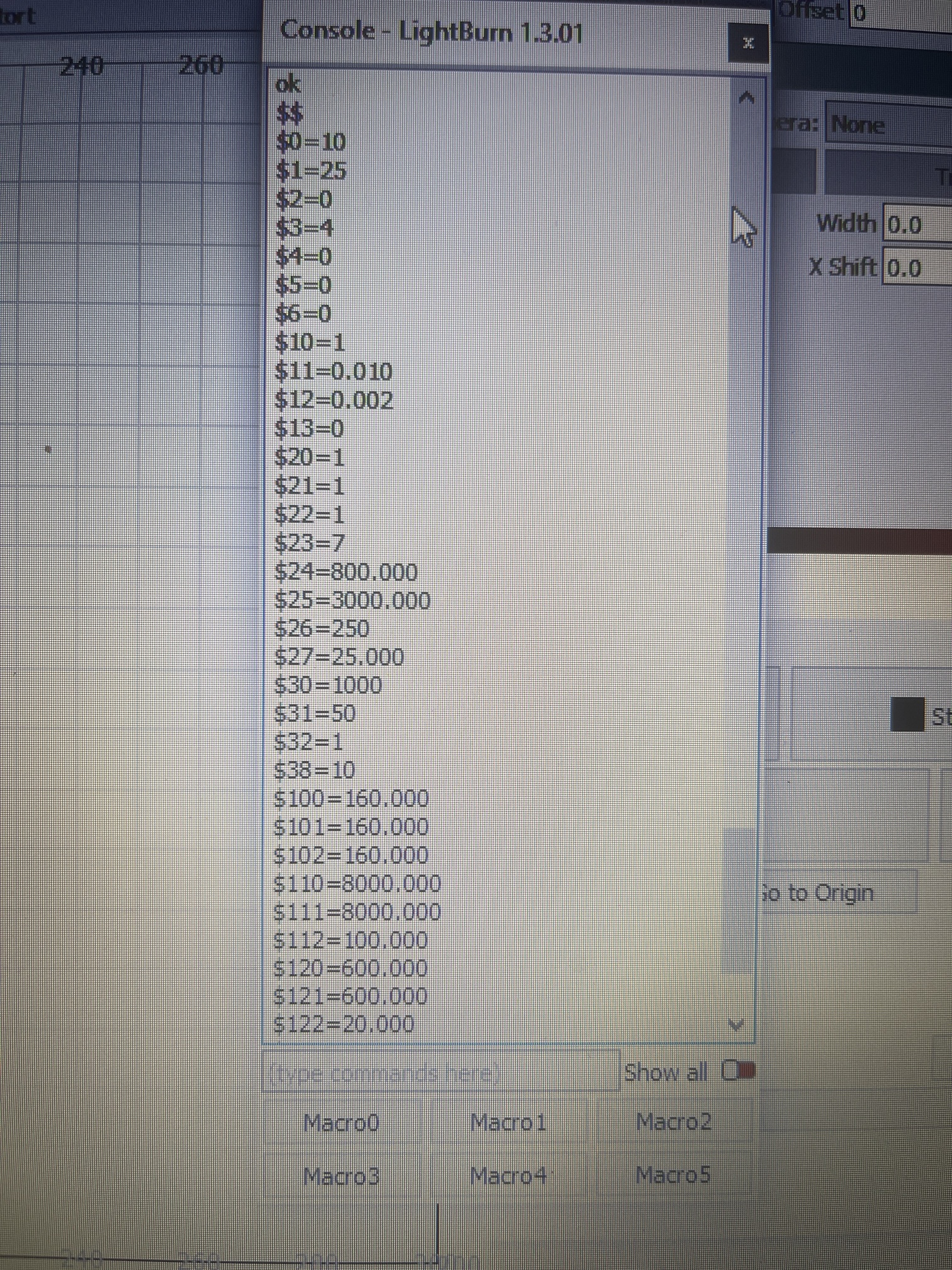

I seriously doubt that your machine will run 2000mm/s…?
Looks like mm/min in that corner.
Max rates are set for 8000mm/min.

$13 is set to zero… is that not mm/s?
I believe that this setting is also correct.
I feel that it may be limited to distance units.
