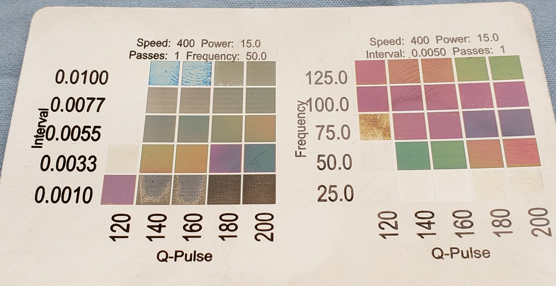

Its a huge amount of trial and error. Look at show and tell here and on LMA and ask questions about what you see. Lots of you tube videos. Sorry can’t be more help there.
<div class="post-metadata">
**Post date:** [March 25, 2025, 1:56pm UTC](https://forum.lightburnsoftware.com/t/mopa-laser-waveforms/168542/7 "2025-03-25T13:56:50Z")
</div>

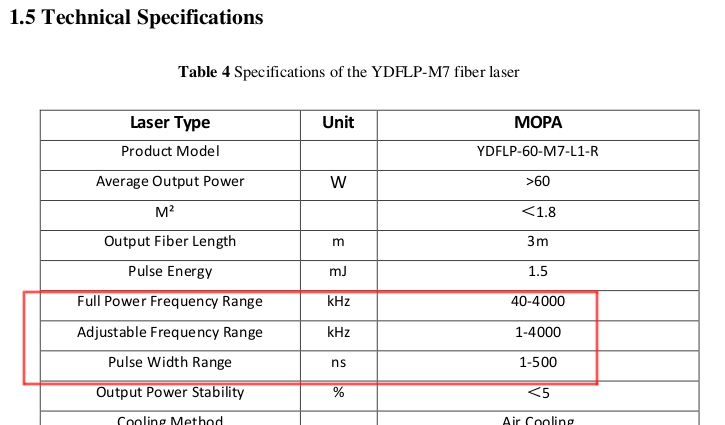

I have an [M60 JPT M7 MOPA and the manual](https://drive.google.com/file/d/1_hU7RruZixFzRCElQ68uinPMbqPD0XPH/view?usp=drive_link) seems to indicate that it’s 100% variable between 1 and 4000kHz… The graphics are from the manual, so you can just read them there if you wish.
 ![image](https://forum.lightburnsoftware.com/uploads/default/original/3X/6/1/61cdd4a25e79f766bedebf590901e45bc22ee14a.png)
However on closer inspection of the manual, there are about 15 different wave forms it can produce… It doesn’t exactly say how it selected which waveform.
 ![60W-fiber-pulse-graph](https://forum.lightburnsoftware.com/uploads/default/original/3X/4/c/4c0b598466533452bd744b0da298ecf49ee09c47.png)
They do say that using a frequency of 1kHz, changes it from a pulse to cw machine.
I’m not an engineer, but my understanding is the waveform are used to drive the hardware to get the specific output we want. Frequency being resolving to pulses/mm. I don’t know if there is a way to change the basic waveform, so it seems that would imply a limited amount of adjustments.
All of these waveforms have a threshold or cut off frequency, as noted in the manual.
 ![image](https://forum.lightburnsoftware.com/uploads/default/original/3X/c/8/c8ed163cb2cdc51153ffb4e5124bfae2f53b7b68.png)
These waveforms appear to have no relevance to spot size, which would be after the output of the source.
The only exception would be a change in beam diameter, but I don’t think there’s any way to change that programmatically.
What really sucks, is there isn’t a cheap way to measure operation of these at this level of detail… especially lacking schematics and other technical information.

Adjust in LB software in the Cuts/layers parameters window. IF Qpulse is enabled in machine settings window in LB.
CW = Continuous Wave.
Dont know what LP + stands for, it is MOPA but fixed Qpulse
Yes, M7.

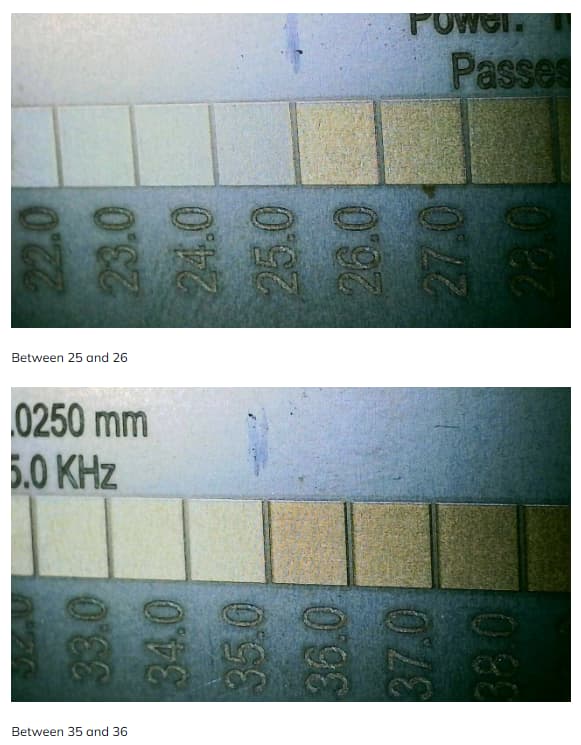

Juts for clarification:
The LP/LP+ is a MOPA, but you cannot select q-pulse.
I’ve done several tests, on my 60W M7 QPulse goes to the nearest pulse width listed when in between.

**Post date:** [March 26, 2025, 6:07pm UTC](https://forum.lightburnsoftware.com/t/mopa-laser-waveforms/168542/17 "2025-03-26T18:07:47Z")
</div>
> [@Albroswift](#):
That’s what I’m suspicious of, but I have no real way to measure it.

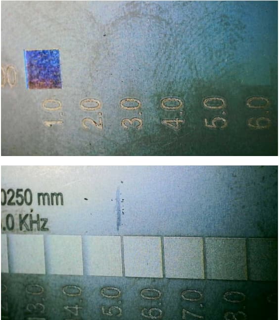

**Author:** ![Albroswift](https://forum.lightburnsoftware.com/user_avatar/forum.lightburnsoftware.com/albroswift/32/44668_2.png) [@Albroswift](https://forum.lightburnsoftware.com/u/Albroswift)\
**Post date:** [March 26, 2025, 6:30pm UTC](https://forum.lightburnsoftware.com/t/mopa-laser-waveforms/168542/18 "2025-03-26T18:30:43Z")
</div>
I ran a card similar to above but went 1 to 500 in 100 squares on a 4x4 piece of titanium.
At least on my 60W, they went predictably to the nearest one.
