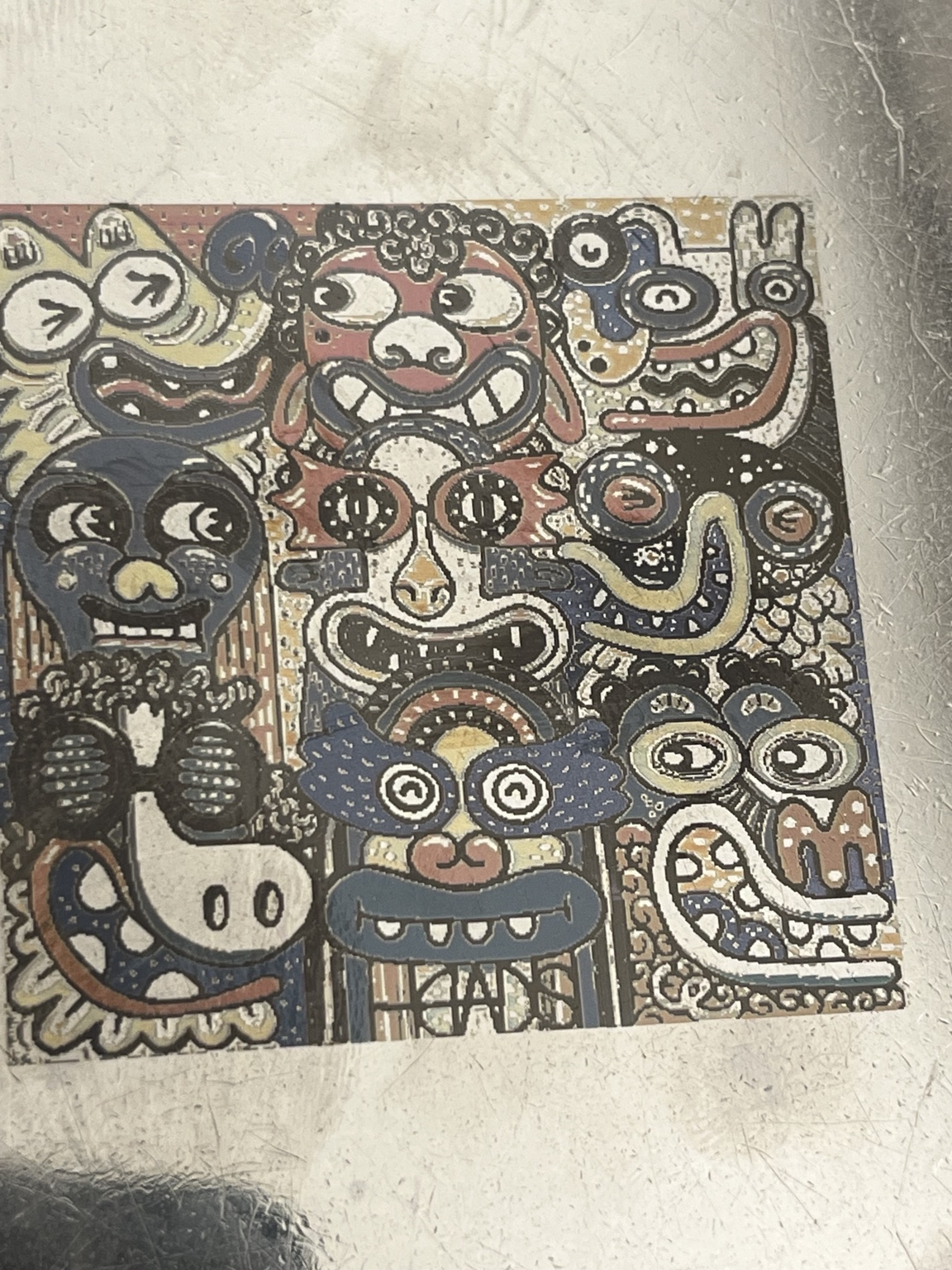

The site includes workflows for:
- MOPA color engraving and color discovery
- Raster-to-vector conversion and cleanup
- Material-Library-driven LightBurn project generation
- Depth and relief engraving, with a unique color-guided-depth feature
- Hatch palettes (color in artwork → hatch settings mappings)
- Fauxlographic and diffraction-grating engraving experiments with tons of controls, such as gradients that can be scoped to individual shapes, whole artwork, custom painted diffraction gradients, and directionality and orientation control such as left to right top to bottom center to edge, and the reverses of those, along with the angular degree of the gradient, and highly customizable fauxlographic settings
- Multi-geometry jobs, where different parts of the artwork receive different geometric treatments, give some colors ordinary vectors, redraw others with configurable glyphs or cut the glyphs out of the closed vectors, and other colors yet can be routed to the diffraction controls mentioned earlier… allowing for highly unique and complex multi-geometry style engravings
The last two are where it gets incredibly interesting.

A major reason I am releasing this is to learn how broadly these techniques transfer,
I have found some extremely interesting results with MOPA color and diffraction-style engravings, including effects that can look like normal color from one angle and shift into vivid psychedelic diffraction patterns as the light or viewing angle moves, while the image still remains cohesive and recognizable. But I only have my own laser, lenses, and materials to test with.
I would love help figuring out what is repeatable across:
- Different laser sources and source types
- Different lenses and field sizes
- Stainless types, finishes, and preparation methods, if anyone has palettes of settings for titanium, id love to see what they can make with it, all my color work has been with stainless.
- Settings, lighting, and viewing angles
- Different approaches to fauxlographic or diffraction geometry
If you experiment with it, please share both your successes and failures. Photos are useful, but video is especially valuable for effects that change with the viewing angle.
