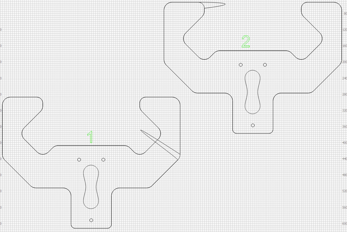

Ha Guys it appears my import wows continue, recently a customer sent me a DXF to cut and I getting strange curves added to the path. What also strange is that the lines move see pic import 1 then same file import 2
Sorry guys no panic figured it out with the guy layer issues and overlaping lines wierd effect though remove duplicates found nothing.
Glad you got it. How was it resolved? With a new export or something on the import side?
The guy had bits of it on different layers in fusion360 and overlaps in the layers which confused the import
