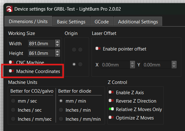

And can you verify for me that the “Machine Coordinates” tickbox is off in device settings?
The “CNC Machine” toggle above it will simply invert the directions sent - so only use it if your machine’s home position is in the back right when you’re looking at it from the front.

Yes - both the Machine coordinates and cnc machine are in the off position.
Machine coordinates and cnc are both in the off position so that isn’t the problem.

One other thing you can try, is to tick both “CNC Machine” to on, and “Machine coordinates”, see if that will work for you? Leave the origin setting to the front left.

@dave.rogers63 can you confirm that your machine’s G53 X0 Y0 is in the front left or back right?
Where are the endstops?
If the G54 output in $# shows anything other than zeroes, then the Machine Coordinate toggle should be on for it to work properly.
The new coordinate system is here to stay, but without more specifics on your machine (i.e. where the machine things its absolute 0,0 is, not just the G54 0,0), it’s going to be hard to help you reconfigure the profile.

in device settings I have to have cnc machine ticked and machine coordinates ticked

The fact that you need to have CNC Machine to jog properly indicates that you are in the negative quadrant coordinate space for machine coordinates.
If you set G10 L2 P1 X-1000 Y-1000 and have only CNC Machine toggled on, does it behave as you expect?
Machine Coordinates will ignore the G54 offset and always use machine coordinates, by using G53 instead. In your case, the CNC Machine toggle may be sufficient on its own if you keep your previous offset?
