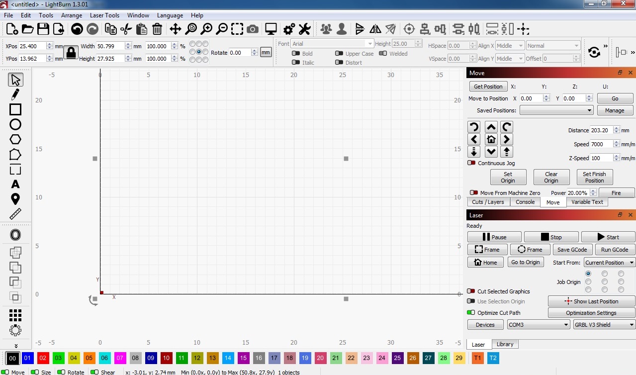

Trying to figure out why one of my machines is placing objects outside machine boundaries when I use the move to tool. The problem is on a machine running Windows 7 32bit with Lightburn 32bit. The problem is if I use the Move to tool to any corner other than origin (Lower Left) it places the object slightly outside the machine boundaries. More so to the right on the X axis than the Y axis but both are outside a bit if placed anywhere other than lower left. Below are the distances outside the machine bounds I’m seeing at each corner. My other install running on Windows 7 64 does not have this problem I was wrong both systems exhibit the behavior, I just didn’t realize it since they are connected to much differently sized machines and is not as obvious and not sure what I can change to fix.
ETA 3: I’ve since found both my systems do exhibit moving objects slightly out of bounds. I just didn’t notice it on the first system with a 12.8" x 8.8" workspace as it only moves objects out a little over 1 thousandth of an inch. On the system I noticed the problem it has a 19.366" x 38.902" workspace. I tried Lightburn 1.2.04 but had the same results. After messing with workspace size I found if I reduced my workspace size to 15" x 35" objects are not moved out of bounds.

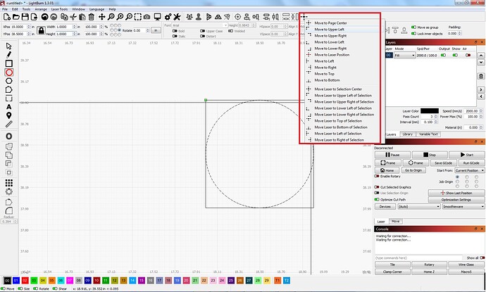

What is the “move to tool” and what steps are you using to do this?
Also, what is the object that you are trying to position? Is that a rectangle created in LightBurn or something else?
Can you upload the .lbrn file where this is occurring?

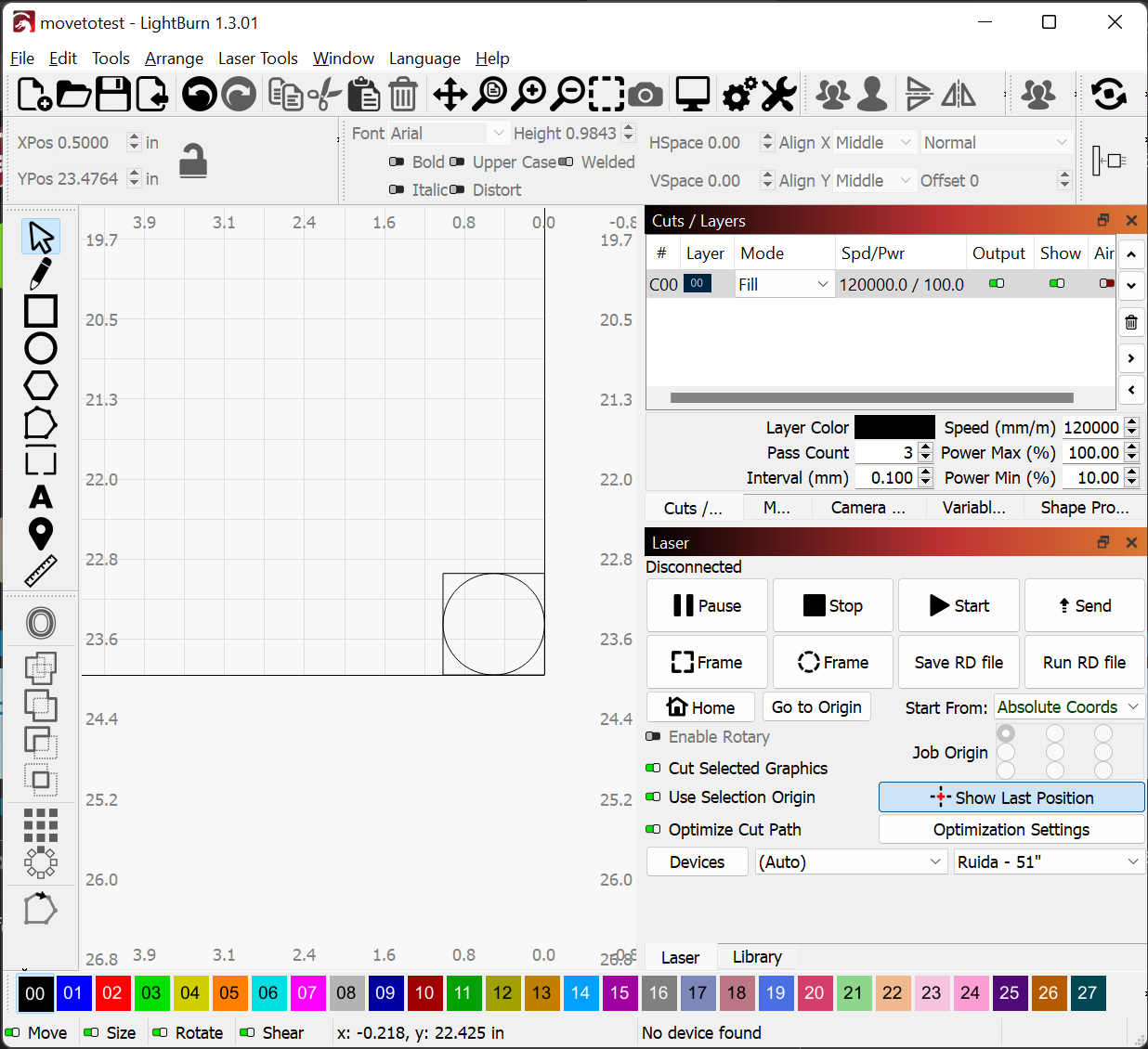

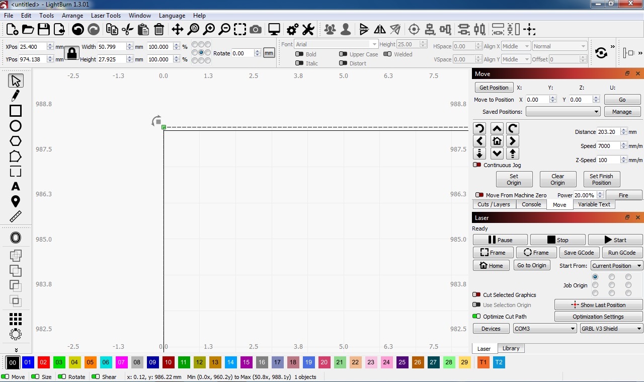

Well perhaps I’m calling the tool the wrong thing I’m not sure. But in red is what I’m talking about and it can be any object but I’ve been testing with 1" squares to make it easy to see how much out of bounds the object is moved. I just quickly setup this on my my main computer with a workspace of 19" x 39"
movetotest.lbrn2 (13.7 KB)
Got it. I thought that might have been what you were referring to but wasn’t sure and didn’t want to assume.
I can’t reproduce your results and placement works fine for all corners.
However, I’m using 64-bit LightBurn on 64-bit Win11.

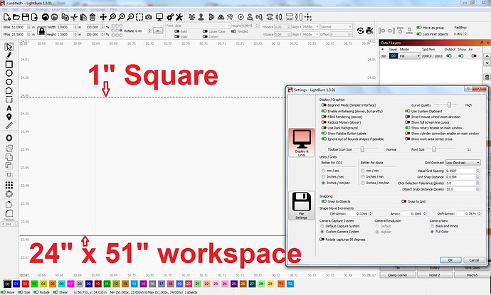

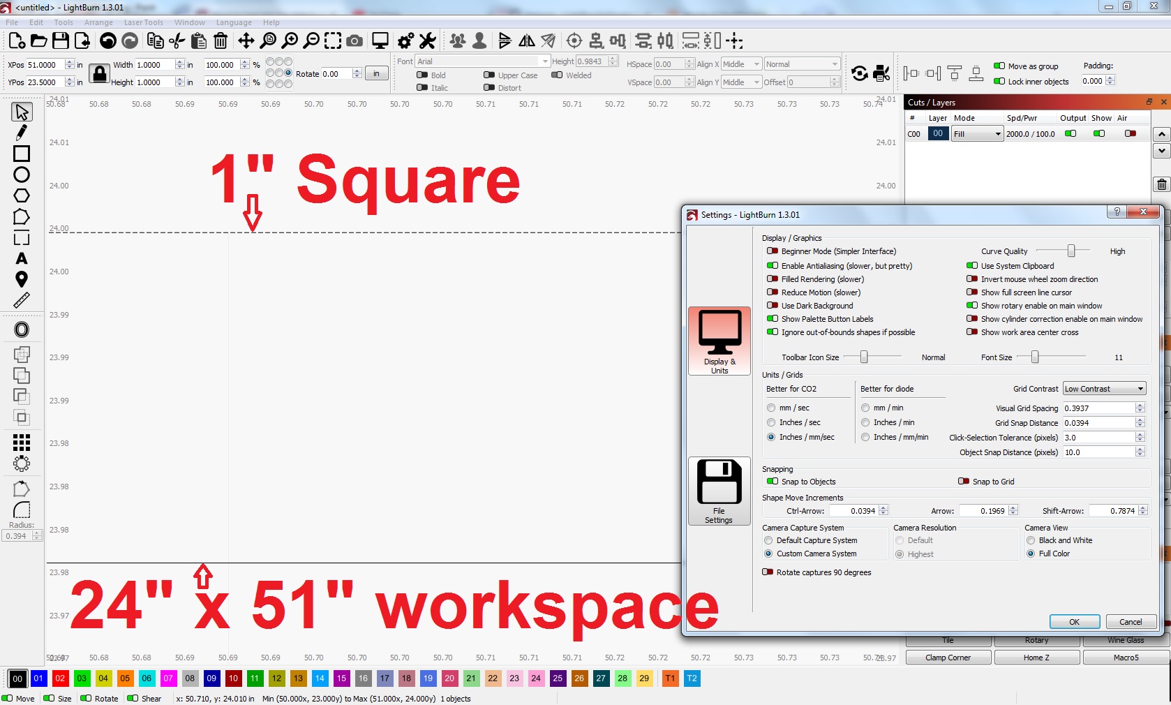

Well I think I’ve been wrong all along. Setting up my machine to 51" x 24" as you had and then zooming into the object corner (upper right) It looks like the object is being moved to the correct location but the workspace is not actually the size of 51" x 24". IDK tired but this example it looks like the workspace is shorter in the Y axis by about .0236" and .0158" in the X axis than what it’s supposed to be. So about 15 - 25 thousandths off. I’m thinking just the grid is not working right for me? Thinking positioning would be correct if this is the case? IDK I don’t really do much that needs that close of precision just my OCD when I see the object out side the workspace when I move it.
I don’t see a meanginful difference in your settings vs mine. I have different Click-Selection Tolerance and Object Snap Distance but I can’t imagine that having an issue.
