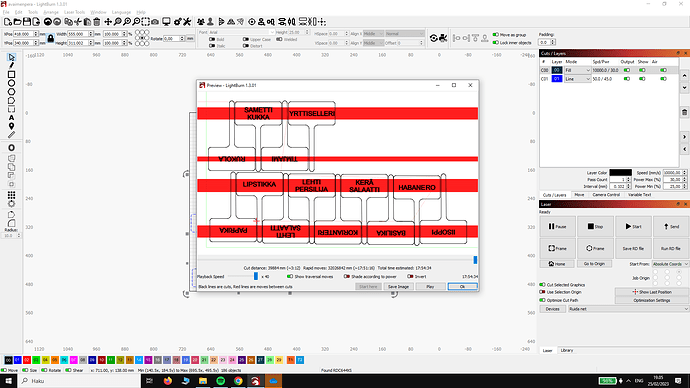

Moves between cuts are edge to edge
Hello, I’m a newbie here. I’m having a problem where on fill mode the laser moves completely from edge to edge. The cutting time is also very long (almost 18h). The long time is most likely because the laser moves edge to edge. In the picture I have many signs but the problem still happens when I only have one. This is my second time trying to cut something. The first time worked fine and I didn’t have any problems. Anyone know how to fix this?
Slow down the speed of the cut setting. Counterintuitively, this is likely to speed-up the plan time.
A few reasons for this:
  1. You’re likely never actually reach 10,000 mm/s but the planner assumes this
  2. This is causing excessive overscan which is why you see the laser going edge to edge
