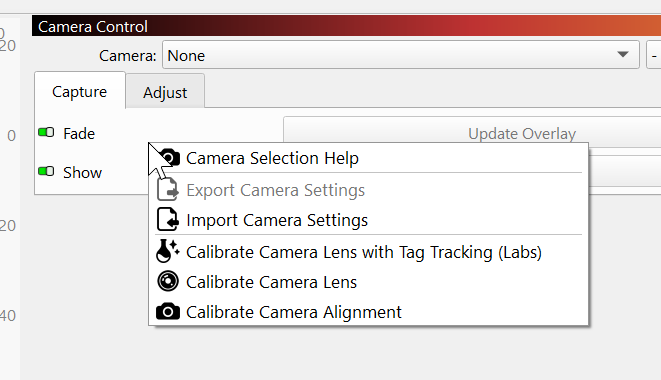

I have purchased a new laptop and I need to install Lightburn and all the fun stuff with removing/adding machines to keep things going. However, I am curious if there is a way to save the calibration info so I can transfer that as well. I know I can rerun the tool, but IF I can just copy and past to new computer that would be great. After all the laser will be the same as well as the camera, just going to a new computer home. I have also asked this questions to the Support@LightBurnSoftware.com, But I wanted to check out the community in case someone knows if this is possible or not. Thanks

User Bundles are what you seek.
Yes, just right-click in the camera window, then you’ll get the option to save the calibration:
This is also handy if you use different calibrations for different heights, for example.
