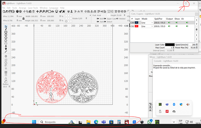

Hi Steve thank you for your help, I will show how I see my Ligthburn screen, my monitor is an ARZOPA A1
 ![Not showing collor pallet](https://forum.lightburnsoftware.com/uploads/default/original/3X/9/9/99fabca483c841440cbe4b90f3b004e318e044b3.png)

Maximize your window. See instructions on image.
 ![99fabca483c841440cbe4b90f3b004e318e044b3](https://forum.lightburnsoftware.com/uploads/default/original/3X/e/3/e320010bd181da15169b4991c5f8df3b6dcff52c.png)

As previously stated, it’s hidden behind the Windows taskbar. Hit the maximize button and you should see it:
 ![image](https://forum.lightburnsoftware.com/uploads/default/original/3X/8/8/88c2eea195e1d416452a52d5a82eadc22e597c7e.png)

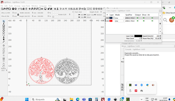

Hi maximized and hideen task bar… still is not showing my color pallet
 ![Not showing color pallet](https://forum.lightburnsoftware.com/uploads/default/original/3X/6/0/60a2cca129374ee55fe395a3f78651b6d73f2b4d.png)

Now that you can see the whole screen, go back to window menu and click on Color Palette. It should appear.
If it’s checked already, click reset default layout.

Tim GRET it DID work I see it now. I very much appreciate you help and the help of the rest tryingo to help me out! very best regards Héctor
