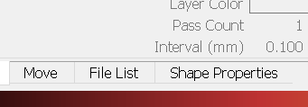

I cannot find the gamma option under the tools properties and it will not come up. i don’t know if there is something else I need to be looking at so that I can get a darker print. thanks.
Hi, if it’s an ‘image’ it should be in the ‘shape properties’ pane

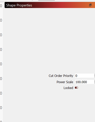

thank you for your response. i have attached an image of what i am getting when i do what you mentioned in your response. And it is am image I am trying to do an image.

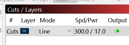

Hi, on the ‘cuts/layers’ pane does it show as ‘image’ or ‘line’?
is a line that appear under the “cuts”
Is a line that come up.
I don’t know. i am new to this and might have done it in error.

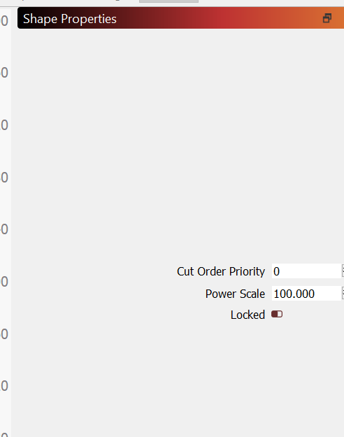

the image that you are looking at with the 11 is from the other individual, mine is the the one with the shape properties and it has power scale 100.00 sorry for the confusion. I just can’t get the gamma option to come up from the instructions previously referenced from Kris1. thank you
it was a png file. should it be different type @anon88048707
If your Cuts/Layers window is showing ‘Line’ when you select the shape, it’s not an image, and therefore won’t have a gamma setting. Can you show a screen shot of your whole LightBurn window?
