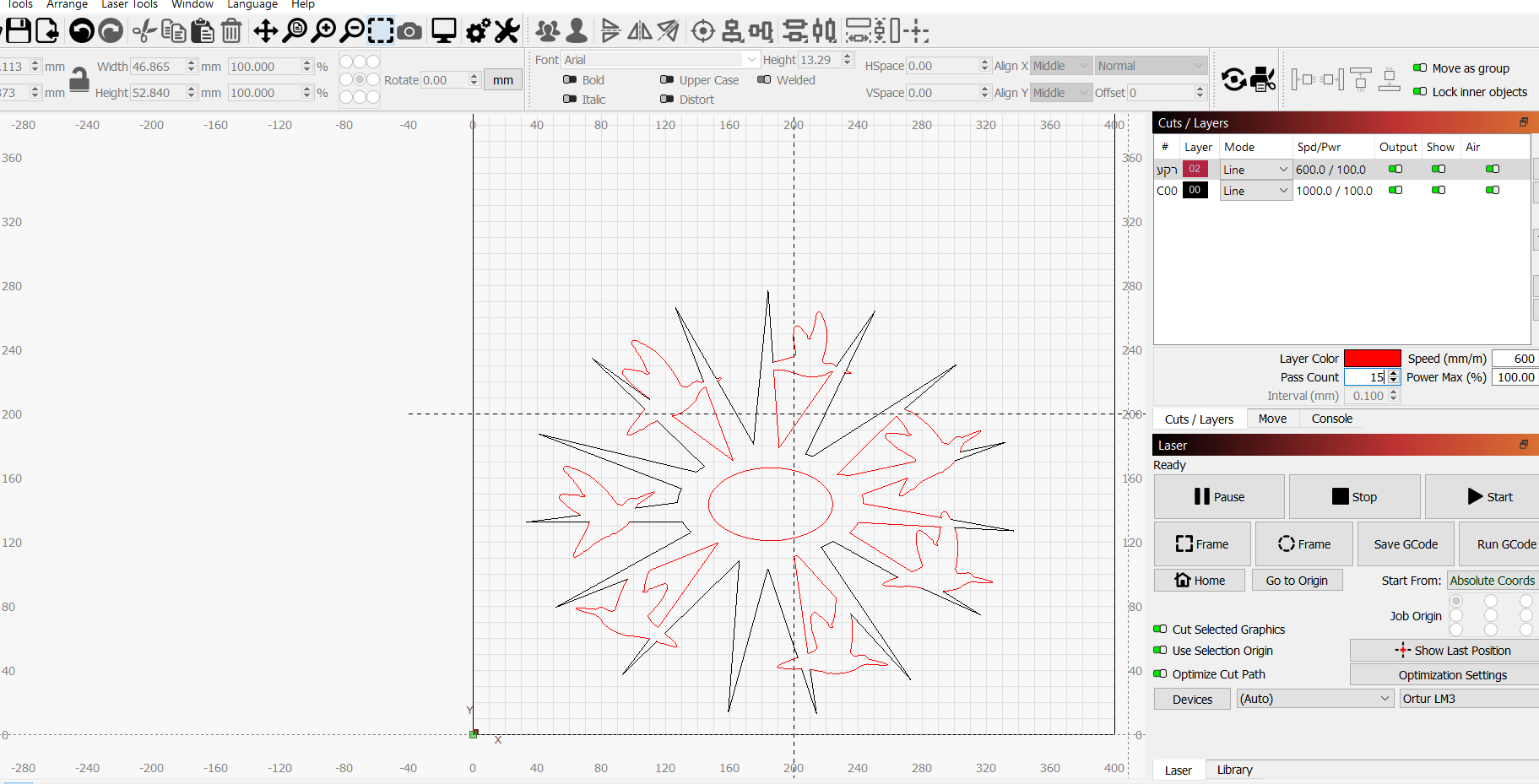

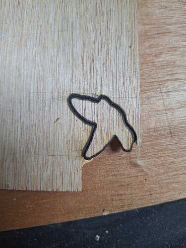

Well this is either strange or maybe a defect. I tried to run on cut 100% power 15(!) passes and 600 speed, and itโ€™s not completely cut. Whatโ€™s wrong here?
How is your focus distance set?

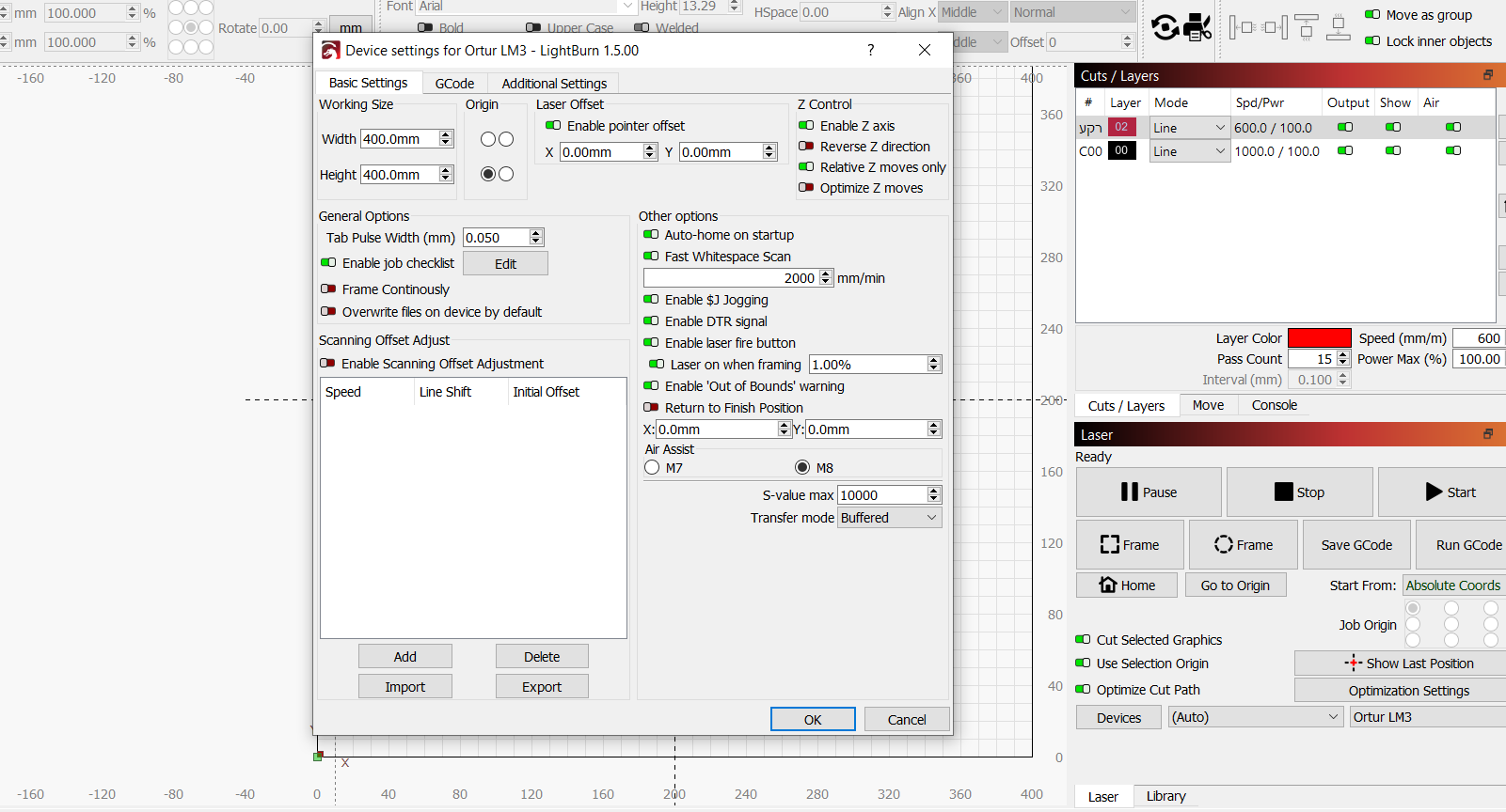

Please SHOW us your settings window
Please SHOW us your preview window

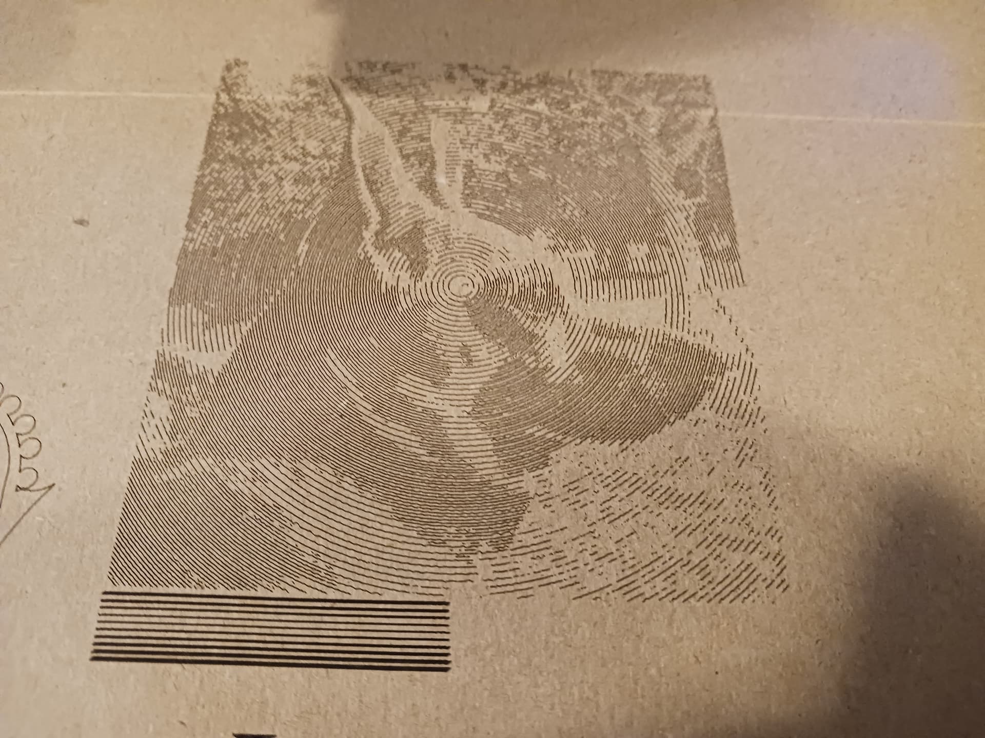

Note the parallel lines pattern under the engraving of my dog in the photo below. You may, or may not, have a fully implemented Z-axis as I did hereโ€ฆ but this demonstrates how the line thickness varies on either side of best focus.
In this 10 line gradient pattern, each line is 2mm different in Z than its neighbor to either side. So over the 20mm range from โ€œtoo closeโ€ to โ€œtoo farโ€ you see the line thickness varying with focus distance. To find best focus from this pattern (drawn bottom to top), I count lines back to the finest/thinnest line and multiply by 2mmโ€ฆ and then lower my Z-axis from its finish position by that exact amount.
