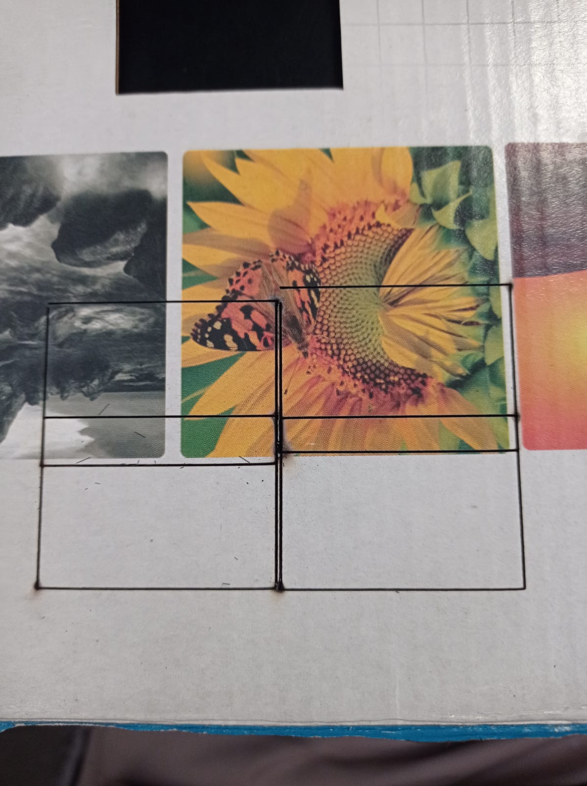

my laser cutter that should cut a little above invades and cuts the figure below the machine is a Laser Master 2pro s2
If you’re willing, please attach a picture of what you have engraved to help us see what you are seeing.
Looks like maybe a loose belt slipping.
Inaccurate travel on one axis, and good on the other.
