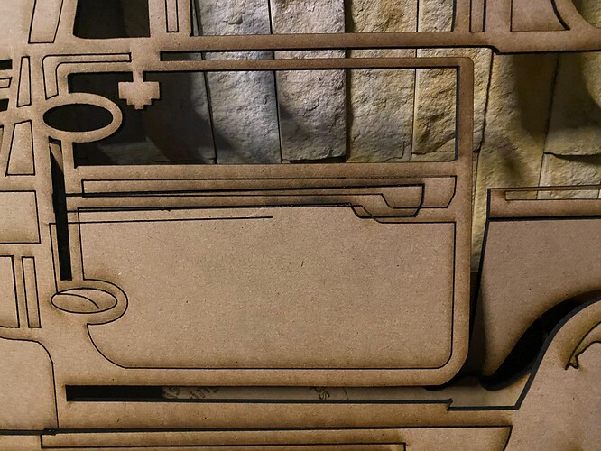

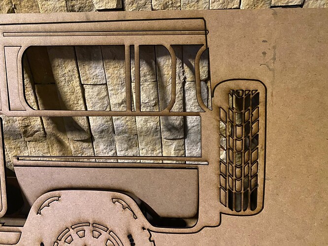

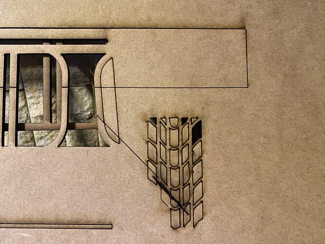

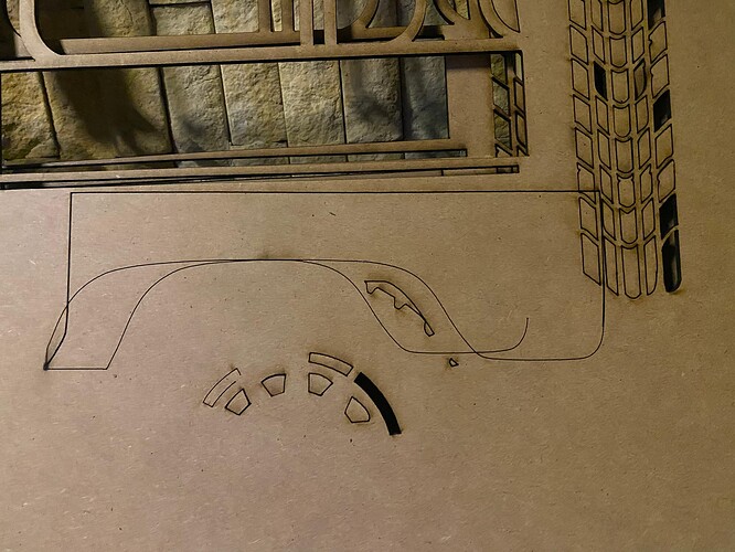

I have a laser tree K60 machine I’ve had it for 6 months, since yesterday my machine cut up to a certain point well, but suddenly the machine starts to cut where it already passed and ruins my work or does things that are not in the design, I mention that I have already made 3 attempts, the error is constant and similar at the same point, attached images, mechanically I do not hear noises or bumps and in the preview looks very good, I do not know what happens
It looks a lot like your laser isn’t turning off during traversal moves. We have a guide for that here:
Fix this by typing $32=1 in the Console window and pressing Enter.
thanks I will try this for the issue of the laser shutting down during moves, but do you know why it is cutting me in other parts? the preview window shows me that everything looks fine but at a certain point it cuts where it shouldn’t and ruins my work, mechanic or software?
it is like when the material moves but it is not like that, I have already checked that my material does not move, I am waiting for a solution, thank you very much!
