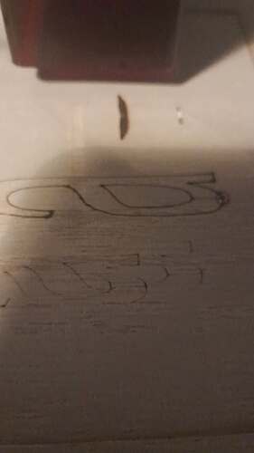

Genmitsu GRBL Control Board for 3018PV2 board on yesterday My laser is engraving random shapes just looked cant see if anything obvious im not that good at this stuff I just draw a Circle I get a LIne ,If I draw a Sqaure I get a Long rectangle it’s not on rotary I have checked ?
It sounds like you haven’t set your board up and Lightburn is sending commands, thinking it’s still working with your old control board.
I reset lightburn altogether unless it picked something up the circle and square i used off lightburn i have my chip pan on at the moment will be back in a bout half hour.
I have lookedI, downloaded everything again, and this is a letter A. Did it come out on its side and stretcherd?
What I meant to ask was if you had properly set up the board’s firmware settings on the board itself. I am not familiar with your specific board or its default settings, so I’m not sure how it comes set up from the factory, but it possibly needs to be reconfigured before it will work as expected.
It’s been a while since I built my machine, but I believe that I needed to connect to the board with a different piece of software to set it up before use.
The Board is brand new to me as in last night ,Just looking at some videos now Sainsmart which is Genmisti I seem to have done everything right but one is saying download everything again incase its a dodgy like ch340 driver ?
This is the second time someone had mentioned parameter settings for your board. I recommend you go through everything setting it up before trying to make parts.

Hi Mikey thanks a Iot i managed it after a couple of days It was the X and Y calibration not had a lot of time 2 myself glasses breaking and Boxing stuff to move house <its good that people like yourself point others in the right direction in a way once u have fixed the problem it might seem obvious but its not it will help in the future as well also to make it easier went on You tube I guy you might know of called James Dean to see it being made it even easier Thanks , Pretty soon this thing will be getting packed away moving to hotel while I have building work done so cant tek it with me.
Thanks to everyone that helped with this problem solved :slight_smile:
