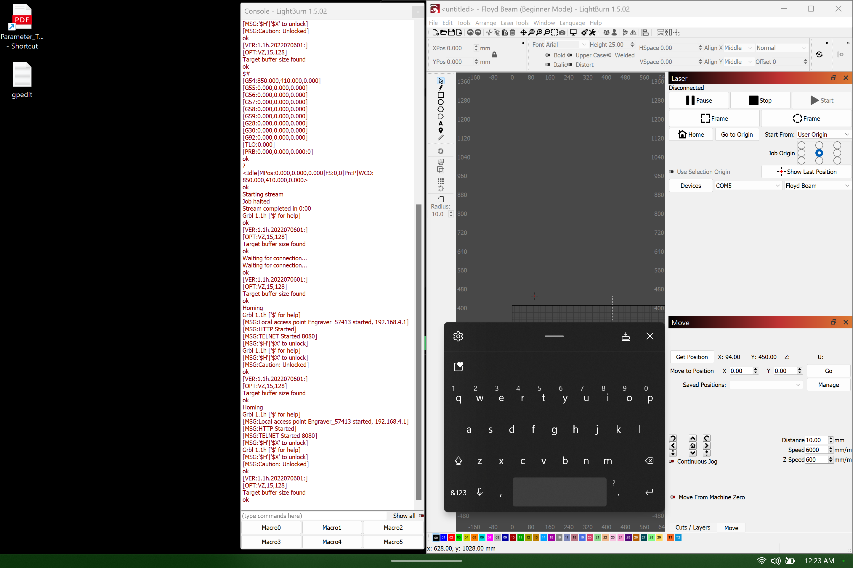

I’ve been beginning to work with my laser and it’s been fine until I put on my rotary. I didn’t change any settings but no matter where I tell it to go, it starts going towards the back right. Screenshots attached to help find a solution.
You have a work offset configured that you likely do not want.
Unless you did this deliberately I suggest you remove it. Run this in Console:
G10 L2 P1 X0Y0
Then home and retest. I’d also suggest you work in Absolute Coords as the Start From mode in Laser window until you get very familiar with your laser and LightBurn.

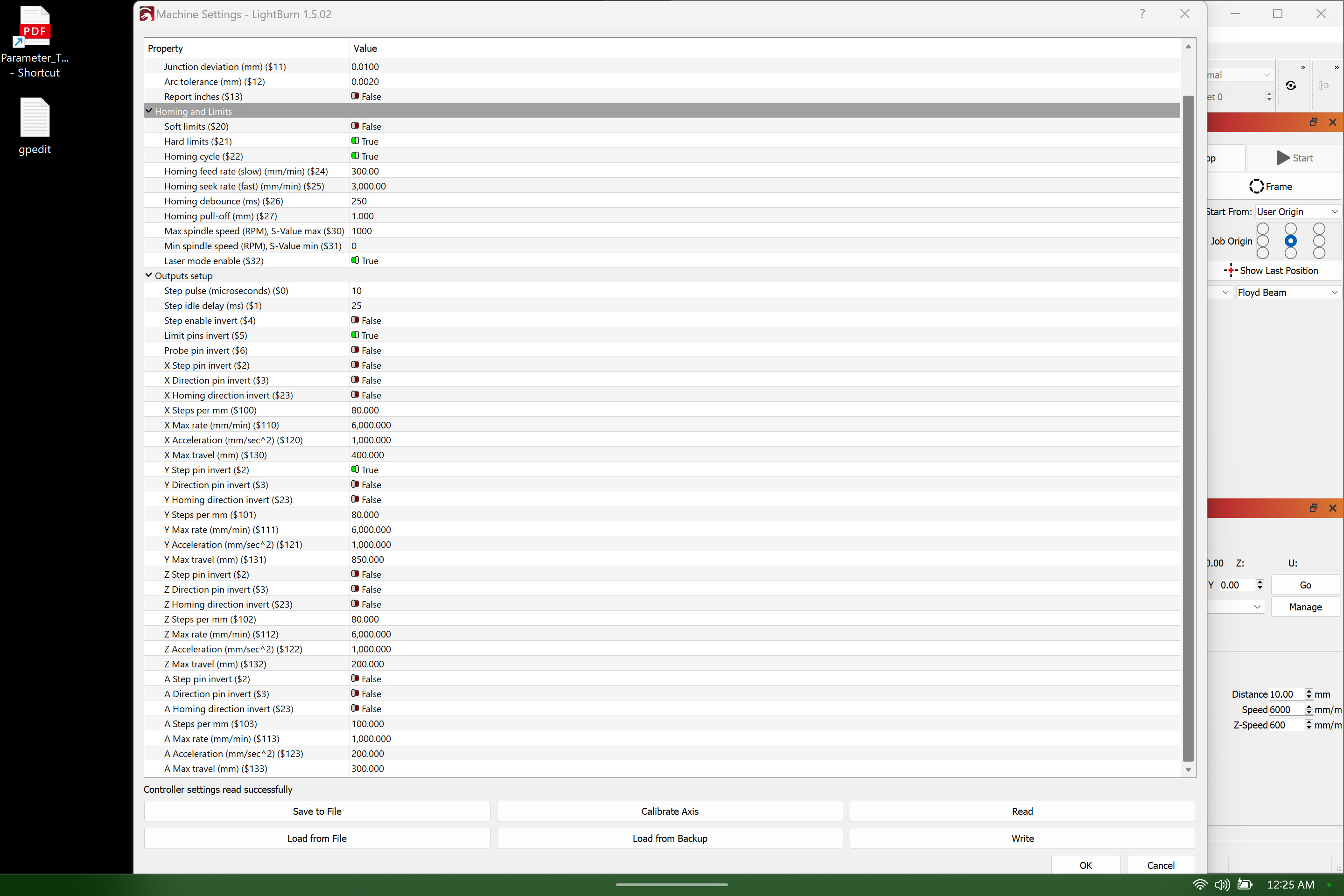

This is also the X, Y coordinates for my laser after extension kit. 850 mm Y axis, 410 X axis. Is that why this shows?
