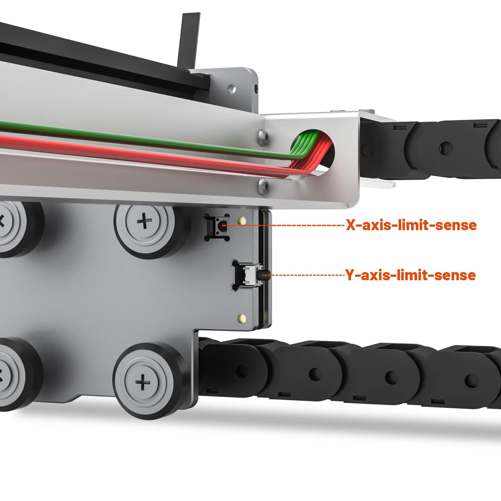

Just went to neje website. They hide the limit switches pretty good. Look on your gantry for this and let me know where they are located. Is the Y switch pointing toward the front or rear & is the x switch on the left or right?

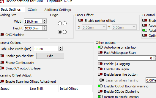

So it looks like this machine has the home in left rear. You need to make that change in lightburn. In mchine settings (wrench & Screwdriver icon) set the origin to left rear. Then try homing.

So by homing you mean just press the little house in the move section right?
<div class="post-metadata">
**Author:** ![Amazinggiantflowers](https://forum.lightburnsoftware.com/letter_avatar_proxy/v4/letter/a/cab0a1/32.png) [@Amazinggiantflowers](https://forum.lightburnsoftware.com/u/Amazinggiantflowers)\
**Post date:** [February 10, 2025, 8:20pm UTC](https://forum.lightburnsoftware.com/t/my-laser-losts-its-coordinates-i-have-a-neje-max-with-extensions-my-laser-is-at-0-0-position-but-in-get-position-it-shows-x-1432-y-484/164802/35 "2025-02-10T20:20:47Z")
</div>
![imagen](https://forum.lightburnsoftware.com/uploads/default/original/3X/8/9/890ff823193b17f0c12533e7f83993782dd3c217.png)
so, where it says origin, I just highlight the back left button? and then hit the home button?
**Author:** ![thelmuth](https://forum.lightburnsoftware.com/user_avatar/forum.lightburnsoftware.com/thelmuth/32/73307_2.png) [@thelmuth](https://forum.lightburnsoftware.com/u/thelmuth)\
**Post date:** [February 10, 2025, 8:21pm UTC](https://forum.lightburnsoftware.com/t/my-laser-losts-its-coordinates-i-have-a-neje-max-with-extensions-my-laser-is-at-0-0-position-but-in-get-position-it-shows-x-1432-y-484/164802/36 "2025-02-10T20:21:40Z")
</div>
> [@Amazinggiantflowers](#):
Correct, then click ok. Click the home button in the laser panel.
**Post date:** [February 10, 2025, 8:23pm UTC](https://forum.lightburnsoftware.com/t/my-laser-losts-its-coordinates-i-have-a-neje-max-with-extensions-my-laser-is-at-0-0-position-but-in-get-position-it-shows-x-1432-y-484/164802/37 "2025-02-10T20:23:26Z")
</div>
went to the back left without grinding. Really smooth.

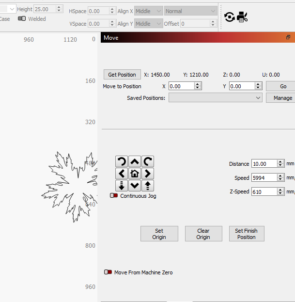

**Post date:** [February 10, 2025, 8:35pm UTC](https://forum.lightburnsoftware.com/t/my-laser-losts-its-coordinates-i-have-a-neje-max-with-extensions-my-laser-is-at-0-0-position-but-in-get-position-it-shows-x-1432-y-484/164802/39 "2025-02-10T20:35:47Z")
</div>
![imagen](https://forum.lightburnsoftware.com/uploads/default/original/3X/e/3/e34348869442668e4d1c55396e10da8bd60671ad.png)This is what it gives me
**Post date:** [February 10, 2025, 8:40pm UTC](https://forum.lightburnsoftware.com/t/my-laser-losts-its-coordinates-i-have-a-neje-max-with-extensions-my-laser-is-at-0-0-position-but-in-get-position-it-shows-x-1432-y-484/164802/40 "2025-02-10T20:40:40Z")
</div>
In the console enter $10=1, then move the laser away from the corner and home again. Check coordinates.
