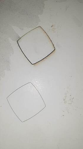

My laser not working correctly with lightburn
my laser atomstack a5 pro + works great with lasergrbl but acts weard with lightburn

Grbl 1.1f [‘$’ for help console from light burn
Can you be more specific about what your laser does vs. what you expected it to do?
the lines when engraving ar too far and instead of a circle it draws some kind of square
Provide a screenshot of LightBurn with your design and a photo of the burn.
this is the projest
this is what i get with 150 and with 1000 speed
Do this for me so I can check some values:
  • Run LightBurn
  • Go to Help > Generate Support Data
  • Right click in a reply here and paste the data it copied for you
AAA4XnicvVtbc9u2Ev4rHj61c5yEhChK8tOx5Th2R649luLY7WQ8EAlJrCmCw4ttNZP/3l1cSFAXG4l6jqZpyAWwN+wuPhDIN2daxUnkHH1zIloy58iZVOyAuIS88+C/zsF/Dzz3qNNzDp0nlhcxT6GL977z3vWc74dOEocsLRgODxePp/Fs5hy5h84jW93SBHo6dZeHiK4K0ViUtKzgsXPolHQOD386QRAMAhJ0e8T5agjyQUKWs1mB/I+jv6qivFjOr3lx5xy98w5bpPs10jj+m613Q5rul8Tz9FzoIx5vnSMCj2m44DmQPf18q57LmCYxLeJ07hyVecWAVpV8uGDh4xnPP2fovMJsGtMnNmYhTyMgewTknHCenLMka/Q3KEqtk1VGi2K8Kkq2PAWRHP0zo0kBXId0yXJ6w8F9bOA2ZHDw45glE55Acxoy4dkhT3guR9zG7FlrNuRpmfPkkj+xizTM2ZKlpbBwWJWjuIDnP2Emc14U57QMF3pYxK+qMqvKWmjEy3FGQ+EOMC1OI/Yinpb05Zo/sxyYusYrAffia5yqVvK+e+ikoB8EydnBCYUYOnQ4znxI01pMkTEWqc4lnQ55pdTVL5f0Rb/X+nTd967vwm/gdbuk1/F9aF9lKAmshKj9tkN9D/VNK5pM6LRxe2NRd9MgZQHwPRjF6VYbcrrMRiydlwshQZkUvA/Er+v2esQd+L1/x8AxSkYLaTpPMBJAx83pVPYSfCpZ/oSpCjy7rvz1/K7b7buBaXt/t+0ucWqzPG2X23H7/U5v8JZZ7XlRinVMyWSn5I9oUiMa4+0nhPl2woauv7+srq2s7rqsrewCO3anjGUH25y1lWnPVseeFbu+Lbu+FbuBLbuBFTvPteTnuXb8PFt+nh0/YsuP2PGzTK2h17HjZ5s93kb2bOdnmyGeXYZ4liky9AI7frbZ4dllh2ebHp5deni2+eHZ5QexzQ9ilx/ENj+IXX4Q2/wgdvlBbPOD2OUHsc0PYpcfxDY/iF1+ENv8IHb5QWzzg9jlB7HND2KXH8Q2P8gb+RHF5YLllzxCYlFW4WMMA6IsBvSCRXHG85AB2obNTloqcS3w5a6Br74nwRfp9H2v323Z/QrwdN1XcPNPorGLJZ2zV6w04bLNUrwjlS3FtDLc/5/CUEuNbGuEu6NGWIr5eWD6Q2L2xaSWYmwLjbuj0FiK2Re9WorZF9VaitkX7dpm8r4o2FbOvujYVs6+qNlWzr5o2lbOvijbVs6+6NtWzr6o3FbOvmjdVs6+KN5Wzr7o3nbJ3Rf128rZdzdgK2ffXYKtnH13D7Zy9t1V2MrZd7dhK2ffXYitnH13J7Zy9t212MrZdzej5HwV3/+v8ngepwIPn96dieONhOPZDuxO3IH89XqB3yfdPqn7nLKSheXnNC7r4w9o+fiS8bw8zkOTqDqB+FOaP57Q8HGeAwqP6m3LKZvRKilBlzErS/Gt+5uxX7Ix1cETo5jncbmSh027tnBa2Cl7ivHMBE9fFOmMp+U5i+eLUqaAQf5dSjnOY9i21S14tPT/UDgBXx/PYNM4ySnqrDwrLKhPb8SZVCLeHMf0qerxtaZNOE/a9LjIErrSRnYPspwf/AeYfEzpNGEjWoD2V7NZwZqTINl0nfOQFcVa26fPF6fAqDuaHHv3fz+ufgdW2rE+GnjOl+wqHZc0L6usHnaRzrhU3pR4J9xjUu41pZQHXfUYnNRRPM1pvrqmeO6C9Ms4z3l+V0uR7/f1u7L6083JCHq3DJKiWyQp+4bhzptdqI38kC8zlha0FKeXiq+KDHmGufXU8YRW0Y04fPW8LkG/AKPlNSQQ6PPLcMEhC391NnKUh49jPAt8OM7Lk5w/FxhoOpPqRu2azQaeFjxpoqhpwJAQzttsE+4/ixNWbOGIp4qbQ8YLmmF8ZCwv463jbimkEwTRhL00sTN+GIcU1cPvIvAaL0HjPIXYb845txcm7HoGQfBlEZdsbH4W2WgZy2TztYRPCZ/S5IyGJc+Fk5F4SV+Ow5Ald6Yumni/RhQc71T+mrR7kxan0hYlXwm6oVkcjY38RyKquSm+prbki7GG9qrg4pOYtjQuFjKWm/f7+l3G1t3aO7ZD8Zmo80WmKt+XOMLE8j33uywcIc2jKwjQ2QmW9ELMelP8ZWExC2uvphoTqsJ6BH8u0rT5ZoZEjK7j4hOsGJlJvqZRpM9xT3M6x5PwRc6KBcdbDUQXqJvJqA4DiN+ERfJYXJNAszP6hGUYtcZiiKQbFrIUXQh1dZaIywpN5ZaLwHfVtYBA58/j8zutXEOcTM5qYg5jH8SyK/3UaCBb0ih+iqOKJsmqPUZCAE+/gquLOILi2fT7lMfRcZ7T1cMJK58ZS4cM61LRlLxdPe639BjmDHLzNobKjF8oN9rvVO3b1jRexLPyZHVOk9nW5kysXl2TeL+b3f3r7O7b7CDw0FEEMbJ4T2km/KZfZDxEptfqk3X8ECIi7GKJ+IVFOoz1yjRPec7EenUxu+SQXjy/mjVayWHncRSx9PhiRFdgkrGsgYXlJa8K9gfny5r+G5/jtYw4rXjV9B7RdF4hOjtyWKqWNSj0G8uaWP7Gt22ChF/baCqPFU3qq/oNjz5g2hcfxrxavPtwyorHkmeq51a5lzRcxCnTK1y7EUr+X4AMdzDnz2nCKcS/7Cwv0AjoAkUF4PMIGhVM0W6U84W14RhAUtgsFSNcIMWFl0vzlsO6dvW1m82G+60NxhWiLS31GBCJSEqoKbRoJvGS0aLKmRTd6fVMCozvdJACdQ1CAIphqYqgWxP1YrD5OVt1+KNeLgDA8HxJ16/2QFZcTf9SSeDWL2tJIDGNXJNkjZMUCTnlQgAW1Xap1jiHaRBYpxlRm9HRpKusjJfgsLUrRKqxggJkVjFJhioOrNdHKEYPx0nCn+uCocbpxpOVodf6yJOVWkBw6gyqmDxpRkO8rnG52VnisdpX6xIAPTXj1lQTGxs0jEWbA6FqMNwTJbRYbLaK5XDChbs2+IoHmnxMS8hQHuO8b+sBD6DBFp2vwJMJzU7FRgBAFVE3gTo90iUDt2N0vWFRFTLw8HABBYptYSZ7wA7liSUbetywJcSnkrdlMNQI7SENdde7AHgLF2uhJ+KkDQw3LzNdIwKhgF0jUC4tZgC/5O5T6nidwz6KPcsqbUyQouNolWzvOg1VZLZPXJOCmAw/ASiKgHUS3wtwr8hioYIgkxvEtjCBGtCDeSHSrqWhKks9vPZlkEBqtyukirqL9w9v9UVKiN8bGgFcwSUzefiIVvdQaZMqljW5rampq4ffq+WQZwK4++0WeRNRN0oVzXaYS7FoFRJl1F0EplJ7iD93LgwffP99Ms1T/CK3sw+oPJsd4BVK0fe1rucMrDvhLwe/eL++zVj3Vj2/otoY1pe8vbc7v2sWPfQ4ItBzmkYJE1ubJsKx8Tc+HfH5OknG+TVec51wNXmtPjIhQOyuPqJ9HbFIZwvotLYk4LxjgB0nNF8SdF4zOUiX0zXEW4ONDKRzqEFCkREvSj3O7LBK8NsHLIK5ys6r9JIaOYydzqokAbyVDqu84O3xYnMJ+RNLHzcajeQVYkAwkPaR2XINW8SyhDibsqQwGzA489UW+V/itEO+0Dw1rvLC3ilLmETYumuVCSinPwMB5Wk+CMQBvxyEa/5JVZY8xewTXdofVGDLkIudguy/iA32+iS52U1M8BO3+uCDfMTXv7cZeA0Dss4AonaCe5RT/KQzl2sehLv+IiQ+DAxpVgIeqfl+RjfD9MNyjykq7yCbrZ9YgQMKk3YOTmL6K8xNE31YzcVV5mESZ1MOO0TdArMQ8eeLAnbHoqqvNWis1gkCg6TrqiSoMujBAmWSoFNv4NWUUl5ql2vBbKYWBXcWqQfi7vjNwrrNm03Vg++6sON1oXTCugLPRD4HwLfXgz8deO5KWs1H/eRbONMUzVv+f9pT2swMuQSe5RrWUX0DpUZHjvP8Ga3t0KN6WlsXRge+1AxGuL2u1LqnRm9o5xFWU7TFQPEjZWEgrfORr9e2tgsygoGUF/QU3d8lx92UQ6WOKCdgijc+h5LXD/F36WCdPwkUfxgRRI3e+N6S6zczirJ3yN0xu31/Q6673V9+oPgq+7Dtx2RF0YYs6NsNlCyieKG9xPCjr/j2Je8fk0k7GzJh3rpoV1/JdZUc18gMt7EbeQt5P2UzDWuKzAyvF6mI0pmB7/1WZrhGPunMYEZmbM7OK1EL2bU+u0ZmCV4D6XEdXcLqwY9mSKffqhOd7lQJ1HXDX/u7r//WNcM1vNjygopy1FFEw6yJdvBBZ7vn139e0HDxSZvLTq5g1etcax217oauugoFfh09O7J/4xeucfHUTDDNwadvWEsNDnpO1fxi1dDzqSuLqiSSOwm9f4e7iK5ZQ7O0XvtUzaxneoPJ2G1VRPQM9PW7yteDN1aNV/29Vm+UR0jwhkeIoaOOJszPaT1z6AHJzafdN/TRMa309/oGdyN7sWYJn+ua7Kt+3bctB+hVqY/t3w+dQoAePPChOX6Pcl76wUOAZ/HiH9s9rFMfAW/hZtl5jlNA6JrwYPyLO9jRvidESlKATyKc4sBzYU8D7XhExIvWIDz1BdwP4FngUQmrcAsqwJQ4NZAgKnDVC5DBwYg9WxjMQF96iKBrxBX0EW0q9PksFXO+f/8HQLc6hw==
I don’t see anything horribly wrong there - when you preview, does it look like a circle?
You said it works as expected with LaserGRBL - Have you tried running this exact same shape (a 10 mm circle) with LaserGRBL?
yes i did and i engraved the same pic and it works as expected
Can you take a screenshot of Preview for that circle?
Also, can you push “Save gcode”, save to a file with .txt extension, and then upload the gcode file here?
