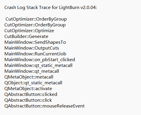

Today, a pop-up warning appeared. It generated a text file on the computer. The content was as follows:
Below is the entirety of the content within the text.
Crash Log Stack Trace for LightBurn v2.0.04:
CutOptimizer::OrderByGroup
CutOptimizer::Optimize
CutBuilder::Generate
MainWindow::SendShapesTo
MainWindow::OutputCuts
MainWindow::RunCurrentJob
MainWindow::on_pbStart_clicked
MainWindow::qt_static_metacall
MainWindow::qt_metacall
QMetaObject::metacall
QObject::qt_static_metacall
QMetaObject::activate
QAbstractButton::clicked
QAbstractButton::mouseReleaseEvent

Are you using a mac? Could you tell us what your MacOS version is?
Well, I’m using a Windows operating system.
How should I proceed?
It was working fine just now… After closing the software and restarting the computer, Lightburn won’t open.
I’m currently trying to reinstall Microsoft visual c++, hope that helps!
Haha, it actually worked.
LightBurn is back.
