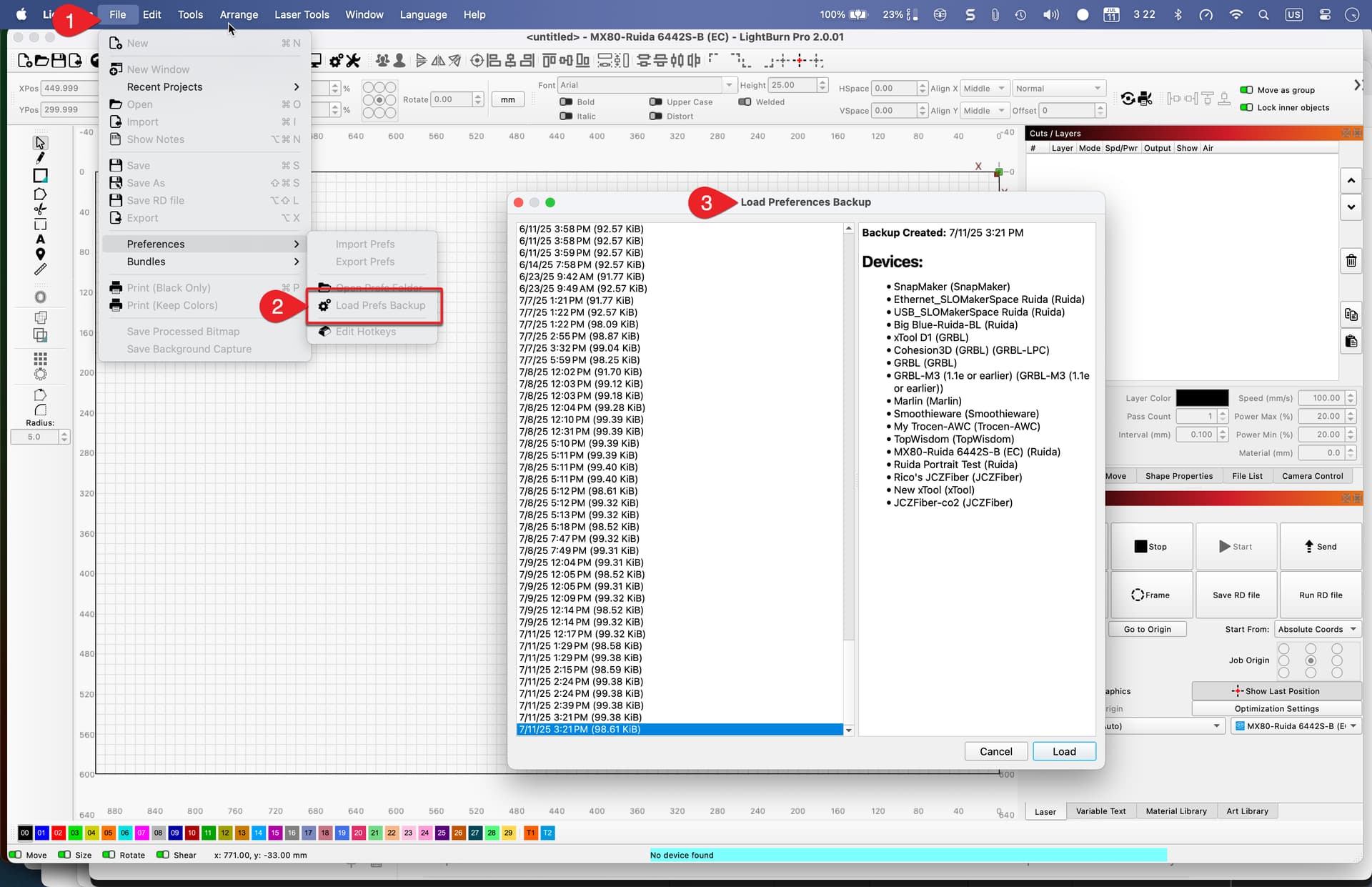

You can also use one of the Prefs Backups. :slight_smile:

Late! But thx. When I have free time and I’m not working, I’ll give it a try.
