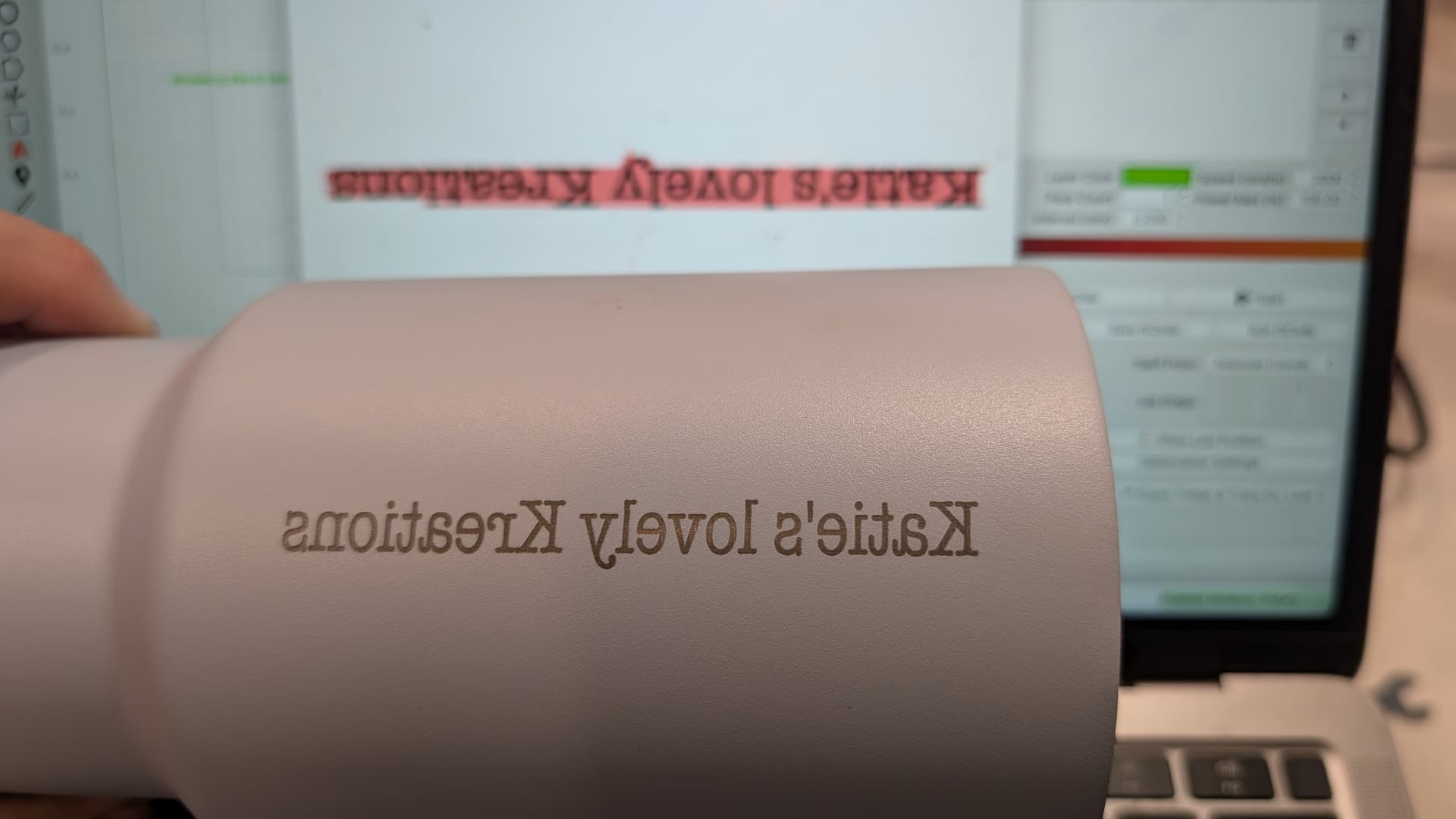

My text engraved in the right direction, but was mirrored
Please see image. The text engraved in the right direction but was mirrored.
Try the “mirror output to rotary” switch in the rotary setup.
