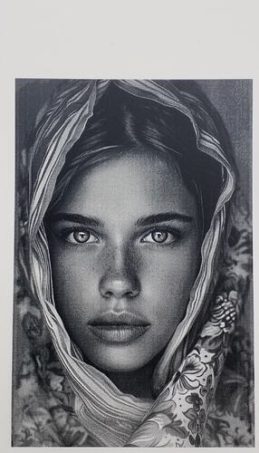

My work from the last time

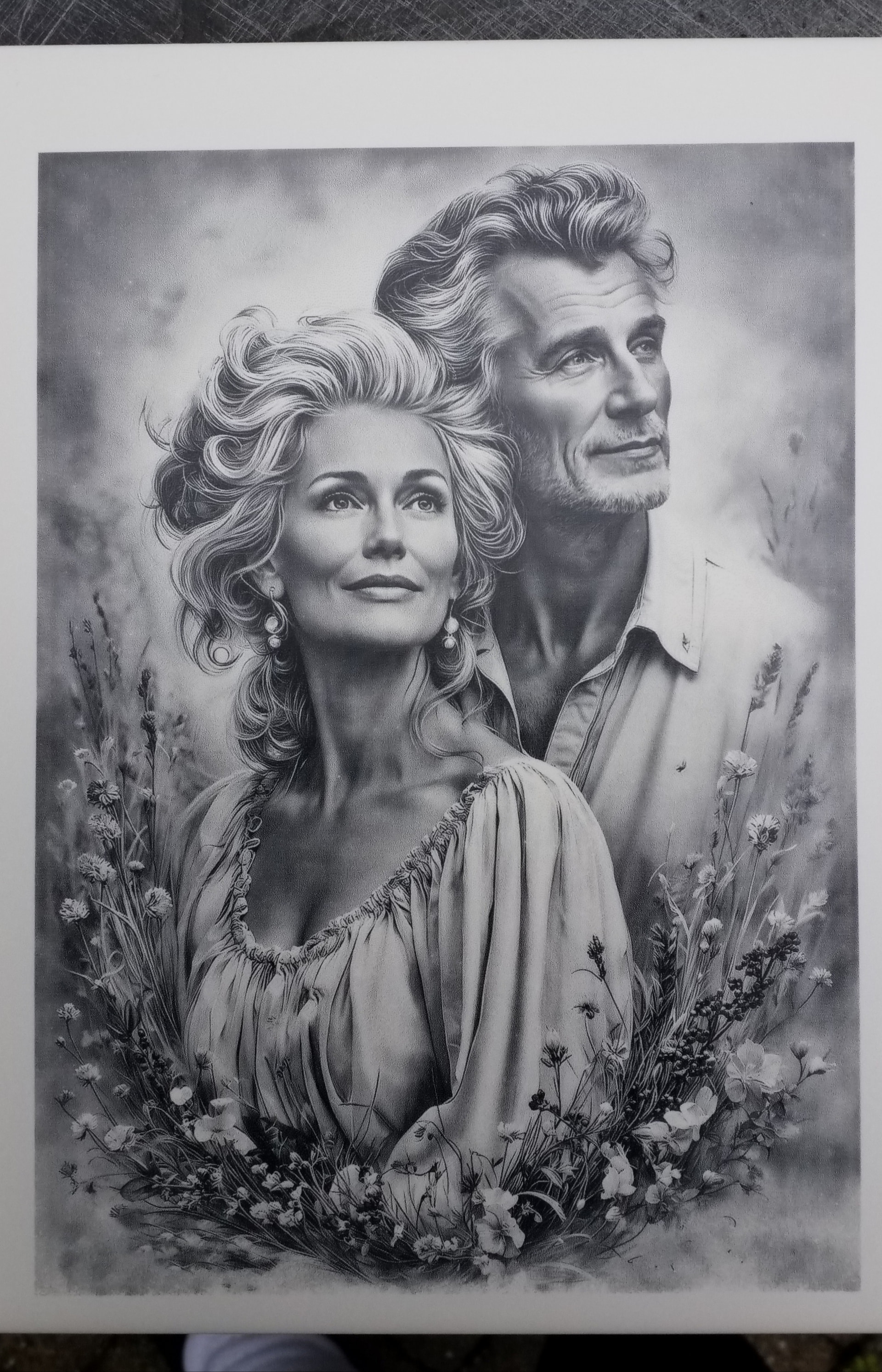

I would like to share some of my recent laser engraving work with the community.
Most of these pieces were engraved on ceramic tiles and paper.
For all my engraving workflows I use LightBurn, always with Passthrough, because that gives me the most consistent and detailed results.
I don’t want to come across as advertising or spam — I simply enjoy creating these pieces and hope they inspire others in the community.
If you ever have questions about the process or settings, feel free to send me a PM. I’m always happy to help

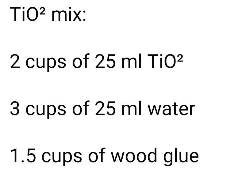

What kind of a mixture of TiO2 do you make? Do you mind sharing?

Simpel did receptje.
I don’t really follow your formula description.
What exactly does “2 cups of 25ml TiO2” mean as far as physically putting the formula together?
Last thing I need it 5 cups of this stuff, it’ll be draining out my ears. :face_with_spiral_eyes:

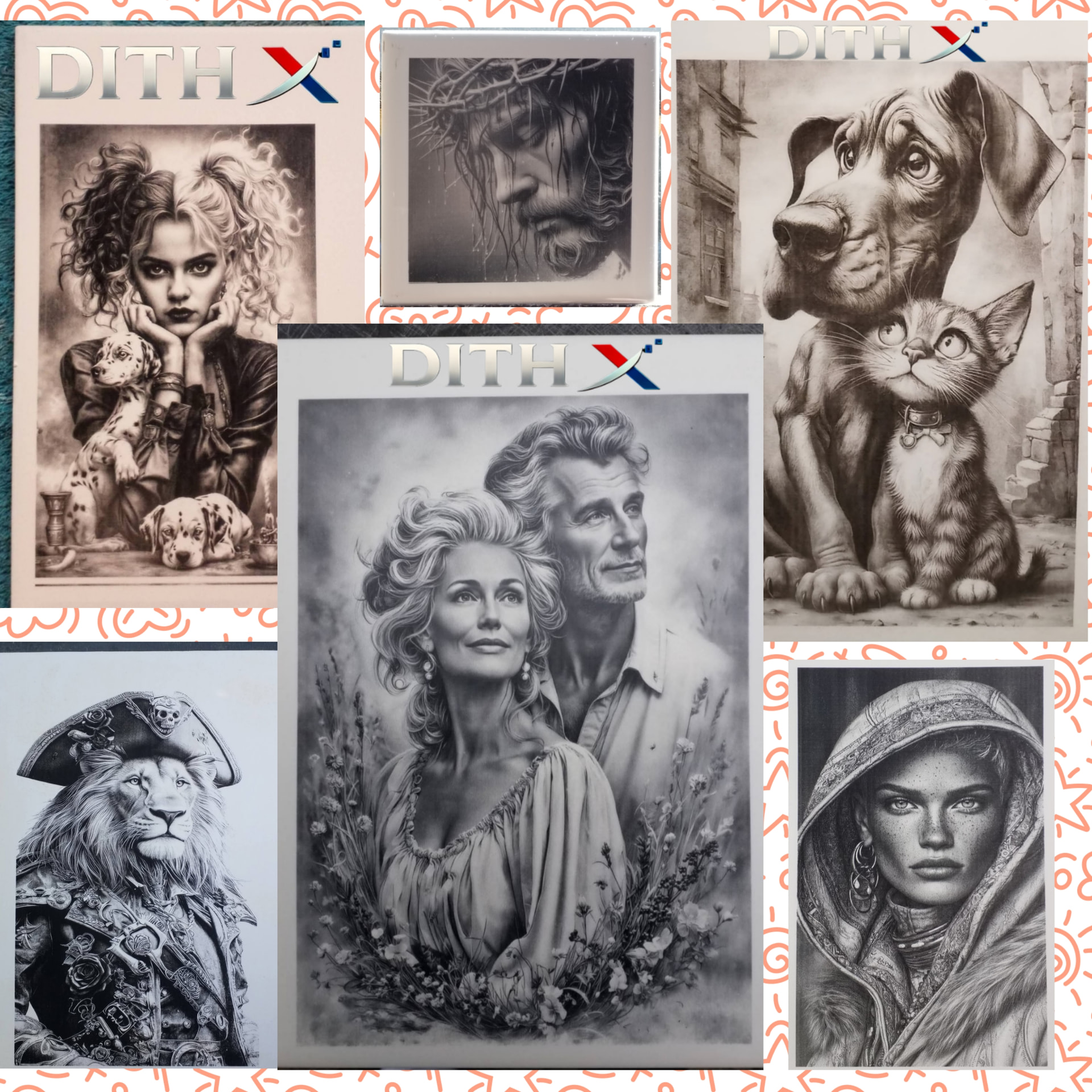

I enjoyed your work and especially like your Captain Lion. Good work
I’m kind of partial to the dog/cat version.

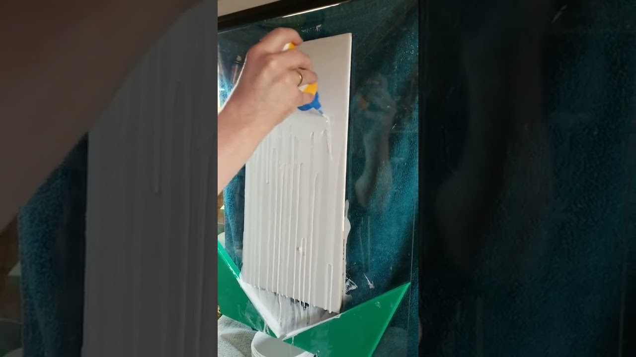

You end up with a mixture that has the consistency of thin custard. I let the liquid run over the ceramic tile and drip off, so it forms an even layer. Then I lay the tile flat and use a hairdryer to speed up the drying process, so you can start laser engraving right away.
When you laser it, the TiO₂ powder fuses with the ceramic surface. It becomes permanently locked into the material and will never come out again. This technique is also known as the Norton White Tile method. In that method they usually use spray paint from a can, but that contains far less TiO₂ than when you use pure powder and mix it yourself with water and wood glue.
The wood glue acts as a binder to help the mixture stick, and the water is simply to get the right thickness. This gives you a consistent coating that reacts beautifully during engraving and produces a strong, permanent black mark.

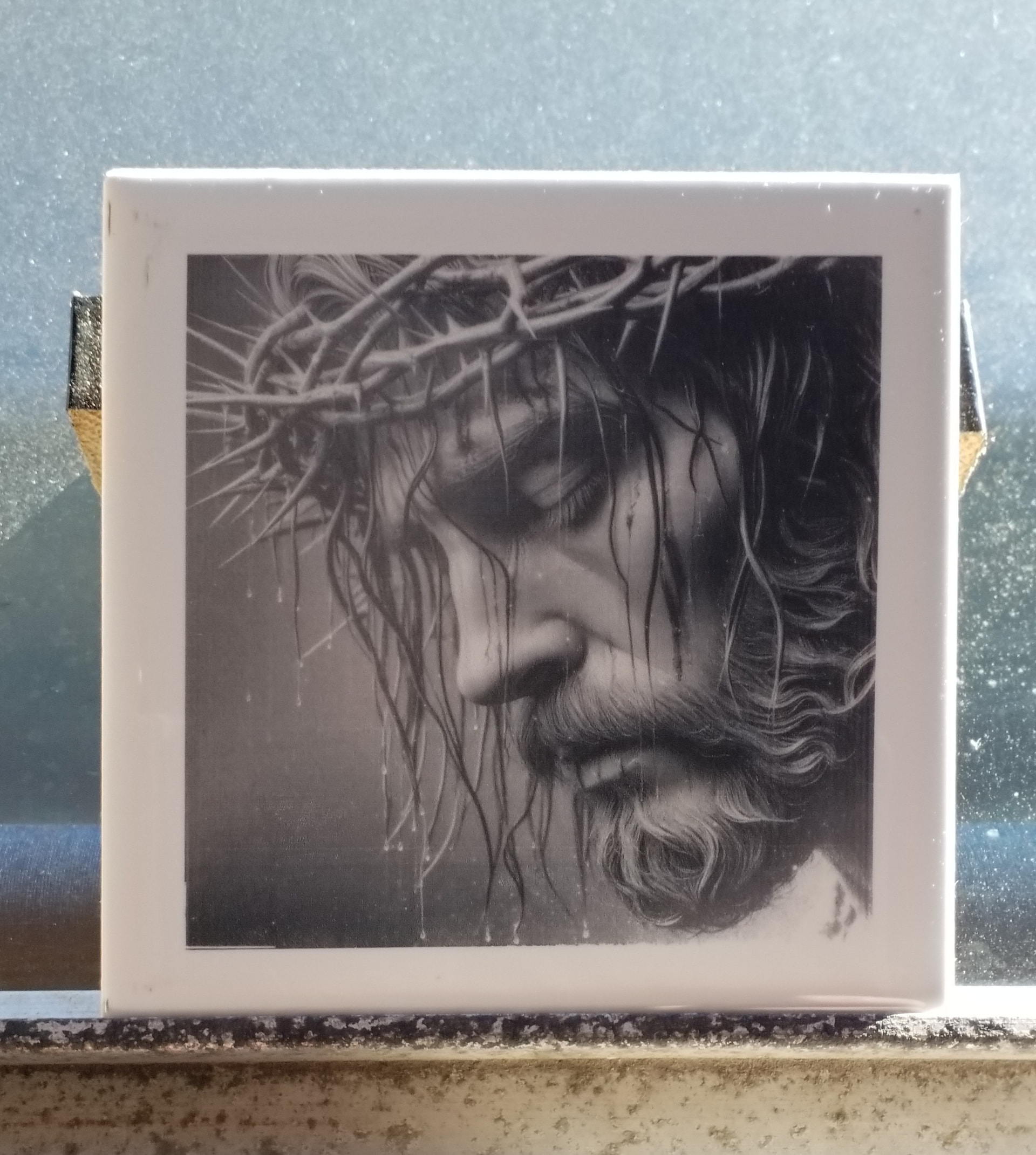

Very nice quality work, is your lense an upgraded type.
I still don’t follow the mixing instructions.
It makes no sense is it 2 cups of TiO2? I doubt that’s it, as that’s a lot of TiO2.

I work with a Ortur laser master 3 and a Opt lasers XT50 Laser head 45 micron on it for me the perfect combination.
TiO₂ + wood glue + water creates a thin white layer on the ceramic tile.
When the laser hits it, the glue burns away, and the TiO₂ reacts with the glaze, turning dark/black.
This gives you much higher contrast than engraving on a bare tile.
- TiO₂ layer — makes the black reaction
- Wood glue — keeps the mix in place
- Water — makes it spreadable
Maybe this will help you to understand this is how I apply it to my ceramic tile the mix.

I understand how it works and how to apply the coating. The problem isn’t applying it, it’s recreating your formula.
I am clueless as to what you mean by

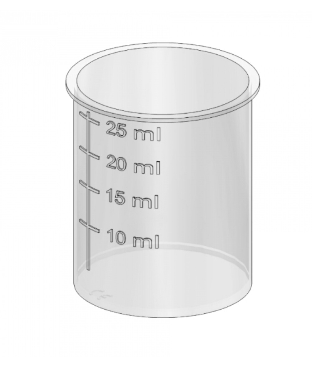

Just a 25 ml little cups and that is the measure unit to take two times one cup totally 50 ml of the Tio2 powder.
The High resolution triplet lens is very nice, and the laser focus is quite adaptable to different kinds of scale.
I thought it was a ristreto-espresso cup you were using for the Tio2 mesure!!
Well done on your choice of equipment and the results your achieving, Do you ever do any camera photo images.
If a “cup” is one of those little things you get in a hospital that holds about a fluid ounce, then “3 cups of 25 ml water” means 75 ml.
So 4 fl oz of mixed glop, more or less.
OK I follow you now.. thanks.

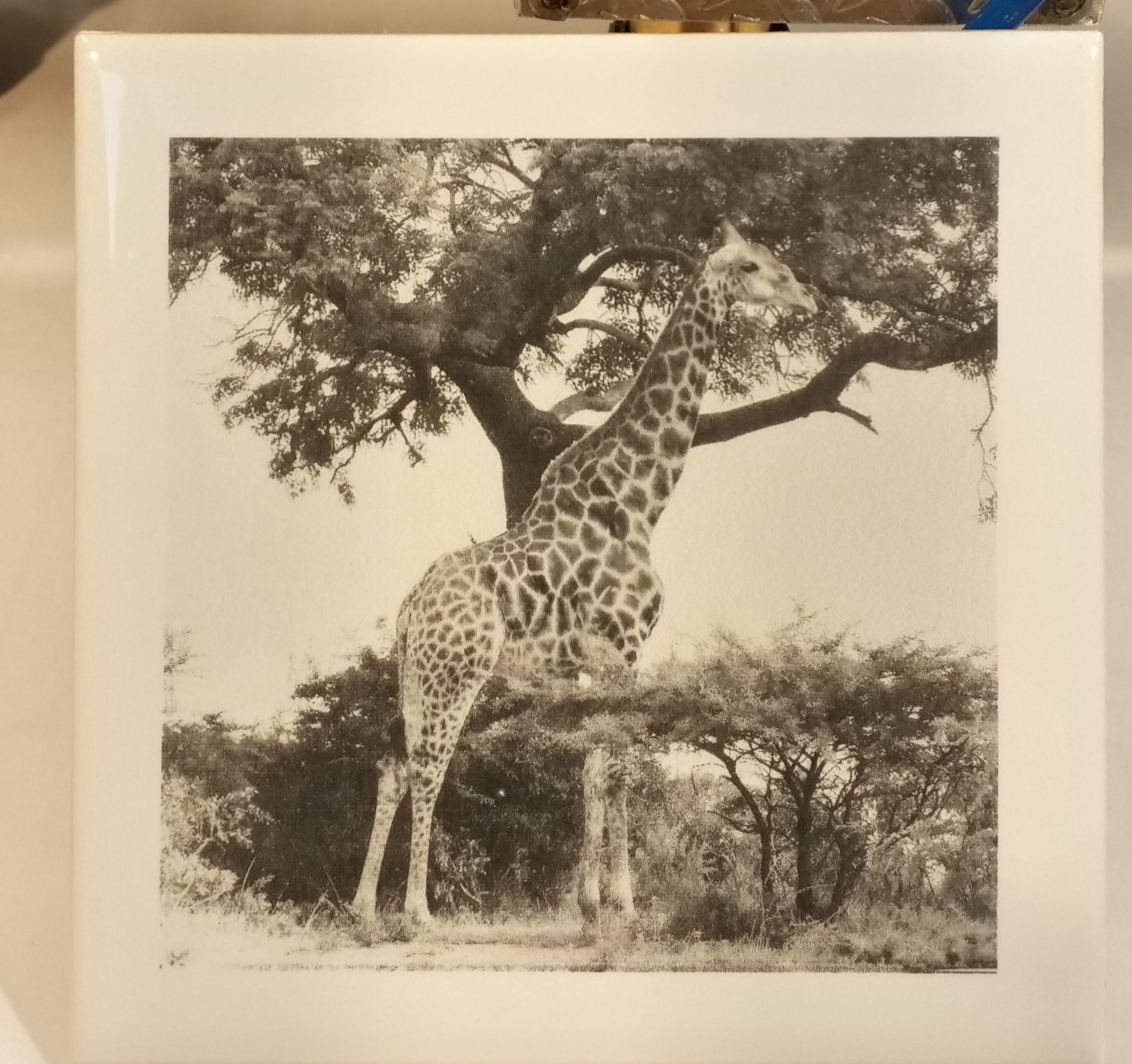

Yes this is a image from a photo I made back in 2017 on safari in South Africa.
A tile 10x10 cm tile image was 85x85 mm 423 dpi
That’s quite nice, I actually meant to ask if you had lasered camera photographs and if you had processed any using ‘DithX’.
I would like to practice the lasered camera photographs more than downloaded images but I would like to see how Ai could assist in the type of images that are beyond the cameras capabilities and a bit quicker than photo images manipulation software.
Do you think that such as DithX would be helpful in that respect.
