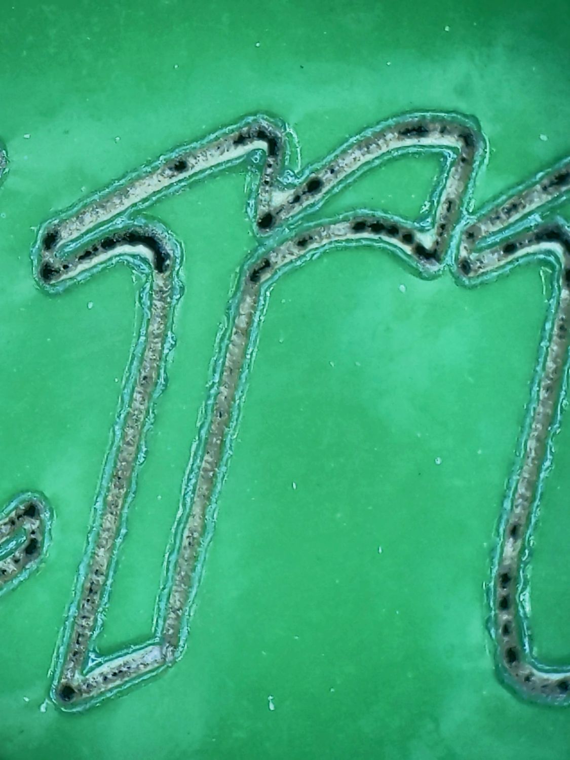

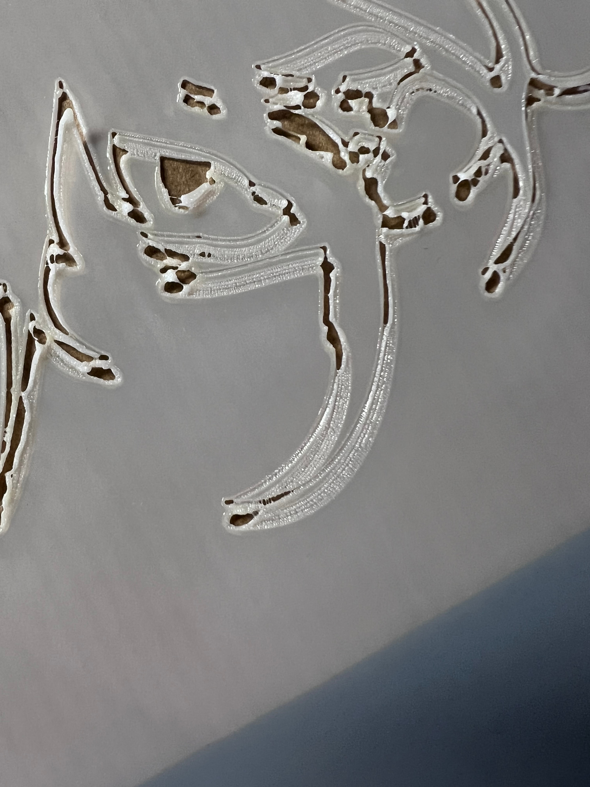

Assuming the machine has a Ruida controller, Dot Mode may produce a series of fine perforations that come Close Enough™ to a continuous cut:
Dot Mode kiss-cut polyurethane film to leave the paper backing (mostly) intact:
It produces a nice trench in sheet of PETG (similar-ish to Mylar = PET):
Producing a complete cut, rather than a trench, will require some tweaking, but it seems feasible.
