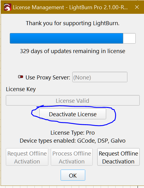

You have to deactivate your License to run in trial full working mode and upgrade after you do your tests.

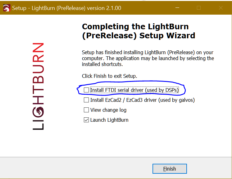

Have you installed the FTDI drivers?

Reinstall Lightburn at the end check to install the FTDI drivers.
