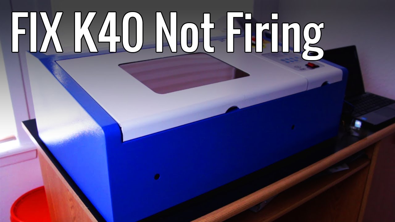

I use Lightburn, and was in the middle of a small engraving yesterday when my machine suddenly just stopped. The head stopped moving and the beam stopped firing.
The water is fine. If I press the test button, it fires just fine. The safety switches (the one activated by the tray, and the one activated by the door) are all engaging correctly. But it won’t engrave at all. I’ve turned it off and closed out Lightburn multiple times, and when I try again, it stays the same. The software and machine are communicating fine.
Is there some kind of reset to fix this display that says “laser signal: off”? I’m at my wits’ end on this, and have tried everything I can think of. I emailed support at Omtech yesterday evening, but haven’t heard back. If I ever will. Anyone with ideas where to go from here?

It looks like GRBL is happy, so the issue is entirely within your K40+ machine. Google pulled up a Lightburn posting…
A “Laser Signal Off” or “Water Protect Off” error on a K40+ (usually an OMTech or similar machine) means the laser’s safety interlock has tripped, disabling the beam. It is almost always caused by an interrupted cooling flow, a loose trash tray, or a faulty water sensor.
Pretty sure those two switches are working as they should, because by activating them by hand, it changes the display readout of the water protection on/off. But neither of them seem to affect the display that reads “laser signal: off”.
Water us gushing out of the return tube. That indicates the water is working OK, doesn’t it?
Maybe faulty water sensor then?
Went here to try something about that sensor.
But in the meantime, it started working on its own! OMG! This thing is a fussy little toddler.

Did you try jumping the water protect as he did in the video?
That’s ok for diagnosing, but you need the sensor or one day you’ll lose a tub. Don’t leave it like he left his.
