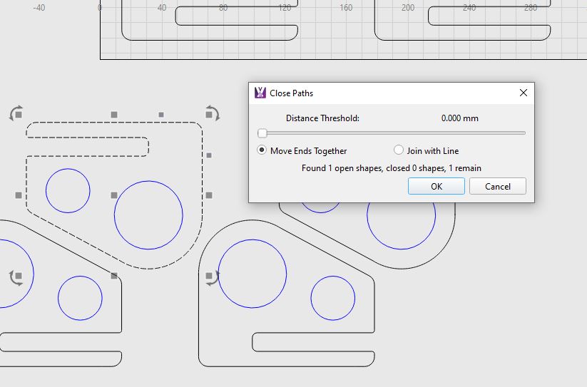

I build some shape using line and circle but even though the shape seem complete, i can’t use the outside option to carve without receiving an error. I don’t know if a tool exist to pinpoint where i can correct the shape. I uploaded the file if someone have time to help me

You can use one of the tools to do it. Just move the slider over until you see it switch from 1 open to 1 closed.
I assigned the circles to a different layer to isolate the outer part, but that is not necessary.
 ![Open Paths](https://forum.lightburnsoftware.com/uploads/default/original/3X/9/2/920b230378a5f8890aed3b470e1970333c173fe1.jpeg)
**UPDATE:** I just double checked and discovered in MillMage you need to click on _Close Path_ first, then click on the close with tolerance one.

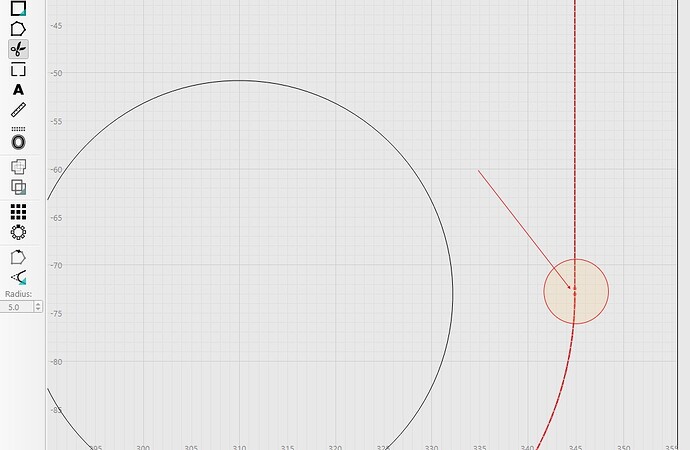

I had this issue a few times and stumbled upon what I believe to be a great fix!!
Using the scissor tool select a path, in my screen shot with your Mage file you will see the two red dots…this indicates overlapping lines/nodes, just scissor the small section out…job done! 😊

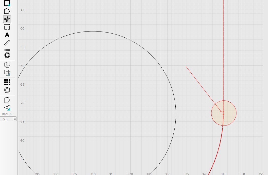

I did notice after the snip there was still a tiny artifact (See screenshot) just select and delete…should be okay then.
Hmm still seems to be an issue even after what I suggested…I’ve had great success with this method…I believe this is the best approach.
 ![Screenshot 2026-10-09 175110](https://forum.lightburnsoftware.com/uploads/default/original/3X/8/6/86930355df1f2b17d2abde3147007716523b0796.jpeg)
UPDATE…You need to ‘Assign’ path again…worked fine for me after 😉

Thank you all for your help. With the close path with tolerance i was able to close the shape. But I keep all the solutions for next time i have that kind of problem.
