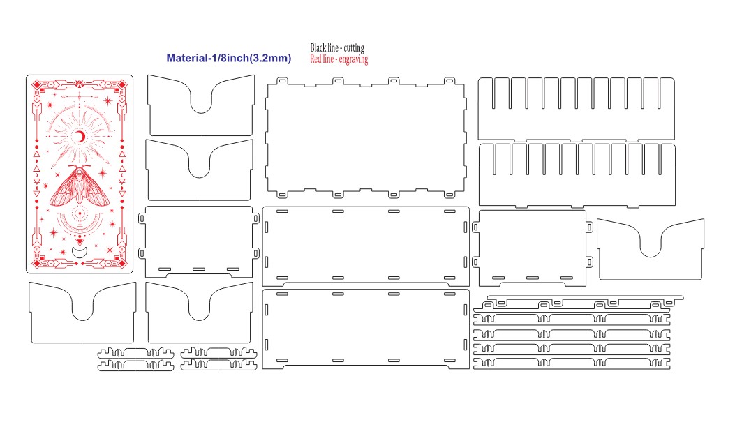

Need to take one large project and break it down to fit smaller canvas
I have a Mecpow 3XPro running LightBurn on Windows 11. I have downloaded a project to make a box with dividers. When I load the file, it’s too large for the 12x12 wood that it will be using. My question is, is there a way to break up the project so that the pieces can go on the wood? I reckon it will take about 8 pieces to do the entire project. I hope this makes sense. I’m brand new to this an am researching but don’t see this particular issue.Thank you in advance.
This may be what you are looking for.
Print and Cut - LightBurn Documentation
Do you mean a single part is too big for the workspace? Or all parts together? If the single parts fit, just select “cut selected graphics only” and then laser them one by one or as many as fit to your sheet.
When I open the file, there are many pieces to it and it is bigger than the 12x12 pieces of wood I want to put them on. How do I select and move them so they can fit on to the 12x12 wood? Attached is a pix of the file I want to use.
First do a copy and move aside as a backup.
On the working copy Select objects then Ungroup.
After select the pieces you want and select “Cut Selected Graphics only” in LightBurn laser window.
