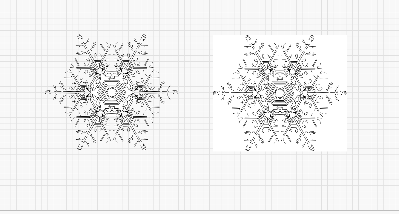

Suddenly, the negative space in my graphics, where the white areas were deleted, wants to engrave black. Below are the very same graphic elements shown above, in a screen shot from LightBurn’s preview.
I tried running the graphic on my laser (K40 with C3D LaserBoard) to see whether the problem was just in preview, but it ran just as pictured in the preview.
I changed no settings. Screenshots of my line and image settings are below.
I was able to establish that the problem is not file corruption. I uploaded two different versions of the same graphic: one with white space deleted as per my customary practice, the other with the white space intact.
Then, I previewed them. This screenshot of the preview shows that it is the negative space within the included graphic that is the issue; LightBurn has begun interpreting it as black, since the upgrade. Smaller contained areas within the left-hand graphic where I never bothered deleting white space show up fine within it.

If you are convinced that your problem is related to the last update and it is critical to your production, it is probably best to go back to your last working LightbBurn version.
There will always be some minor issues with a version change, therefore it is important to have a working backup and the latest working version of the program itself to avoid dangerous situations. ( you can also find an older version on LightBurn’s Homepage.)
Thank you, thank you, and thank you! I never imagined it would be possible to “regress” my version, let alone that it would be easy… but it was a snap. Your advice was spot-on. And yes, the problem I experienced totally arises from the revision; below is a new screenshot of the “white removed” and “white left in” versions of my snowflake graphic in LightBurn preview, after having re-installed the prior version. No problem at all!

I suspect this is fixed, but I can verify it if you can email that file to support@lightburnsoftware.com
We had an issue related to transparency / cropping / and the new rasterization engine changes to support these. Already fixed for the 0.9.18 patch release, but I’d like to verify if I could.
Thanks for getting back to me. I just emailed the file to you.
The 0.9.18 update is out already - you can try it yourself now.
You can now try this for yourself.
Verified fixed.
